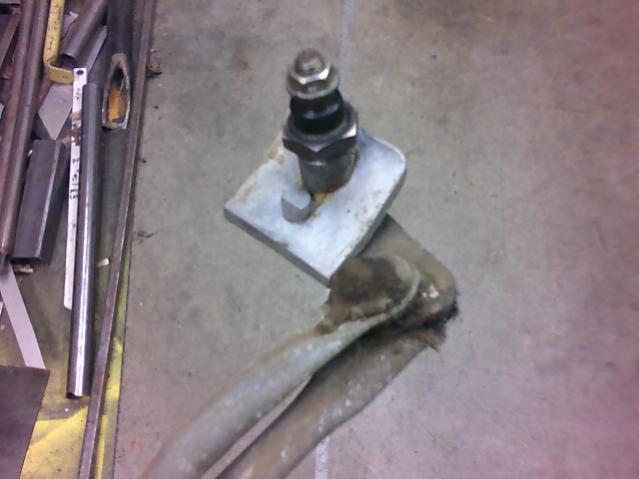

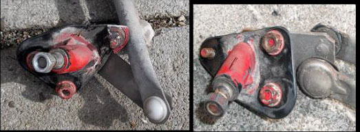

There is a difference between the First and Second generation wiper arm drive assembles, they are NOT interchangeable between generations.
First generation uses a single nut to hold the pivot arm to the cowling over the pivot it's self.
Where as the second generation uses 3 bolts to attach it to the body.
Second
Generation
Credit given to BradMPH for the Second Gen Pictures.
