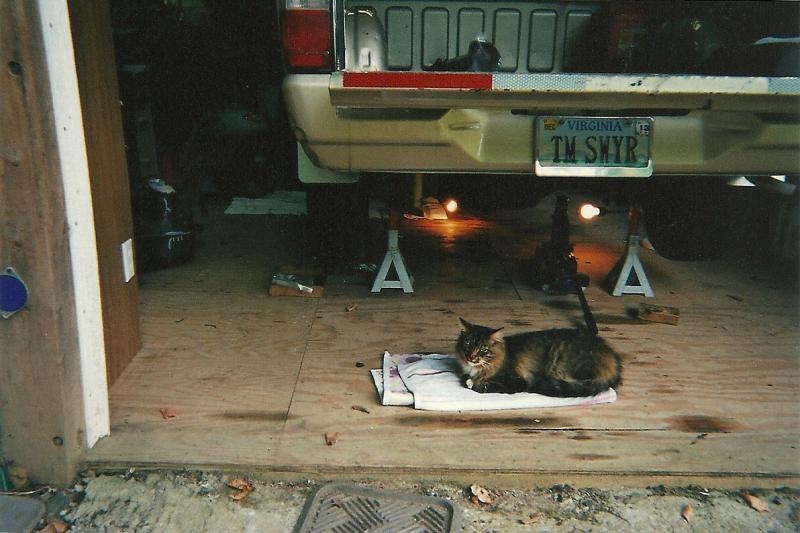

    . Putting the truck up on jacks:
    . dropped the drive shaft and transmission. "Preventitive maintenance" of replacing u-joints might have been a mistake: I get some 55MPH vibration.
    . Replaced the throw out bearing only to find the one in it was fairly new. This DID allow me to inspect the clutch, and also "get my feet wet" in doing deeper mechanical work...something I had not done for many years (I had no place to do it). Drained and replaced trans and differential oil.
    . Dropped the fuel tank and addressed the leaking fuel line issue. It was in trying to locate a fuel pump that I began the realization of how hard it is to get parts for these little guys. I'm thinking this is a common D-50 'losing virginity' moment: you either dedicate yourself to these trucks or get rid of them. I'm keeping mine. After all: it has cup holders.
