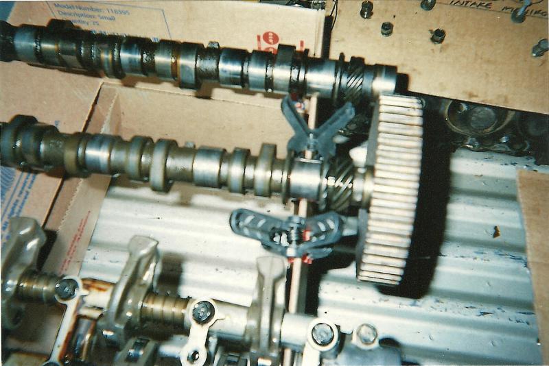

    Here are the cams from the 2.0 and 2.4. The 2.4 has the gear on it.
    Note the lobes on the 2.0 are wider, in order to service the jet valves. I did not check to see if the distributor gears are the same: I see very little reason to interchange parts, other than to switch a 2.0 over to fuel injection. Since my position on this forum is to provide primarily STOCK repairs, information and comparisons, the modification details need to be addressed by the foprum's experts. For the sake of information, I WILL compare the distributors to see if they can be interchanged. EDIT: Of course they aren't: the 2.0 is carborated and the 2.4 is fuel injected. The 2.0. distributor has a vacuum advance, the 2.4 does not.
    I'd ask "WHAT was I thinking?" but thinking had nothing to do with it.
    What would get tricky with switching to fuel injection would be the timing belt aspect: you'd certainly always have to remember to get a 2.0 belt kit.
    So far, my experience is that many pedestrian engine parts will interchange. I also intend to see if the brake calipers and drums are identical or not.

    The difference between a 2.0 4G63, and a 2.4 4G64 is deck height, i.e. the cam gear is further away from the Crank. If you were to use a 2.0 cam on a 2.4 engine you would still need the longer belt of the 2.4. as fro the distributor, the FI unit has thr Crank angle sensor built into the base, you would be missing a very important signal needed for the ECU... Vacuumadvance is the least of your worries.
    1,253
    Thank you, Mike. It's good to have that information.
    In short, the inter-breeding is just not a good idea.
    It will work fine just use the correct combination of parts
