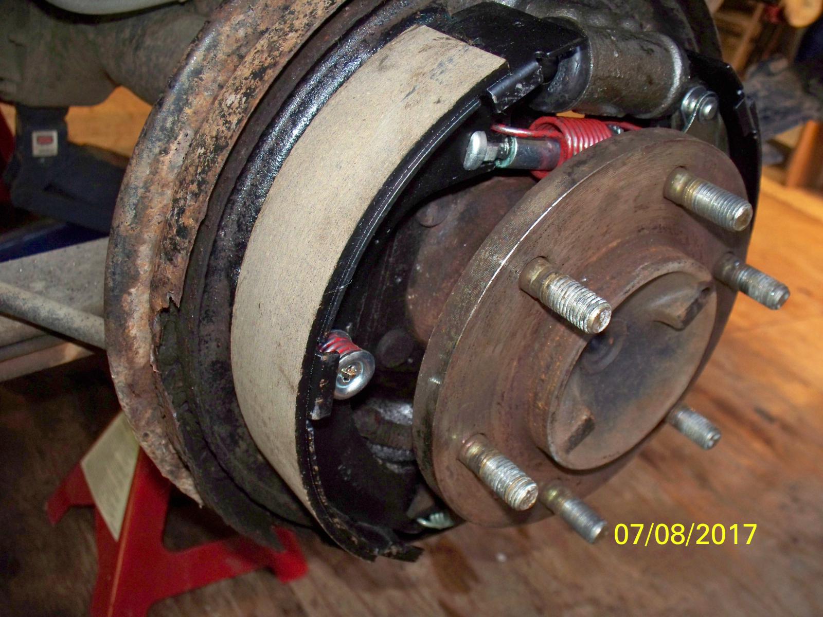

    Rear Brake Overhaul
    It was long overdue, and I wasn't going to get through inspection this year without it. As it turns out, many of the parts were pretty tired, and the shoes, themselves, were very ready for replacing...even though they still had plenty of meat.
    BELOW:
    With the drums off, the passenger's side before dismantling. I'm glad I got all parts and hardware for this project - re-using old springs or adjusters is risky business.

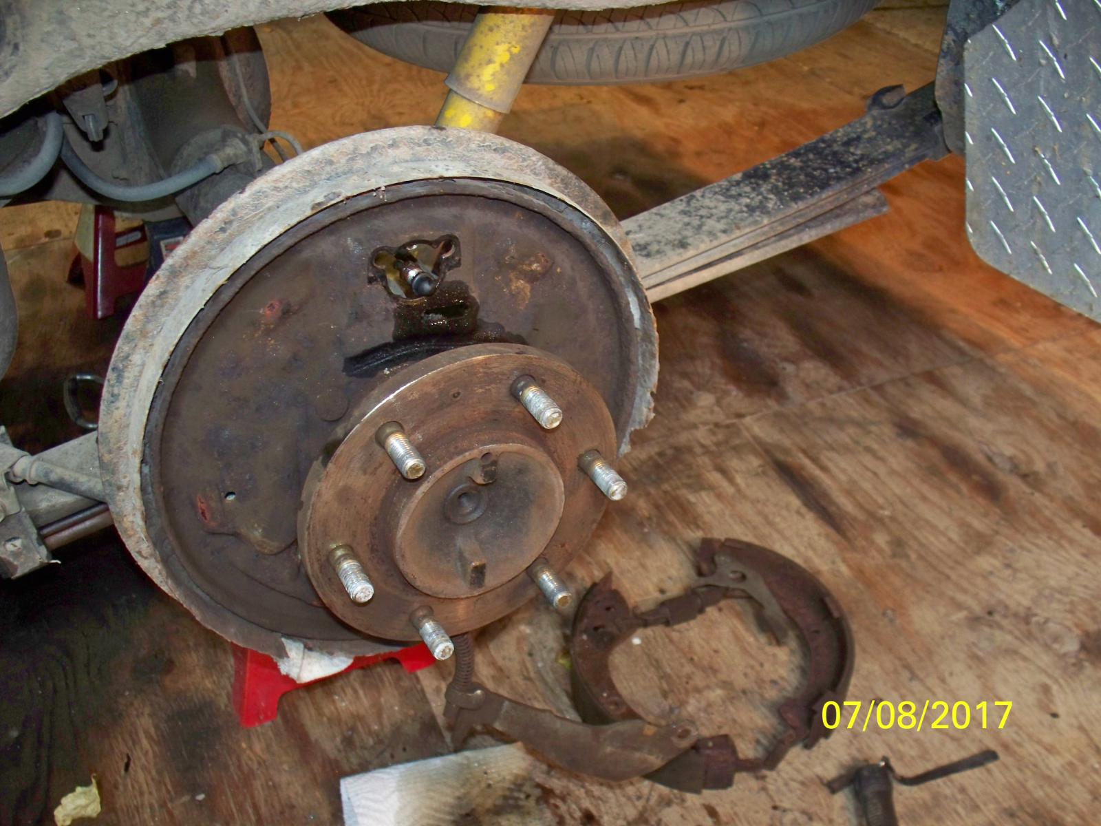

    BELOW:
    All shoes and hardware off (including wheel cylinders) (driver's side), the backing plate ready to be washed. (I capped off the fluid lines before washing to keep water from getting into the system). I used "Awesome" first, rinsed with water (from a garden sprayer) then did a final rinse with brake cleaner spray. Later photos from the right side show the clean-up.

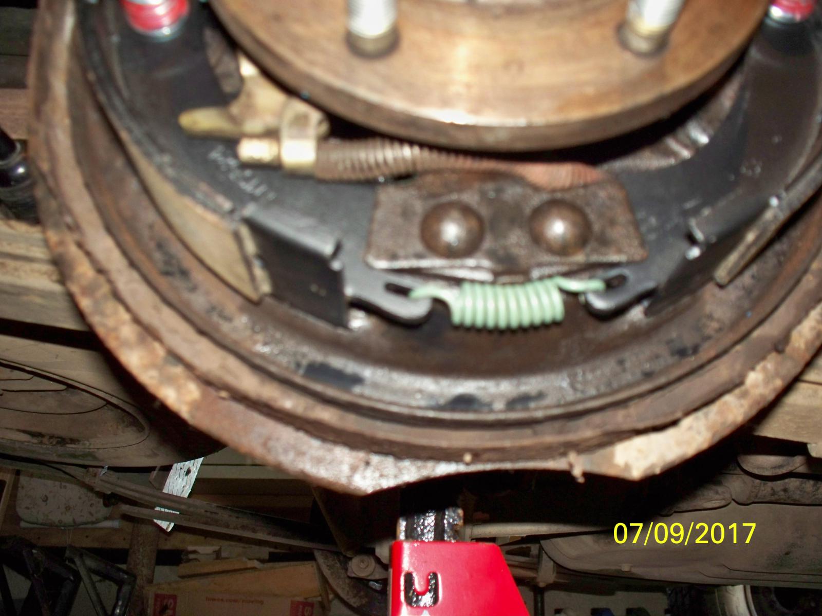

    BELOW:
    Shoes and hardware installed.

    Brake Overhaul - preamble
    First, when you start out on this project, get some J. B. Blaster or Liquid Wrench parts-loosener on the brake fluid line fittings and the wheel cylinder bolts. I did this two days in advance, to give it plenty of time to work. I performed two applications, one just before working on the project.
    Second, do NOT try to get those brake lines off without using a brake wrench...it looks like a box-end with a small gap, to allow the wrench to slip over the brake line, and gives maximum grip on the fitting. This truck uses a 10 MM brake wrench.
    Attempting to use anything but a brake wrench on the line fittings guarantees you will end up trying to use a vise grip, because you WILL strip the fitting heads using a crescent-end wrench. And that means replacing the brake lines. You can buy just the single wrench in many places, or a small set for not much money.
    The Haynes manual will walk you through taking off the old shoes and hardware. You might do well to set them off to the side, in the configuration they were in, for visual reference. (I had the luxury of my parts-truck differential to resource placement).

    100_0131.jpg Driver-side brake line connections.
    Next was to install the wheel cylinder...I opted to fit the brake line FIRST, then mounted the cylinder snugly before tightening the brake line fully. (I removed the driver's side wheel cylinder first, and rebuilt that side before going to the passenger side. During that process it's important to keep an eye on your brake fluid level in the reservoir).
    It's helpful to have a short box to lay the parking brake connection on while attaching it to the brake shoe.
    Note the horse shoe clamp: I neglected to crimp the ends together (I was distracted with photography!), and it fell out once everything was in place. I was able to re-install it, with enough room to crimp it tight, without having to take everything apart.
    Also note some grease on the pivoting points, and the Haynes manual suggests you put a bit of grease on the wheel cylinder shoe contacts. Anywhere there's movement, you want grease *ahem*.
    Next, the self-adjuster goes on. There is another horse shoe clip that comes with the brake hardware set, and there is a groove it fits in. Note the spring placement.
    Please bear with my difficulties in this post: I'm working with a new system, and getting the photos right takes a hit-and-miss effort. In the two photos above, the picture on the right is absent the small blue spring...that spring is visible in the left photo. That little spring holds the self-adjuster arm in place, and there is no mention of it in the Haynes book. Getting that spring in place before securing the brake shoe to the backing plate is important, as there's no way to do it once the shoe is mounted. The photo below may or may not help you with the placement: this is looking on the back-side of the shoe, to show the spring secured to the shoe itself - the flat part of the spring connects to the top of the adjuster arm.
    Those parts secured, the shoe is then swung up into position. There are grooves on the bottom mounting in which the shoe fits into...
    I used small bungee cords to hold the shoe in place, while I got the hold-down spring installed (it requires both hands).
    BELOW- The other shoe is first held in place with the hold-down spring, the bungee cord helps with that. The top spring is then secured to the top of the shoe. Getting that top spring into position is a real effort, keeping everything aligned.

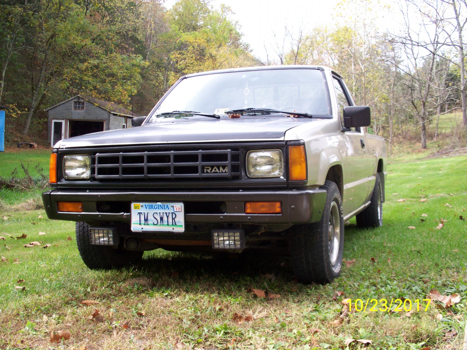

    1,267
    Just a couple of photos of the truck today: it's firewood season, so the camper shell is off. It reminds me of when I first saw the truck, some 4 years ago.
