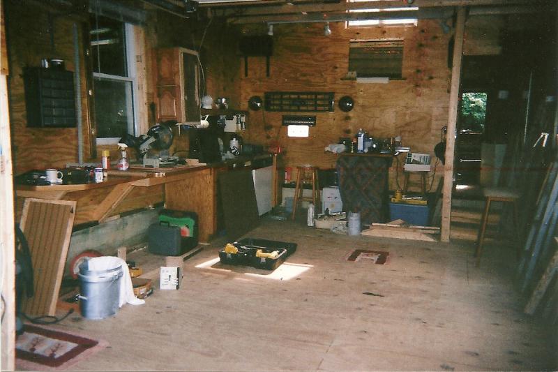

    Please allow me one more construction post before we park that D-50 in here.
    The garage has evolved much since the previous pictures were taken. There is a functioning kitchenette with a stove/refrigerator apartment unit I found at a thrift store many years ago, for $15. Not show in the photo provided are the nice oak overhead cabinets I found and installed. A double stainless steel sink drains outside via a filtration system (I AM, after all, from California: we pioneered environmental awareness), and a rainwater retrieval system is designed (but not working, yet) to provide water for washing hands, gravity-feed with optional pump-assist. The garage has 100 amp service.
    The work bench will hold 400 pounds before it will start questioning my motives. Remember, the walls are real 2x4 oak studs, reinforced and sheer paneled. It was when I decided to replace u-joints in the D-50 that the pristine workbench got its first dents and scratches. The Japanese call such marks "Wabi Sabi", meaning they tell a specific story instead of "decreasing the value of" that which is not perfect because it has been used.
    Because of the way I framed and paneled the garage, it is essentially one huge speaker, because sound transfers nicely out, the bass is carried through the walls and floor like a giant woofer. I have a stereo system than can be heard all through the hills clearly. It is a very good thing I don't drink anymore. The radio/stereo amplifier is built into the wall. Two speakers are screwed tightly to the walls, and two tower speakers sit on the floor when I don't need the space to work.
    The garage serves also as a carpentry workshop. It has a built-in air conditioning unit, and in winter, I heat with a kerosene heater.
    The garage, as it looks today, can be seen in the following photos (future posts) of present-day work with D-50's.
