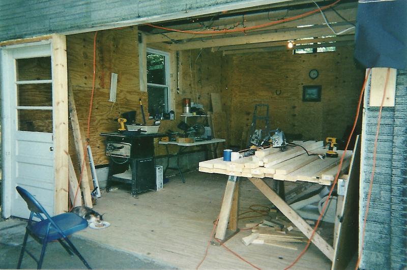

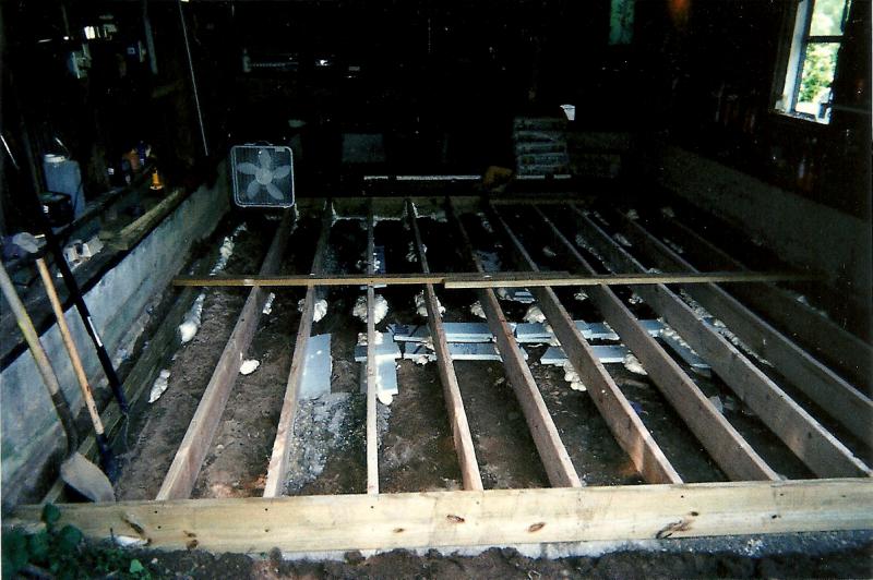

    The garage was abandoned for many years before I got here. It is a solid building: the framing is all oak, constructed in the 1940's. However, it had a dirt floor and no way to enclose the front. I opted to joist the floor up, instead of pouring concrete...it would have been near to impossible to get a concrete truck in that area.
    A combination of "Great Stuff" expanding foam (also called "Architect's Foam") and concrete padding supports the joists, specifically where I knew weight was going to be distributed. The joists are 14" on-center instead of 16". 3/4" plywood was glued-and-screwed to the joists, with foam insulation strips placed between joists (an ultimate recycling project: the insulation strips were cut-offs from some previous project).
    The walls were firred out with 2x4's, insulated and paneled with 1/2" plywood ("shear paneling"), glued with construction adhesive and screwed with drywall screws (2").

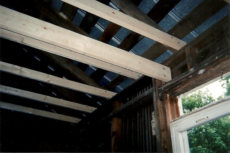

    5 huge 2x8 solid oak rafter beams were originally installed very low, so I removed them and took the rafters up to the wall tops, more than doubling the rafter count, with two 2x8's in the center, where window openings existed, and new windows would go.

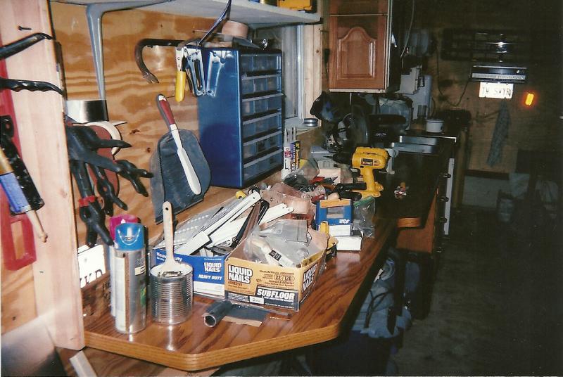

    My workbench is two 3/4" plywood sheets glued-and-screwed together, the top sheet of plywood being oak veneered. 2" heat-fused edge-banding makes the workbench look like a solid piece of oak. Second-hand oak cabinets were found here and there, and soon enough I had the garage I had wanted since my mother kicked the rock band out of hers', 4 decades ago.
    1,271
    Please allow me one more construction post before we park that D-50 in here.

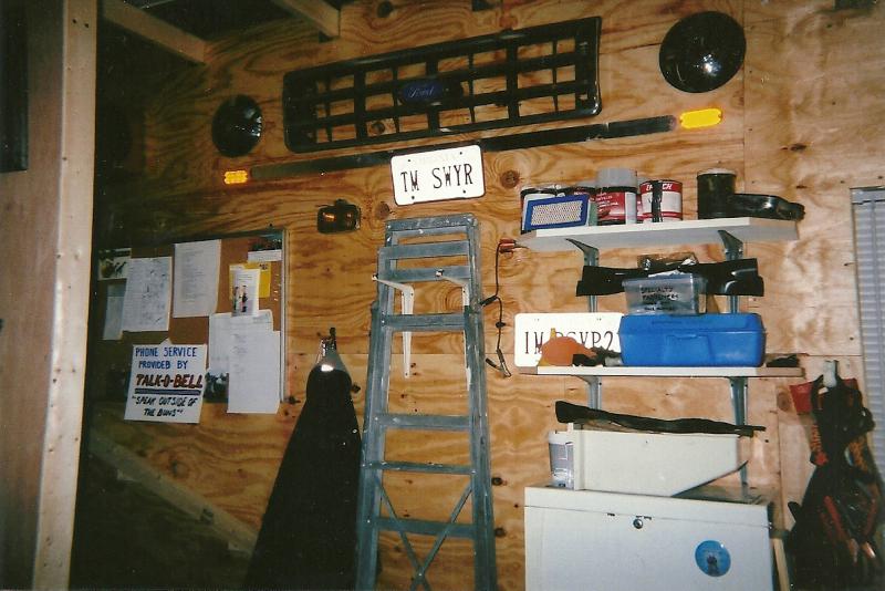

    The garage has evolved much since the previous pictures were taken. There is a functioning kitchenette with a stove/refrigerator apartment unit I found at a thrift store many years ago, for $15. Not show in the photo provided are the nice oak overhead cabinets I found and installed. A double stainless steel sink drains outside via a filtration system (I AM, after all, from California: we pioneered environmental awareness), and a rainwater retrieval system is designed (but not working, yet) to provide water for washing hands, gravity-feed with optional pump-assist. The garage has 100 amp service.
    The work bench will hold 400 pounds before it will start questioning my motives. Remember, the walls are real 2x4 oak studs, reinforced and sheer paneled. It was when I decided to replace u-joints in the D-50 that the pristine workbench got its first dents and scratches. The Japanese call such marks "Wabi Sabi", meaning they tell a specific story instead of "decreasing the value of" that which is not perfect because it has been used.
    Because of the way I framed and paneled the garage, it is essentially one huge speaker, because sound transfers nicely out, the bass is carried through the walls and floor like a giant woofer. I have a stereo system than can be heard all through the hills clearly. It is a very good thing I don't drink anymore. The radio/stereo amplifier is built into the wall. Two speakers are screwed tightly to the walls, and two tower speakers sit on the floor when I don't need the space to work.
    The garage serves also as a carpentry workshop. It has a built-in air conditioning unit, and in winter, I heat with a kerosene heater.
    The garage, as it looks today, can be seen in the following photos (future posts) of present-day work with D-50's.

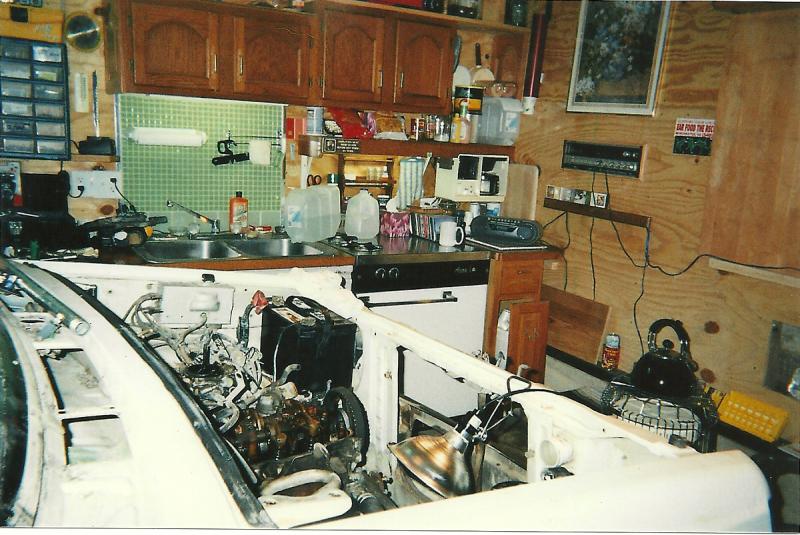

    This photo was taken only a couple days ago, and shows the parts-truck in dismantle-mode. Presently I'm trying to get the drums off the rear end (they're stubborn) [EDIT: they are removed by placing two 9mm bolts in the threaded holes, and tightened, much like a wheel puller] and work with getting some member-requested parts-yanking done. The head comes off tonight...the REAL deciding factor regarding the engine's status (and what I can sell it for) as well as the front bumper. It's up on 4 jacks (beats a full house) and I'm eager to get it out of the garage so I can get into resurrecting the Tin Can.
    Just in front of the truck is the kerosene heater. It's tight quarters, but comfortable. The cats think the parts truck is their personal climber: one likes sleeping on the floorboard, and the other likes sleeping on the roof of the truck.
    Just beyond the kerosene heater, you see a "board" attached to the wall. It is a table top, flipped up. When the garage is not a car port, the table top flips down on top of my table saw, and two bar stools sit on either side. Another great crap catcher.

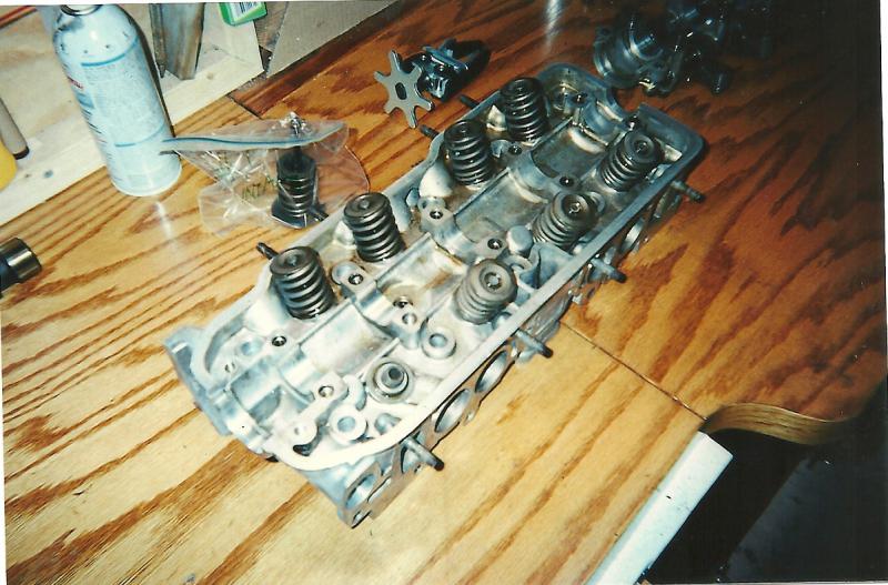

    What I found is you need to cork-screw the tool onto the spirng and turn until it's tight. Then turn the "spiggot" handle until the spring is compressed as much as the tool will allow. I found that by pressing down further, the keepers were easily accessed by needle-nosed pliers. (I placed the cylinder head on the work bench with a spray can cap under the valve. Thank God I didn't have to do this while the head was still on the engine). The illustration below shows the tool I bought, as did millions of cheap bastards across the globe. They DO work, but you need to work with them: they don't do the job FOR you, as the illustration deceptively suggests.
    BECAUSE this tool is such a pain, I suggest doing one valve at a time for the complete job of valve seal replacement: this allows you to leave the spring compressed instead of having to compress it later...plus, you won't scatter and mix up parts.

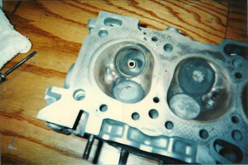

    While the valve was free, I did a number of tests on it to assure it's bent. I removed carbon deposits and put the valve back in it's guide, rotated it and observed any variations and resistances. The variations are very subtle, but there.
    A bent valve is going to play havoc with the vacuum system just as a burned valve would. The "leak test" was enough to convince me to replace the valve: that leak test was on a work bench: in service, the pressure of compression is a helluva lot more than Liquid Wrench seeping through. The "hole" (opportunistic crack) reminds me of my first wife: it both sucks and blows, very rapidly.

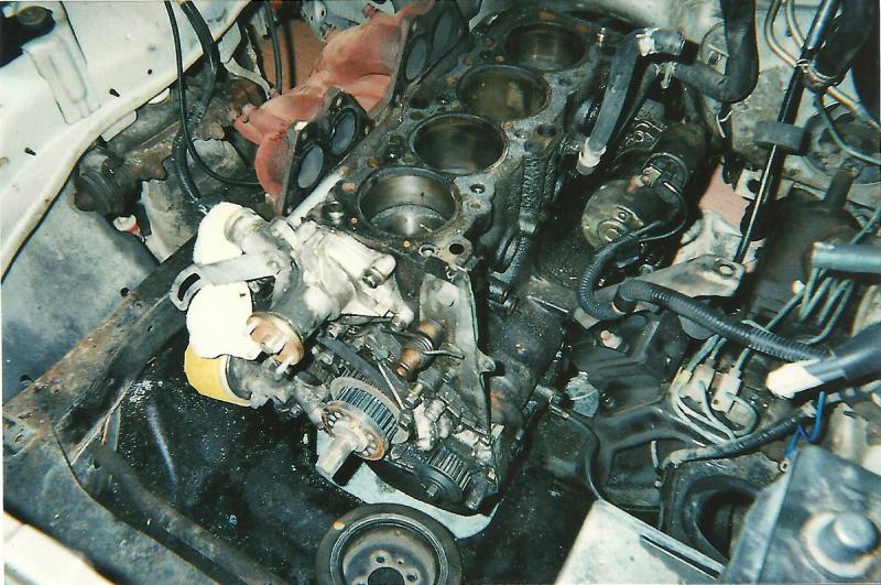

    Analysis From Evidence
    I had suspected that ADDING TOO THICK OF AN OIL caused undue resistance on the camshaft during very cold temperatures, stressing the timing belt and causing it to strip out. Evidence shows this to be only part of the answer.
    The center cam shaft bearing area has a "glob" of aluminum fused into grooves worn from any number of reasons, but suffice it to say that the oil passages in the cam shaft are very small, and thick oil (in cold weather) did not allow proper lubrication. Likely a dry spot on the bearing broke off (metal shavings in the drained oil) and fused itself into the bearing. This caused high and low points on that bearing area. (I say "area" because there are no replaceable bearings, this is the aluminum head and two-bolt hold-down machined to hold the cam shaft in place. RockAuto.com offers a bearing sleeve to repair just such damages, but that's another chapter).
    This high point in the middle of the cam shaft caused even more resistance as the engine turned, making a "teeter~totter" affect. When the cam shaft is laid in the cylinder head craddle, I can move either end up and down due to the "bump" fused into the bearing area.
    Very carefully scrutinizing the 2.0 cam shaft bearing holders, I can swap them to minimise the damage (and avoid ordering expensive parts) leaving me with only one damaged surface on the cylinder head, itself. I intend to use a Dremmel tool to carefully grind down the high point, then polish the surface. The cam shaft isn't damaged excessively.
    This motor has 217,000 miles on it, and although these motors are pretty darned hearty, I only want to buy myself some time so I can locate a rebuildable 2.4 while this one still gives service. It is for this reason I decided not to go to the trouble and expense of replacing the water pump or oil pump: both seem to be in good service. However, I am taking the time to assure oil passages are cleaned, intake manifold and sytems are cleaned, and replacing sensors that affect the cold idle and choke: they hadn't been working since I bought the truck.

    I'm still working on the bench, so the block-in-truck work really hasn't started, yet. I got the 'bearing' ground down and polished pretty nicely, and successfully exchanged the 2-bolt hold down for that bearing area. I'm making sure absolutely ALL oil passages are clean.
    I cleaned up the head about as good as it's going to get, and will start replacing valve seals tomorrow...good use of time while waiting for the replacement valves to arrive. I'll also order new hydrolic lifters from NAPA locally.

    The engine compartment, note cylinder #3
    I HAVE to do a good job: I'm constantly being watched.

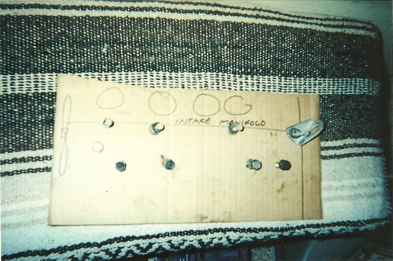

    Securing bolts in the order they go.
    An overhead view of the work bench. Note the small flashlight on the cylinder head: with the overhead lights off, this light reveals the high and low points by casting a shadow. Auto body work is done the same way, as is good drywall mud-work.
    Lots of cleaning to do...and lots of cleaning up getting done.
