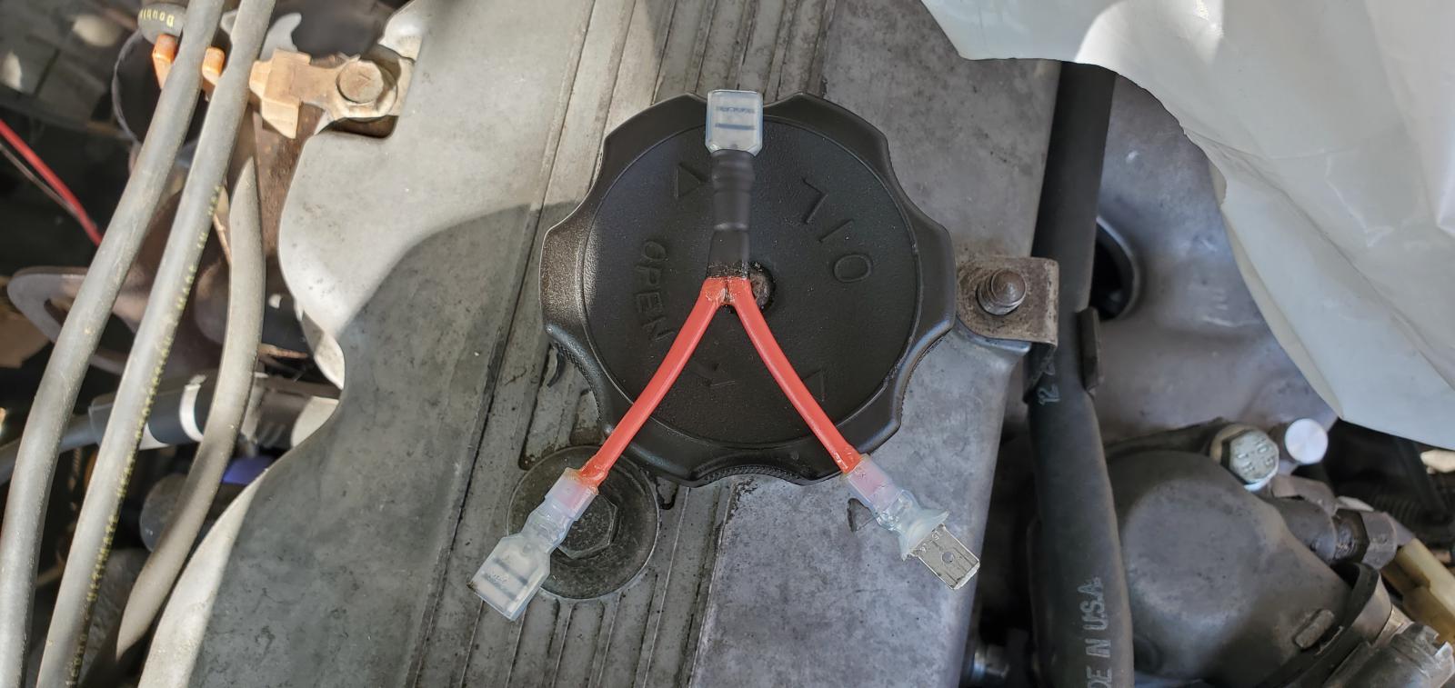

Connect the S(tart) terminal on the oil pressure safety switch to the S terminal on the solenoid.
Auto parts, hardware, or electrical supply stores should have a spade terminal adapter that has 1 female and 2 male spade connectors on it. The female end goes on the S terminal, then the male ends take your stock starter signal wire and the new wire to the safety switch.
(EDIT: These are apparently called "double male" terminals/adapters and come in "chair", "flat tab" and "piggy back" types -- Dorman part# 85412 comes with 2 of each for about $3 at Pep Boys or $2 at O'Reilly. Or, you could find a piggyback crimp-on terminal for your safety-switch wire, which has a female spade connector with an extra male spade forking off of it for your starter signal wire.)
The way these safety switches typically work, there's an internal switch that flips whether the (P)ump terminal is connected to the (S)tart terminal or the (I)gnition terminal. At rest, P is connected to S, then oil pressure flips that to connect P to I instead. This can be handy to know in case the switch ever fails, as you can probably just swap the I wire over to the S terminal to get going again until you can replace the switch.

I don't have the time to go to the auto parts store and get the spade terminal adapter you are talking about, so I just made one. Here is a picture of the one I made:

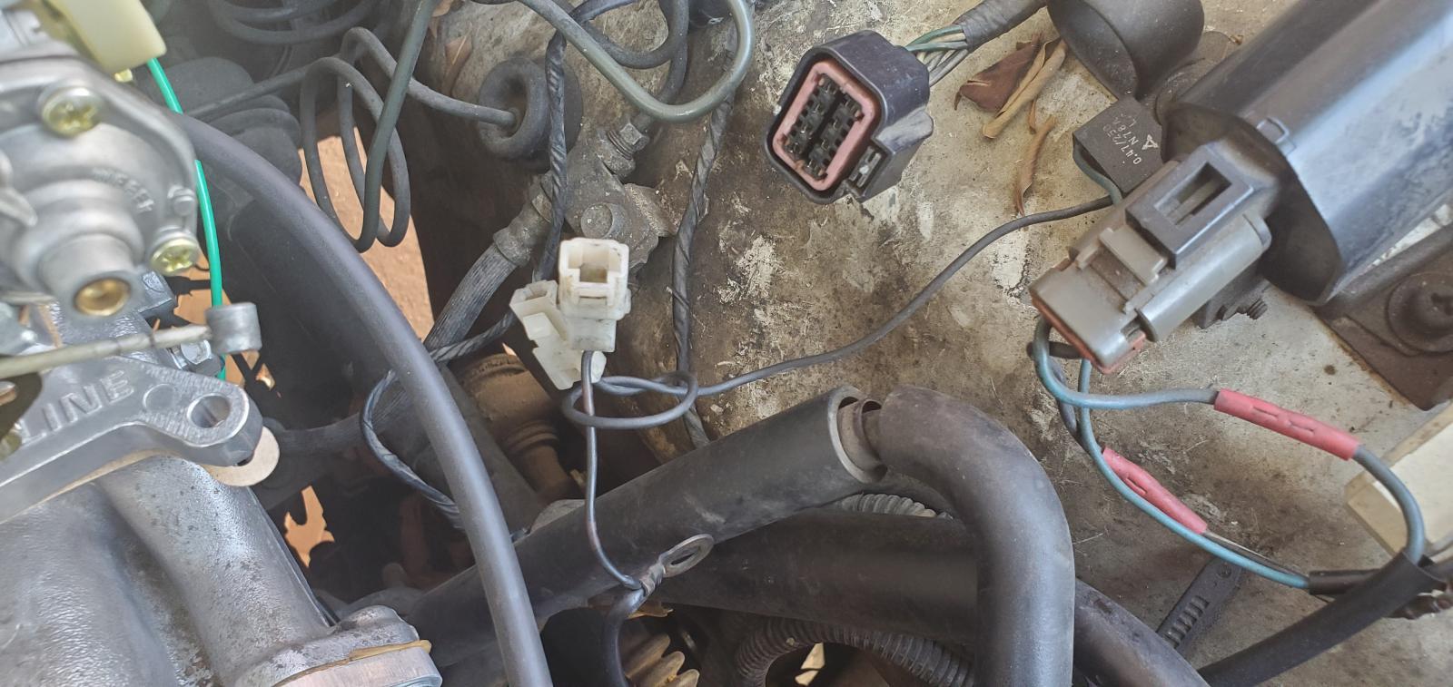

So far, the "P" (Power) terminal is hooked up and "S" (Starter Solenoid) are hooked up. I just need the "I" (Ignition) terminal hooked up. Everyone says to hook it up to the existing fuel cut off solenoid that's hanging around in the truck. Although there is other connections hanging around as well. Here is a picture of all the connections hanging around. Which one do I tap into?
Attachment 23438
Do you remember which one you disconnected from the Mikuni cut off solenoid? Just directly connect to the end of it.
if not on my first gen trace the yellow with red stripe wire that connects to the temp sensor back to the harness. there are two black wires coming out at the same spot. One goes to the starter the other one goes to the Mikuni and now to my oil pressure cut off switch.

If you do not remember which wire you took off the Mikuni ??? How many loose wires do you have? What connectors are on the end? What sort of connector does the Mikuni have on it that might receive one of those wire connectors? Maybe Pennyman1 or Geezer101 will stop by.
I see two wires. The temp sensor wire on mine is in front of the intake manifold before the distributor.
Anyway, if you just have those two wires with different connectors on them go look at the Mikuni you removed for where one of them might fit.
For power to the I terminal, you can see if any of those loose connectors have ~12V power when the key is on and not when it's off. If your Mikuni setup is like my '87, the fuel cutoff solenoid terminals are bundled into that multi-terminal connector block. You may wish to just cannibalize the old carb side of that connector, cut the wire pair at the cutoff solenoid, and splice onto that; one of those wires should get 12V switched current, and the other is a ground. You can tell which gizmo is the solenoid when you plug it in and turn the key, you should hear it click.
