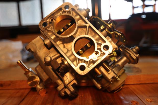

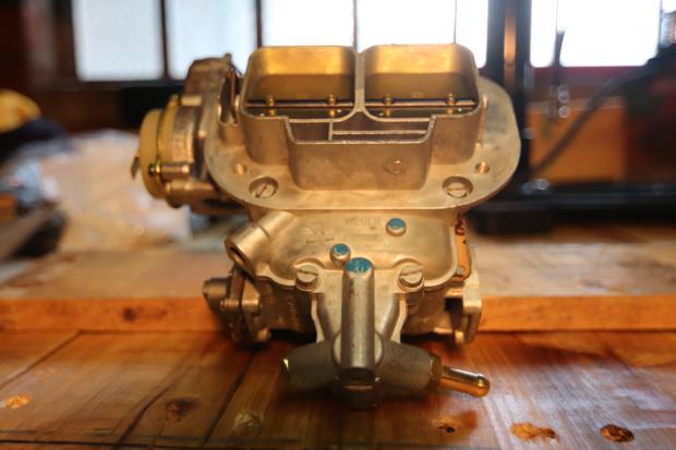

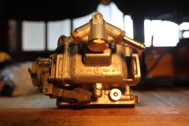

    I purchased the Weber 32/26 DGEV K610 carburetor from Carbs Unlimited and received it a few days later. Although, the carburetor has DGAV stamped on the base instead of what I believe is supposed to be DGEV. Anyone know why that is? I took multiple pictures of what you will get when you order the Weber 32/36 DGEV K610 carburetor.

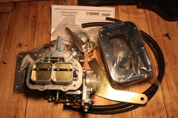

    I received this box that was in another box(inception :
    Overall contents of package:
    Contents laid out on table:

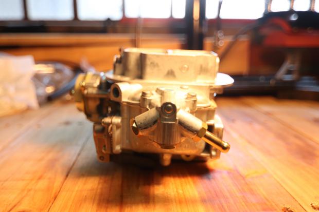

    Pictures taken of the carburetor body:

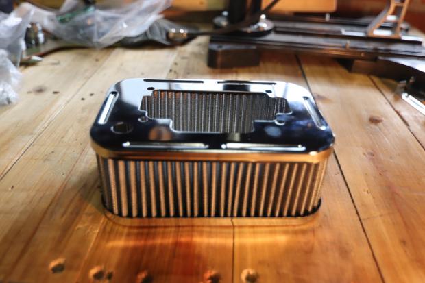

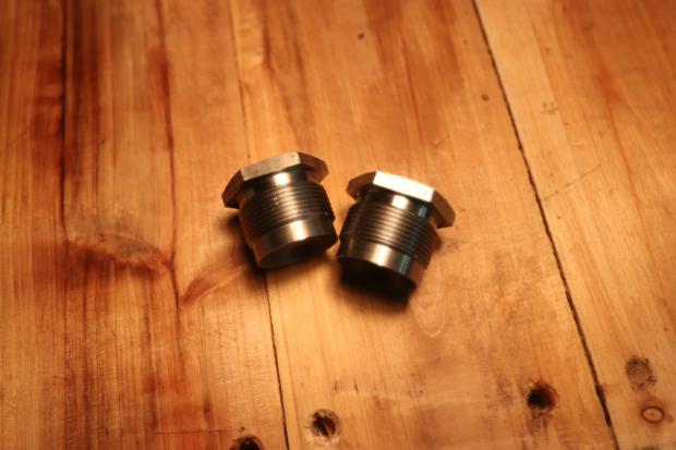

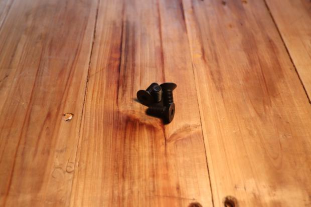

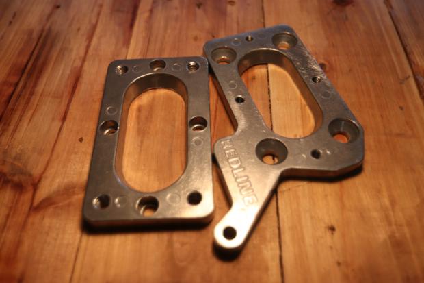

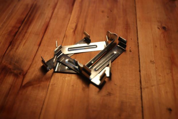

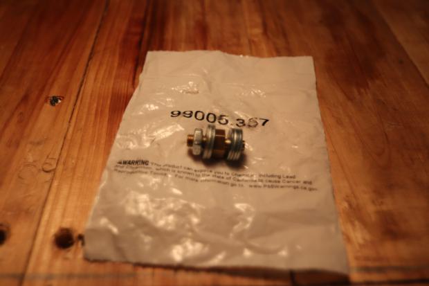

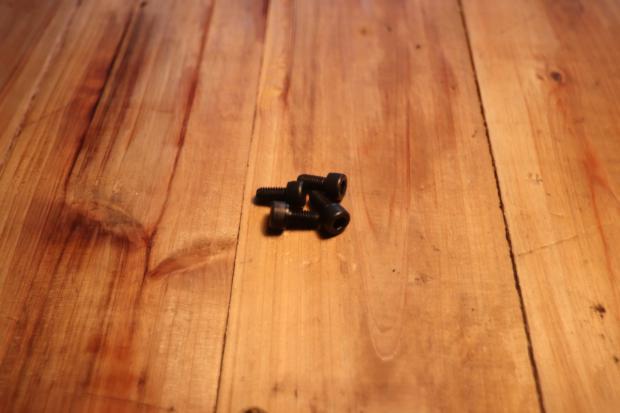

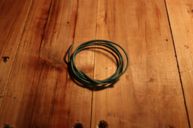

    The following pictures are the components you will receive with the k610 conversion kit. I took a picture of each component to show a closer view.
    IMG_5061.jpg IMG_5063.jpgIMG_5064.jpgIMG_5073.jpgIMG_5089.jpgIMG_5095.jpgIMG_5097.jpgIMG_5099.jpgIMG_5100.jpgIMG_5102.jpgIMG_5103.jpgIMG_5105.jpgIMG_5112.jpgIMG_5115.jpgIMG_5116.jpgIMG_5122.jpgIMG_5125.jpgIMG_5126.jpgIMG_5127.jpgIMG_5128.jpgIMG_5134.jpgIMG_5130.jpgIMG_5132.jpgIMG_5133.jpgIMG_5137.jpg

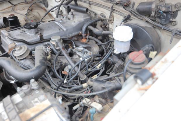

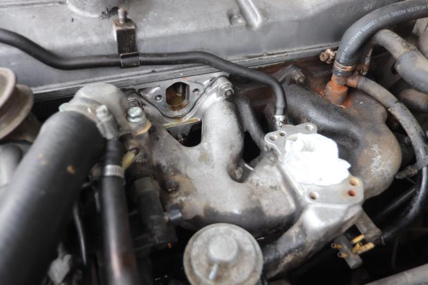

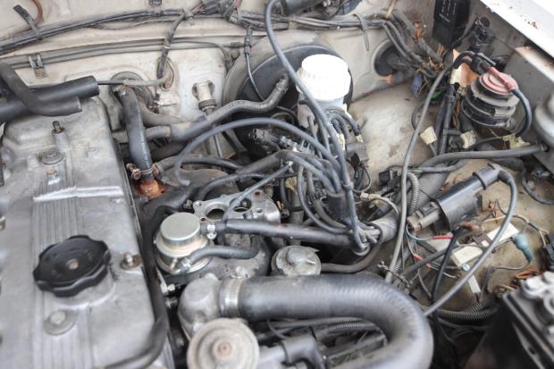

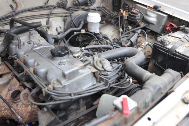

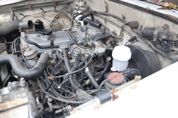

    The first three pictures were taken before the conversion started:

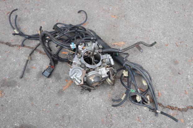

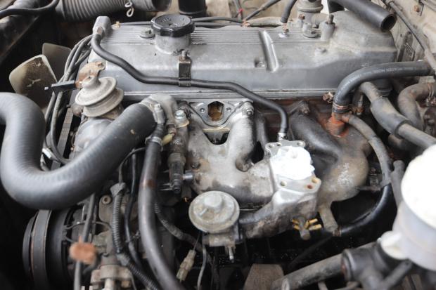

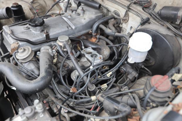

    These next pictures, I started removing...
    IMG_9902.jpgIMG_9903.jpgIMG_9904.jpgIMG_9905.jpgIMG_9906.jpgIMG_9908.jpgIMG_9909.jpgIMG_9912.jpgIMG_9913.jpgIMG_9915.jpgIMG_9916.jpgIMG_9917.jpgIMG_9918.jpgIMG_9919.jpgIMG_9920.jpgIMG_9925.jpgIMG_9926.jpgIMG_9927.jpgIMG_9928.jpgIMG_9929.jpgIMG_9930.jpg
    Carburetor removed with it's annoying vacuum hoses:

    As for the air cleaner, you can take a stock air cleaner box, cut the centre out of it where it mounted onto the Mikuni and make an adapter plate to suit the top of the Weber. You may need a spacer to lift the air cleaner up from the carb depending on if it fouls on anything. This sounds hard but all you need to really do is make a hole in a piece of cardboard that fits around the intake on the top of the carb (trace the hole from the top gasket in the kit), cut a round hole in the bottom of the air cleaner box, sit it on top of the carb where the mounting studs normally hold it in place, trace the hole onto the cardboard and use the cardboard as the template for your adapter (4mm thick alloy plate would be ok) and make some alignment marks so you don't goof when you put it together. The hardest part of this is making a bracket where the air cleaner cover can bolt down onto it as you won't have the stud like what's on the Mikuni to bolt it down. There is an adapter made for this job off the shelf if I recall.
    Cut the alloy plate and drill some holes through the air cleaner base into the adapter plate. A bead of silicon and some rivets - done! Looks stock and has the cold air charge from the factory ducting (if you lengthen it and direct it out of the engine bay it will add torque)

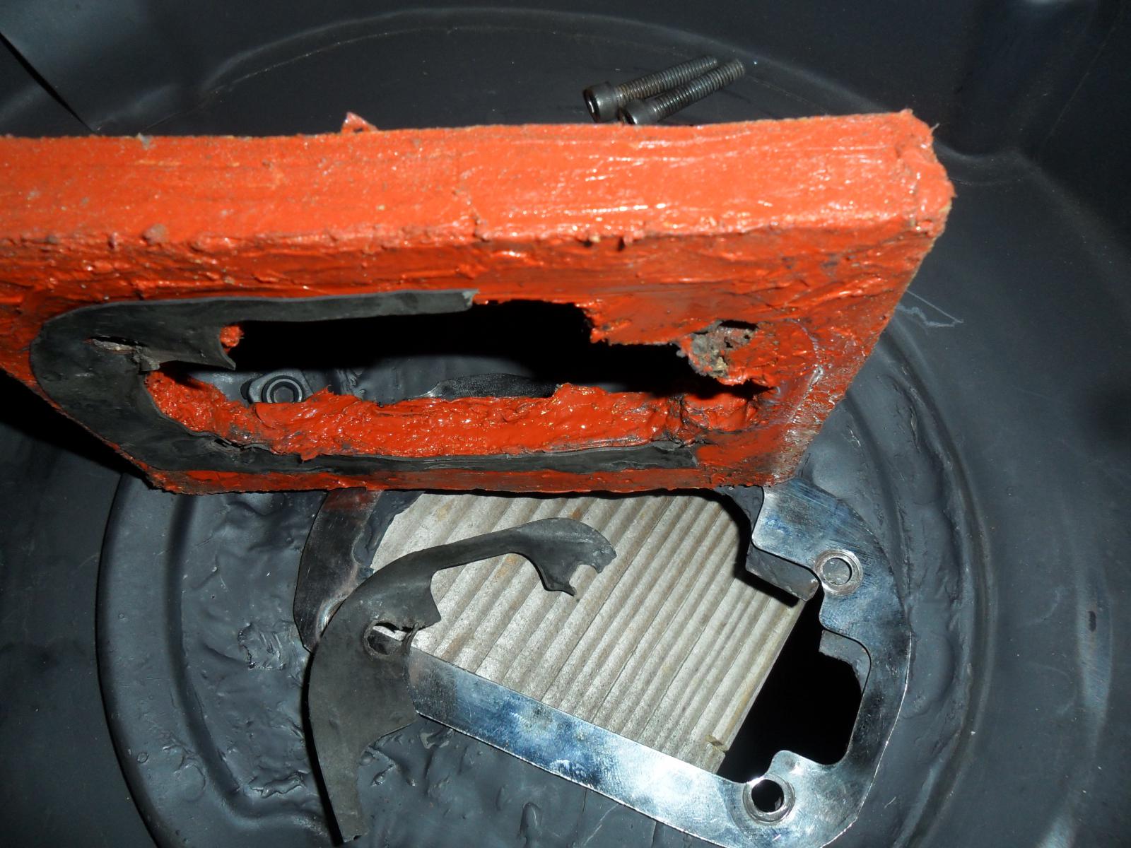

    I did the mod on the OE air cleaner box and posted about it on here. I also posted some pics and comments about putting in a new Weber. IDK if that will help I just signed in to say there is an adapter for the airbox to Weber mount which will save you lots of aggravation. It is not as easy as Geez thinks. The OE hole for the Mikuni is a cone tapered down an inch or so, that you have to make cuts and hammer flat before cutting the hole then you will have to figure out how to make it airtight. I used a bunch of cork to fill the gap where the adapter will go and coated the cork in red gasket sealer. If I'd have known about the adapter that is what I would have done.
    Found a couple adapters https://www.ebay.com/itm/LC-Engineer...MAAOSwQYZWxj6R https://www.ebay.com/itm/WEBER-32-36-DGV-AIR-FILTER-ADAPTER-TO-5-1-4-AIR-CLEANER-WEBER-38-38-NEW/272527062295?hash=item3f73e0f517:g:AIoAAOSwblZZJHk R
    That is the one to use - also listed for a Toyota air cleaner...
    10-29-2014
    1,286
    Earth, the Solar System
    FF just crashed while I was uploading pics!

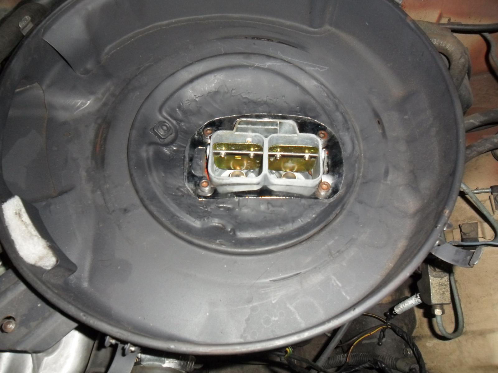

    OK I put in a new spacer so I took pics while I had it off. You can see I used the base plate from that joke square air cleaner as a washer. I had to get longer hex bolts. You can see the cork I coated in gasket sealer. I got some squares of cork at Joanne Fabrics. It was one package. I also used JB Weld to seal the cuts I had to make to get it to hammer flat. Ditto the hole in the top for the post.
    Oh yea I had to put a hex bolt into that hole on the left in pic 1. Sorry do not remember the size.

    And for one of the great mysteries you made an inquiry about - the DGAV vs DGEV. The 'A' refers to 'aqua' (water choke) and the 'E' is electric. This particular carb is one of the times where the part designation makes sense - 'D' dual, 'G' gradual/progressive throttle, 'E/A' choke designation electric/water but the V is a bit ambiguous (might be throttle linkage orientation as there are a few different throttle layouts)
