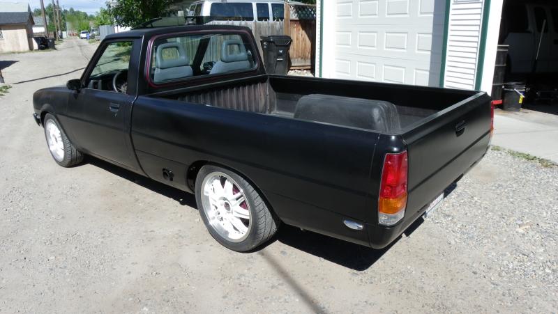

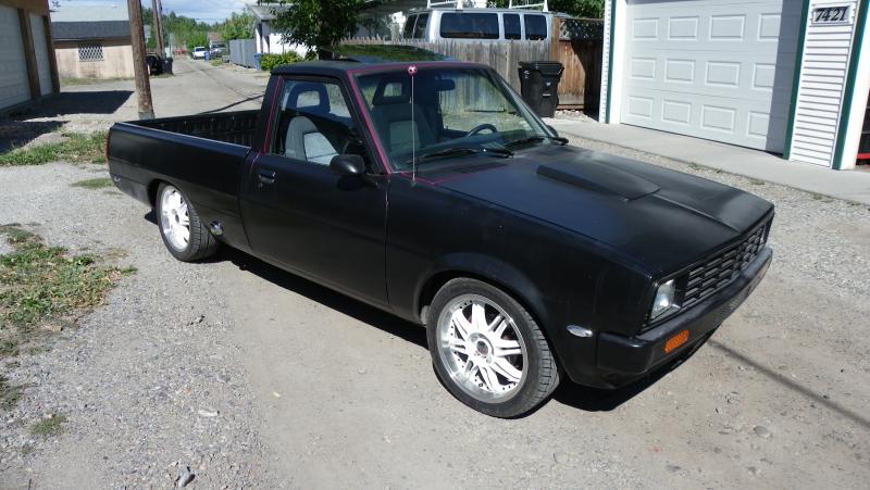

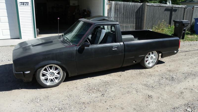

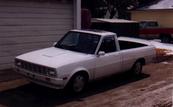

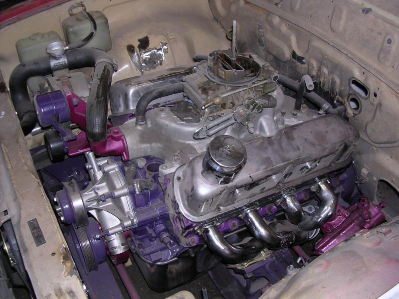

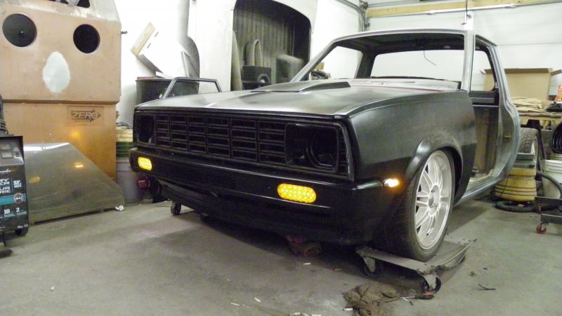

    I picked up this truck 17 years ago for $150 figuring I could rebuild the engine and have a parts truck for my shop.The rebuild was stupid money at the time so as a joke I grabbed an 85 302 out of a T-bird that was totaled. Got the thing on the road and had a blast kicking "ricers" butts with it. Then 11 years ago I was hit by a drunk driver who merged into my lane taking out the passenger front end (I wasn't hurt at all just PISSED)

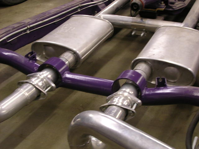

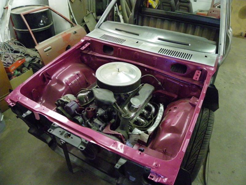

    A few months later I found a rust free 83 cab and bought it for $39.99 from a local junk yard.Well next thing you know the frame is stripped, air ride put in, 4 link, 7.5 inch 3.45posi (Ranger axle) gas tank relocated,full mandrel bent 2.5 inch duel exhaust,AOD with 2400 stall and a stage 2 shift kit,modified BBK Mustang headers, and 5 lug front conversion. there the truck sat for a few years.
    Then I was lucky and found a set of 66 289 4v HO heads and its engine upgrade time.Put in a new cam (Ford A312) windage tray,anti-pump up lifters,roller rockers and a few things to let the engine run to 8000 rpm.Again the truck sat for a few more years
    in the last 6months I have been working on it again and with luck will be on the street again in 3-4 months
    Photobucket.com/fordubishi you can check out all the work so far to date. I update it every few days with new pic's
    Original build
    New Cab and engine mods
    New duel exhaust
    Body back on frame for the last time
    Getting there
    Back Together
    It's a driver again
    Bags Deflated
