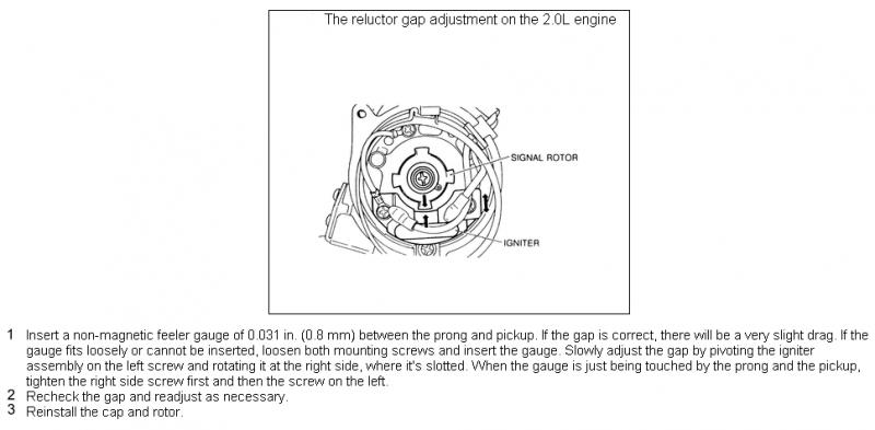

Engine:Distributor Reluctor Gap Adjustment -2.0L & 2.6L
This is a diagram showing how to adjust the pickup to prong gap in the electronic distributor of the 2.0L engine

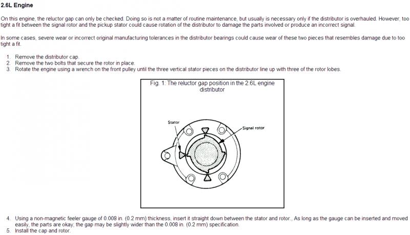

This is a diagram showing how to adjust the pickup to prong gap in the electronic distributor of the 2.6L engine
