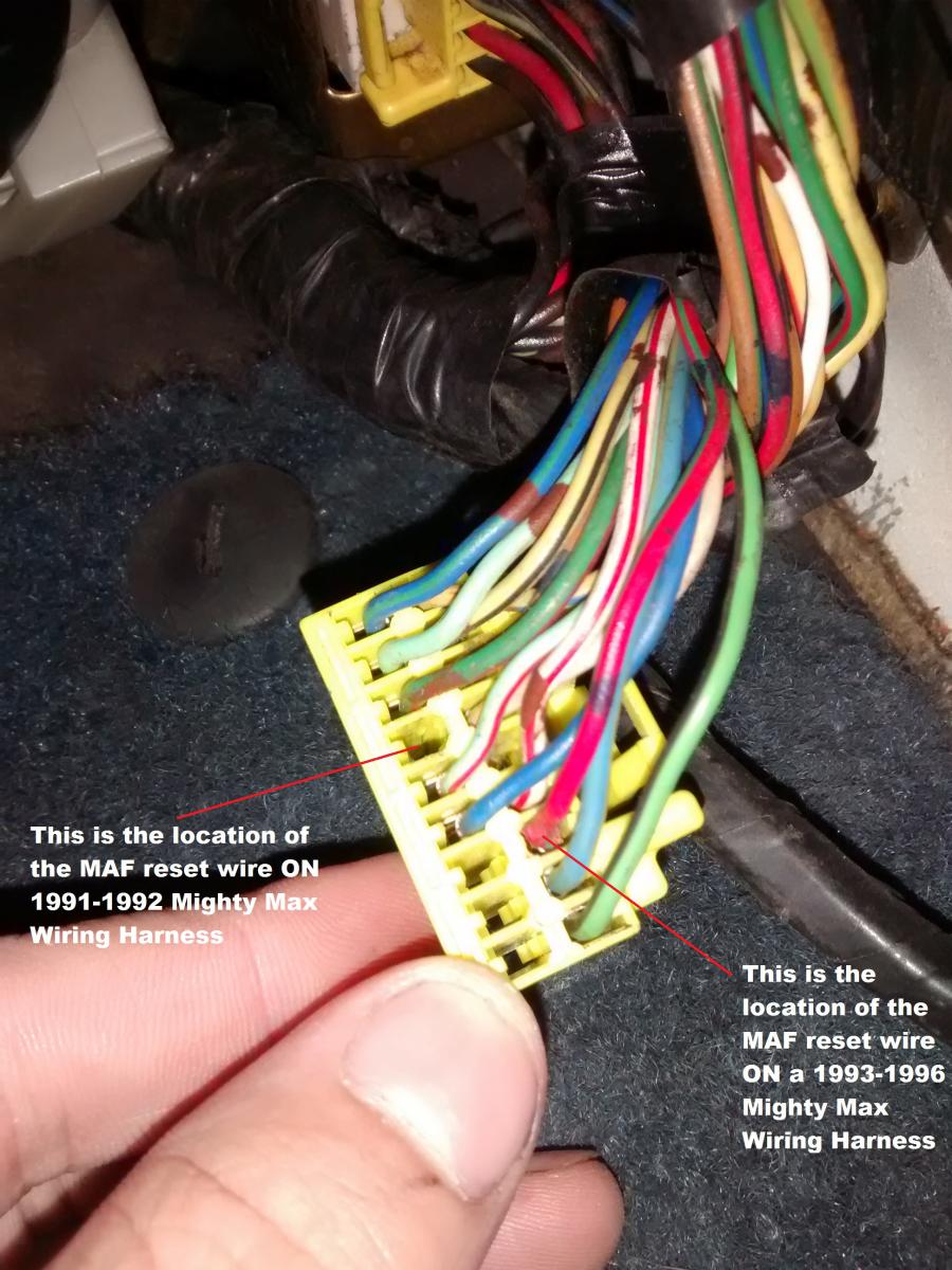

If you have different connectors than the ones shown going into your ecm than its a 1994-1996 cal emission harness. these are rar to find so you dont need to worry.
so if you have a 1993-1996 harness like the one shown and you want to use a 1991-1992 ecm just move that wire over. this is on the center plug going into the ecm btw.

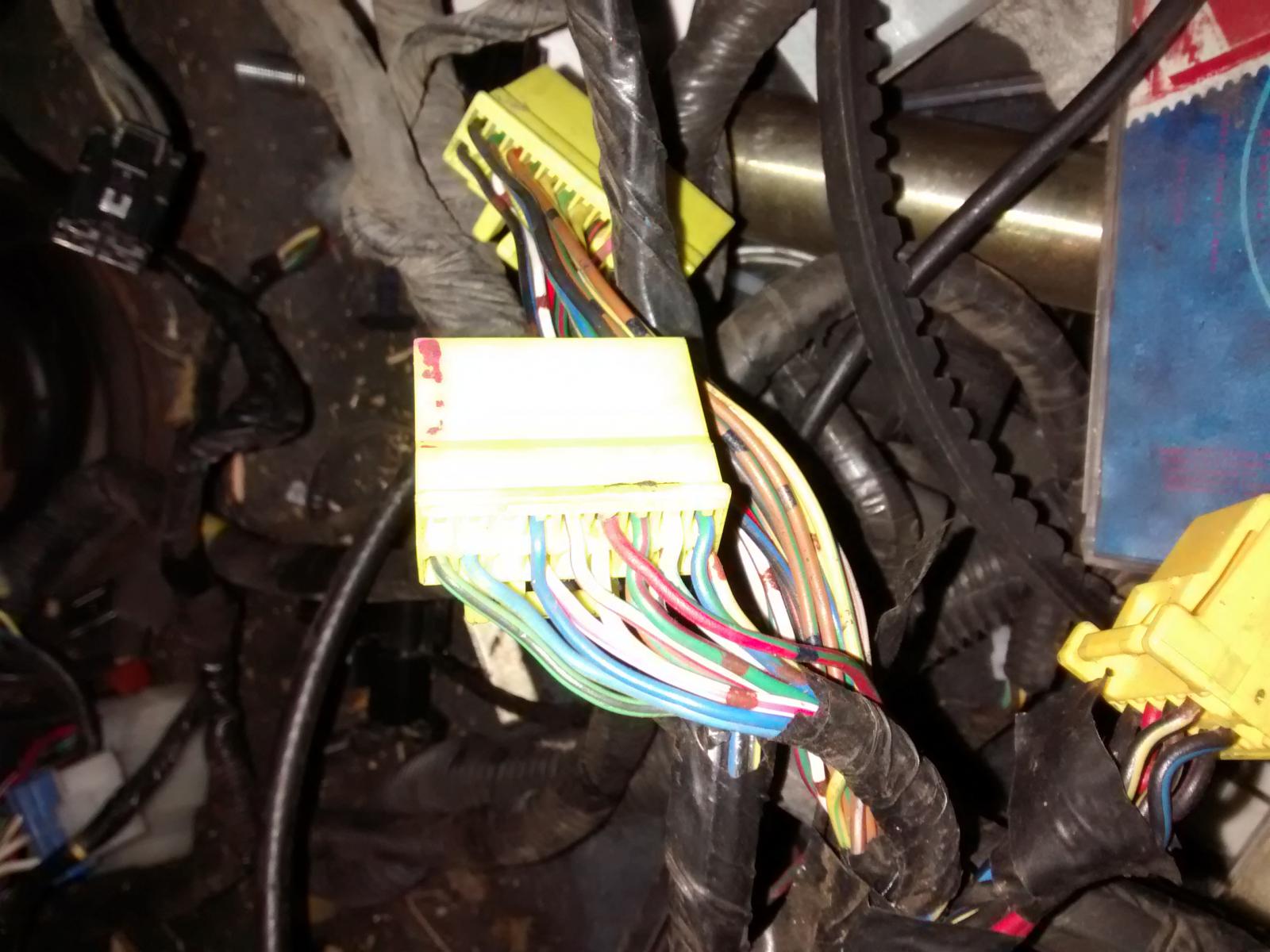

also here is an image of a 1991-1992 harness, its not real clear but if you look close enough you will see what i mean

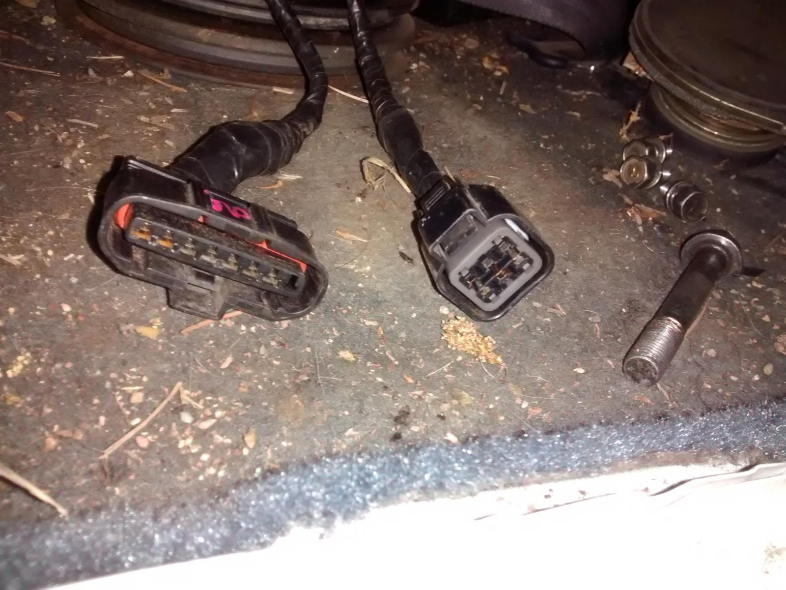

the 1990 mighty max has the same wiring going to the 1g style MAF as the 2g style mighty max MAF. You can simply cut the pigtail off a 1991-1996 mighty max maf and splice it into your harness. the wire coating is even the same between the two. the one thing that the 1990 mighty max does not have is the MAF Reset wire. You will need to grab this wire when converting your 1990 to use a 1991-1996 style MAF and ecm. YOU CANNOT USE THE 1990 ECM WITH THE 1991-1996 MAF. so if you do this be safe and create a duel connector like this.
this way you can swap between MAFS and ECMS latter if you want.
