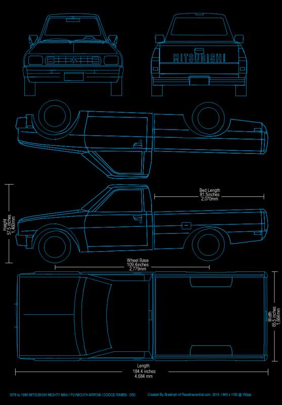

DIMENSIONS 1st GENERATION TRUCKS
Download hi-res version
79 to 86_Mitsubishi_Pickup_Truck.zip
Base Model Weight = 2,518 lbs.
Box Bed = 81.5 inches long x 64.2 inches wide
Maximum Payload = Just Over 1,500 lbs.
Body Length = 184.6 inches
Body Width = 65 inches
Body Height = 61 to 65 inches
Behind Seat Storage = 4.6 cubic feet
Wheel Base = 109.4 inches / 4WD 110 inches
