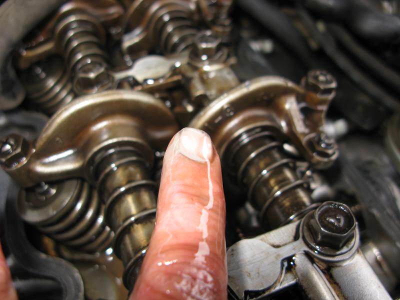

    my damn oil is milky if I put my finger and rub the bottom of the head where the camshaft sits and pull out my finger its mliky. If I put my finger in the oil and swirl it around slowly you can see the differences in the oil, like it's not all f'd up it's swirly with good/bad.
    I screwed something up bigtime. Maybe I missed a crack.
    Is there a slim chance at all that even though I drained the old oil and changed the filter in the hg steps, that contaminated oil could have been stored in the system anywhere waiting to be mixed with the new oil? damn how desperate does that question sound?!
    Yeah so anyway I undid the fuel pump to see if the arm still moves freely and yeah it sure does. Started to put it back in after I couldn't get it ALL The way out with the wind & pine needles flying around didn't want the head to get contaminated so I closed the hood, brought in the tools & here I sit.
    I already had called the local parts place for a new fuel pump just in case since they have a day delay for non-stock items & I wanted to get the truck running today. Yeah, that worked out great, too.

    Pics as promised (rain delay):
    I ain't touchin her anymore tonight, she's got me madder than ever now I may hate her... a lot. FFS I SAVED her from some guy runnin her barely bandaided together & this is what I get for tryin' so hard. UGH! Now I know this trucks a damn girl.
    3,848
    If it already had water in the oil it's just left over. Does it kick if you put some gas down the carb? Thats the first thing. Next is valve adjustments
