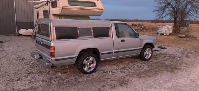

    Just giving a quick update. Not a lot going on with the truck until springtime, it's still sitting at my buddy's place. I've been gathering parts and stuff. Picked up a set of nissan frontier 4 spoke wheels, some spacers, and some new tires, as well as a few boxes of revival parts from rock auto. Wheels are temporary until I do a proper 5 lug conversion, but may as well look good in the mean time.
    We're getting deep into the cold and shitty at both places, and i dont want to risk getting stranded on the way home in the winter, so I'll make the trip out to drive it home in spring. In the mean time its just going to sit.
    The wheels look like they were taken off of a frontier when it was new and stored. they show marks from lug nuts and tires, but virtually no sign of use. got the whole set for 100$ They're relatively high offset so i had to also get some spacers for them, and they need shank lugs so i have to order a set of those too. Bought a set of 205/55-16 tires for them. Should fit pretty well if i did my math right.

    Wheels are on, except for one. Last one broke 2 studs while taking the lugs off. Oops. New studs in the mail.
    Wheels look good though.
    Nissan Frontier 16x7 ET40 4 spokes, 1.5" spacer out back, 1.25" in front. 205/65R16 tires
    Looks like a perfectly flush fit, ride height will be taken care of, soon.
