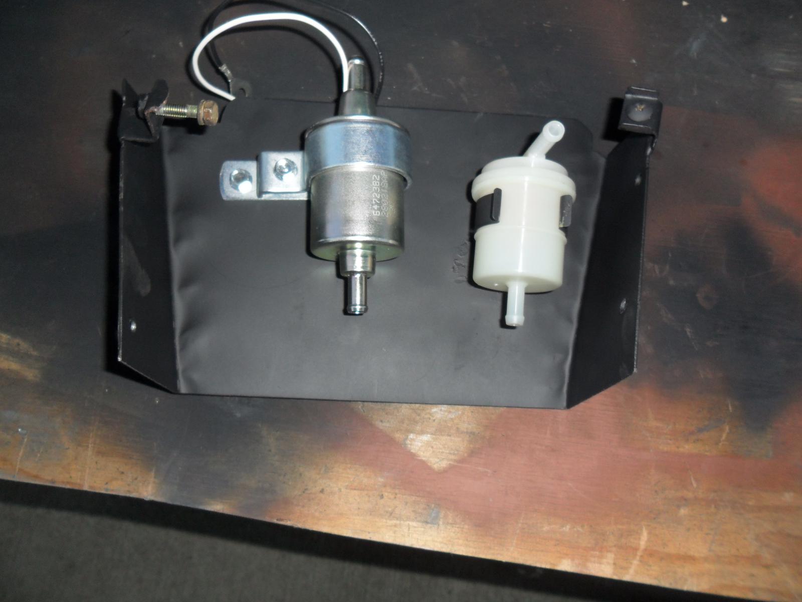

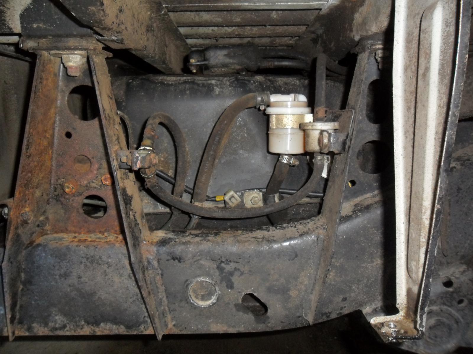

    I used an Airtex pump and installed it under the skirt behind the driver side of the cab. I kept the OE fuel filter and have recently rewired it with a relay kit from the interweb. It works better than the oil pressure switch I originally went with. Here are pics of how I installed the pump. I used a piece of sheet metal bent it to fit and bolted it in when I got the mounts on it.

    Looks like that pump you chose already comes with a screw-in mini filter on the intake side, so you could just stick with that.
    For replacement filters, looks like that unit would be a Wix 33046 or Mr. Gasket 1242G (or other equivalents).

    You won't need to keep the OEM filter, since that was a pre-pump filter for the mechanical fuel pump attached to the engine, and your new electric pump already has a pre-pump filter of its own.
    I would keep the oem filter. Bigger and better than the little ones that come on a pump. Doesn’t hurt to have the big one before the pump.

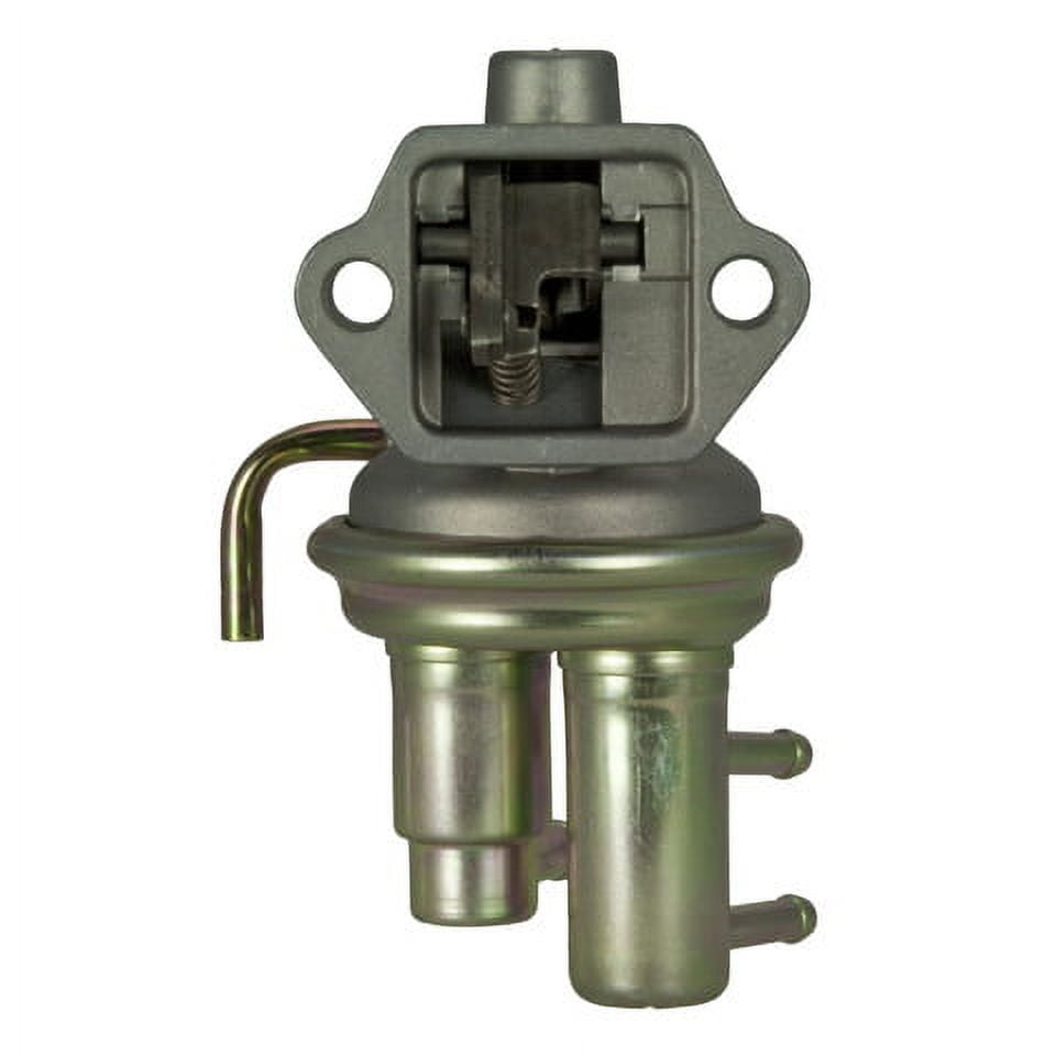

    It seems like it's running great, I ended up just blocking that line off. Does anyone know what that 4th line on the mechanical fuel pumps are? Mine is puffing lightly (as the pump goes) and creates a vaccum. It's connected to a short line and just dangling freely.
    https://i5.walmartimages.com/seo/Car...5cc48b8a9.jpeg
    That little line on the very left. Thanks

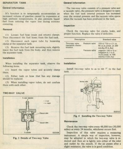

    Gas Tank Vacuum buildup
    Hello, I disconnected the charcoal canister and used the return line for a fuel pressure regulator.
    This causes vacuum to build in the tank for large wooshes when removing the cap. I remedy this by taking the seal of the gas cap so it isn't airtight. The downside is that I feel this allows gas to evaporate out if my tank.
    Does anyone know a good way to let my tank vent? I cant find any vented caps.
    03-06-2018
    668
    Tucson, AZ USA
    The tank is meant to vent positive pressure/fuel vapor to the charcoal canister and draw negative pressure (vacuum) from the ambient air. There should be a two-way valve in the vapor line between the tank and the canister that controls this; tank vacuum should draw air thru this two-way valve. Compare the photos in post #2 above to the manual scans I'm attaching here. Sounds like that two-way valve might be malfunctioning if your tank is developing a vacuum, or maybe a hose between the tank and that valve has collapsed internally, causing a blockage?
    Why did you disconnect the charcoal canister? And I'm not clear what you meant by, "used the return line for a fuel pressure regulator" -- was that line connected to the canister, or unrelated?
