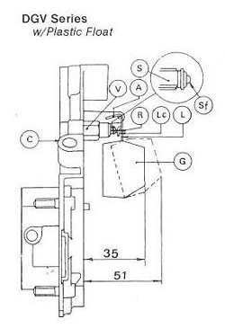

    What's the pressure regulator set to? Should be 3-3.5 psi for a Weber.
    Also check the float levels, and adjust if necessary by bending the relevant tab(s) on the float arm until the float rise and drop levels are in spec. Weber vendor Pierce Manifolds provides the following instructions:
    Float level, in mm, typically refers to the distance from the face of the carburetor top cover to the float. With the top cover held vertically (float pivot at the top) and the float tab (Lc) resting against, but not depressing the spring loaded ball in the needle valve, measure between the face of the carburetor top cover to the bottom of the float. On carburetor models where it is required to remove the float to replace the top cover gasket, the measurement should be made with the gasket in place to the gasket face.
