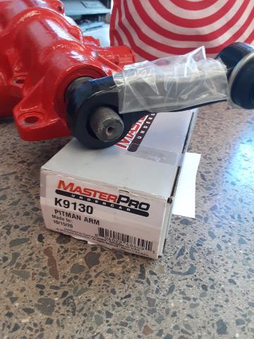

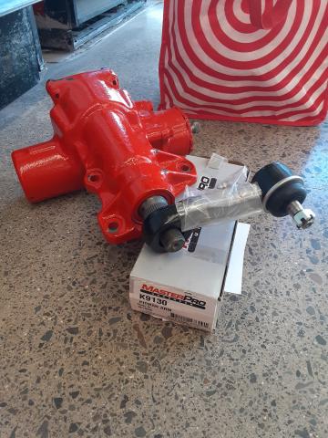

    I went to O'Reilly's Auto Parts Store in Kailua this morning; they had the RWD Pitman arm for a 1986 Mitsubishi Mighty Max that I asked them to bring in from their Waipahu store... So I put the RWD Pitman arm on this gearbox and it fit just like it should; this verifies the gearbox is 2 Wheel Drive power steering gearbox for 1984 1985 1986 Mitsubishi Mighty Max or Dodge Ram50 per MitsubishiPartsCentral part # (MB266612)
    Please don't measure away on your truck because I will only send this FREE to a member who has one of the vehicles we NOW KNOW it's for..!
    Please excuse all the fuss & frustration I may have caused you folks by suggesting to measure your gearbox to see if this might fit
    I (suppose) it was my responsibility to know what the heck I was giving away BUT the fiasco started with BAP sending a part that will not fit my truck & they swore on a stack of bibles several times claiming it was a 4X4 gearbox for my truck..! But now like Paul Harvey, "I know the rest of the story"
    FREE (you pay shipping) shipping USPS is about $75.00 from Hawaii to KC Missouri... Will only send for owners of 1984 1985 1986 RWD trucks..!
    ITEM: (MB266612) Mitsubishi Mighty Max or Dodge Ram50 Power Steering RWD gearbox ~ rebuilt & purchased from BAP (see my photo album)
