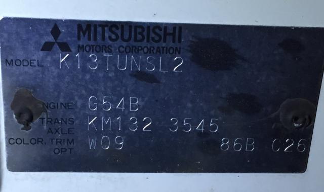

    1986 Power Ram 50. Manual transmission, what transmission do I have and are rebuild kits available. Where is the ID number on transmission and transfer case. Thanks

    Do you have an ident plate on the firewall?
    mine is on the passenger side of the firewall inside the engine compt and it has the codes for engine & trans.

    Ident plate should look like this:

    Your engine should be G54B 2.6l which would mean, You have a KM145 trans and a KM100 transfer case if its 4wd; as per your post being a Power Ram 50. If your truck is 2wd you have a KM132. Do not buy so called complete kit from ebay specifically from Trans World. Tear the tranny down and replace the bearings and parts as needed; cross reference all bearings through google for the better Timken bearings. Your local O'Reilly's or Auto Zone or whatever might have them in stock and cheaper. Don't forget end play off input shat may require different thickness shim.
