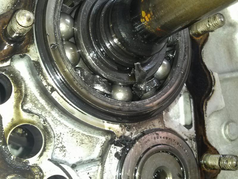

    So here some information I found on some differences between the KM-145 and KM-132 trans. In my ignorance I thought they were identical with the only exception being the tail extension housing one for 4WD and one for 2WD. WRONG!! Attachment 5685 So here is some of scrap metal found when I pulled the pan. Attachment 5686Attachment 5687 Input shaft bearing, the scrap on the right in pic one is part of bearing that work its way through into main side of case and these are showing the reason for rebuild.

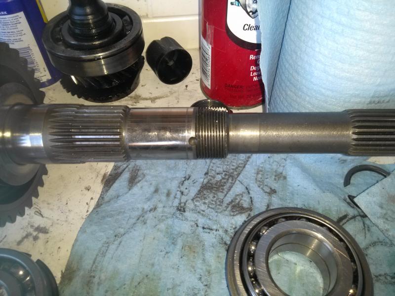

    Correct sir, and here's whytranny8.jpg Here is what your output shaft looks like (A) it is longer (B) notice the small detent just below the threads a small bearing fits there with matching washer then the lock nut, locking the whole assembly together. KM-132 2wd does not have this locking detent.

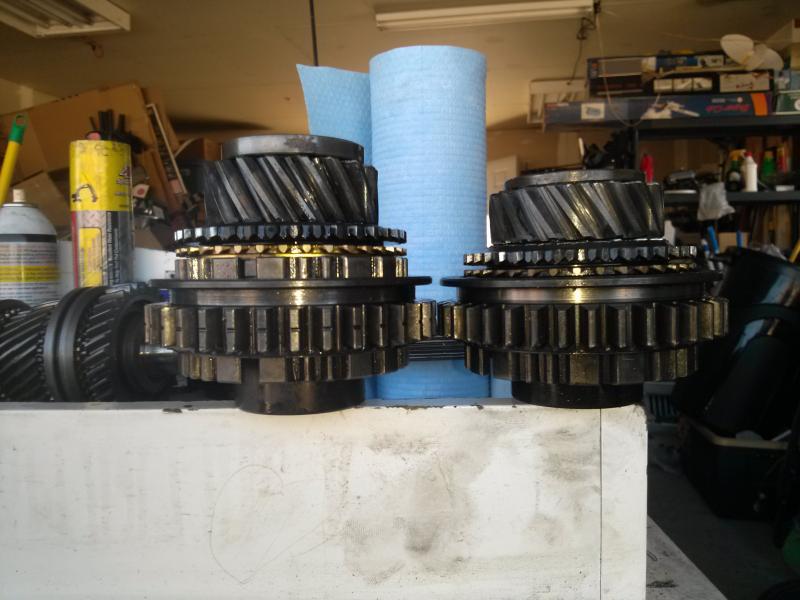

    Here is another difference.tranny10.jpg This is a side by side of the complete 5th gear and reverse as they would be installed. Left one is 4x4 KM-145. Right one is the KM-132 2wd. The small spacer on top of left one is where the small cutout detent is that matches up on the shaft. I am sure if you were to swap all these parts around you could possibly make it work, but then whats point you might as well just rebuild your old one.

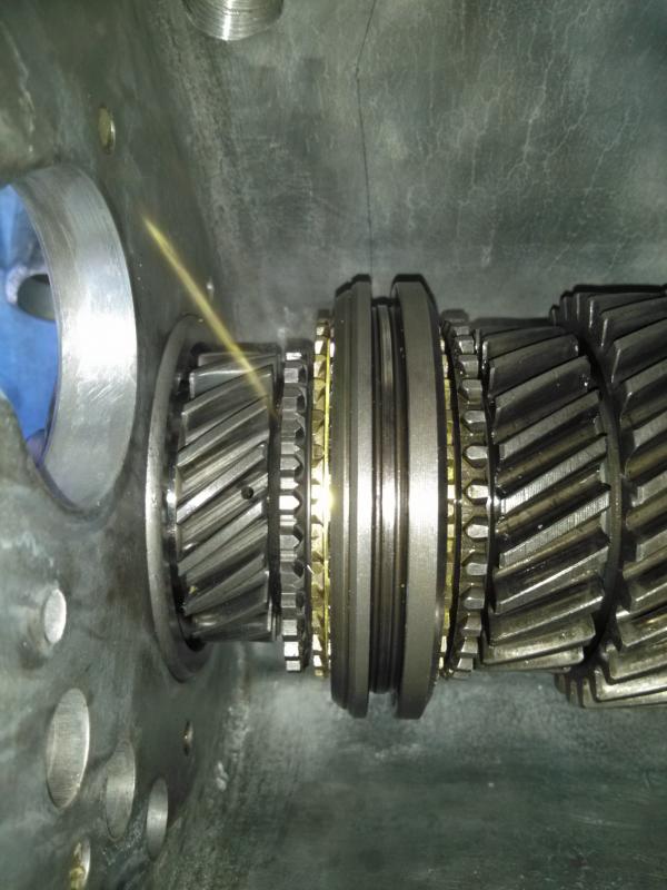

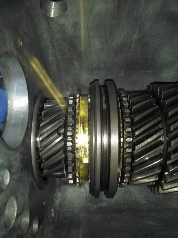

    Here's the photos of me trying to use the 132 double roller.tranny19.jpgtranny21.jpgtranny23.jpgtranny24.jpg Notice the gaps in the main shaft or the lack there of. That is why I said f it bought stock replacement.

    Here's the reason for my rebuild.Trannyscrap1.jpgTranny.jpgTranny1.jpg The scraps in pic one actually worked their way through the bearing into main case I found them when I pulled inspection cover off bottom of tranny. They are spring for front oil seal and bits of the retainer that holds the actual bearings apart.
