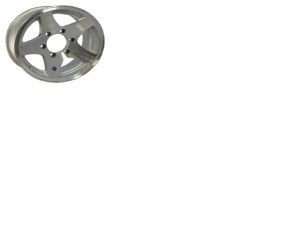

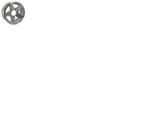

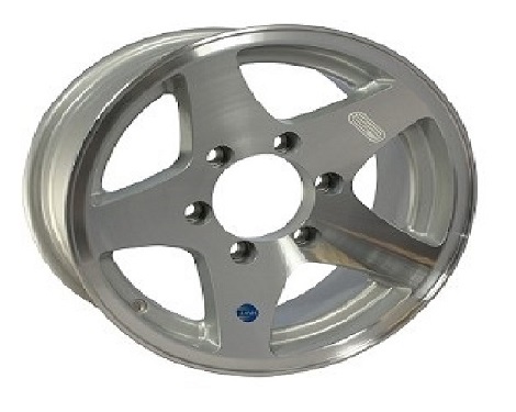

    SHOWING A WHEEL ~ if not a new wheel, then what powdercoat color besides OEM silver might look on a white truck with stock steel wheels? Bronze, Gunmetal, use a 2nd color on the centercaps, etc..? Ideas?
    Above wheel came from here: https://www.trailer-wheels.com/15x6-...l#.YeDYgdXMIy4
    Seems that 14" & 15" trailer wheels fit the Mitsubishi, 1st Gen anyway...
    My owners booklet says the 1986 Dodge Power Ram 50 4X4 truck wheel has 22mm (.086") offset but this trailer wheel (pictured) has 0 zero offset ~ if I understand Google correctly, then this wheel will cause my tires to stick out farther than stock (about .086") ~ that is on my assumption that the owners manual does not have a minus sign or NEG for the 22mm offset meaning it's an OEM positive offset bringing the wheels out a little further than the RWD 40mm offset truck wheel... Will the police let it fly or will I need wheel flares..? Will it look funny or not be driveable with wheels hitting steering or suspension or body work..? Found a 0 offset wheel need post it...

    Note 22mm = 0.866" (not 0.0866"), so those those trailer wheels will stick out nearly a full inch more than stock.
    Changing wheel offset from stock also alters your scrub radius, which affects steering feel, stability and self-centering, but that's less of a concern with relatively crude-handling trucks. I'm not sure what the stock scrub radius is meant to be, but I'd suspect it's positive, so pushing the wheels out would just make it more positive, which is less of a concern than shifting it closer to zero.

    Thanks sub yeah .86" it's over 3/4" for sure ~ I gotta learn what exactly is offset & backspace ~ think I know offset the wheel bolting surface in relation to how far from center of wheel width (?) backspace wheel bolting surface to inner rim edge (?) I gotta measure the backspace...
    RAM 50 owners manual shows wheel type (4X4) truck ~ 5.5K x 15 or 6-JJ x 15 ~ and Google interprets it to mean 6" wheel width (but still wanna measure backspace...) although it should be 3" from the wheel bolt surface to the inner rim edge + the 22mm .86" offset = 3.86" backspace, sound right..??

    Extra offset will improve feel and handling on the road but it also will leave you open to 'bump steer'. Don't know how dramatic that would be in a 4x4 but I had a little Mitsubishi fastback that would try to do lane changes if you hit a rut in the road and wasn't ready for it. I went from 14x5 to a 15x6.5 wheel with series 50 tyres and the offset was 40mm which was extreme lol but it handled like a go-kart... Maybe adding a steering damper to it will negate the possible bump steer

    Offset (also called ET, from the German "Einpresstiefe" meaning insertion-depth) is the deviation of the mounting face from the wheel-width centerline -- i.e., how far off-center the mounting face is.
    Backspace is the distance from the inboard rim to the mounting face -- i.e., half the wheel width, plus the offset (or minus, for negative offset).

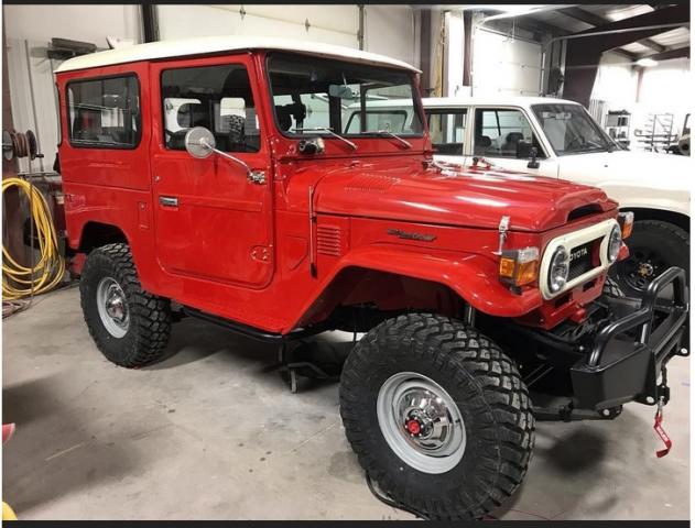

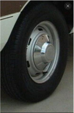

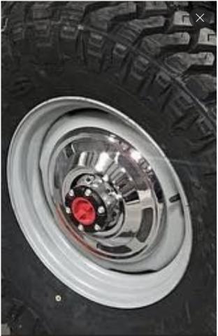

    white goldish we need a sideways thumb IF I can afford to do anything, I am now inclined to keep the original wheels & hub caps but massage them with new powdercoat color & try getting the hub caps chromed ~ just this is wishful thinking & expensive too ~anyway, here are a few screenshots from my cheap Samsung phone massaged with Microsoft Paint ~ pardon the low res quality ~ Oh, and the theme here is plain stock wheel with a chrome center cap ~ the last photo a Ram50 but not my truck ~ many thanks to you tortron for that southernly info & good luck to you and especially geezer in the Omicron "Let It Rip"
    and lastly a RAM50 version of painted wheel with chrome centercap -->

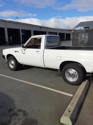

    We went with chromed center caps on the stock silver painted 15" wheels; a decent look & most affordable option... Where have I been..? This should have been posted long ago (!?!) Hope the pic rotated upright X'd fingers...
