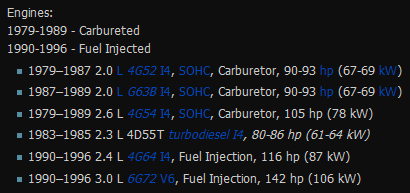

    Geezer, I’ve got the 2.6L I think it’s the G43B??? I can’t remember the numbers on these from previous research.. I do however KNOW it’s a 2.6. Ended up finding the original window tag. I’ll keep checking for cam info on here when I get some time
    01-09-2020
    514
    Cant Say
    Dodge V6
    the 2.6 is the 4G54 or G54B
    the 2.0 is the 4G63 or G63B
    the 2.4 is the 4G64 or G64B
    the 3.0 is the 6G72

    Early trucks ran 4G52's (Astron I 2.0L - it looks identical to the 4G54/4G54B/G54B). Some countries also got 4G32/4G32B's (Saturn 1.6L) and were in production the same time as the 4G52. So your engine will be a 4G54 variant. SubGothius has got this covered Only thing I would do is block the EGR gallery from the exhaust port and remove the EGR stuff altogether (keeping it all in place will be enough to make the casual observer think all of the anti-pollution stuff is still connected and operational) but that is because I am severely OCD and have a raging hatred for the anti-pollution crap. I completely ground off the EGR gallery on my intake and cut 50% of the valve mount off in preparation for a Weber swap on my G63B...

    i thought the 88 power ram used the 4G6 series, not the 4G5. hmm, odd.
    the new weber carb has no provisions for egr, the best way to go is to completely remove the EGR system and get a block off plate, because if he goes with a header its more likely than not that the header WONT have provisions for an EGR system. then youve got a big hole in your intake manifold.
    i know that the 1 gen trucks did use the 4G52, but i was sure that the conversion year (1987) was the year they went 4G63.

    i knew i was right! 87-98 G63B ...
    4G6X variants didn't start until about 88-89. And I think I goofed - the 4G32B/G32B's were Sirius engines not Saturn (Saturns were chain driven)

    his username is 88 power ram... and under his profile it says 1988 dodge power ram 50. so either he has a swapped 2.0 or he actually has a 2.6. there is an emissions decal under the hood that states what engine its got. or is there a 4x4 with a 2.0 offered from the factory? i must be missing something here.
    but given the redesign was in 1987 im pretty sure thats the swapover year for the 2.0 engine. makes more sense to me anyways, but i could be wrong there.
    guys take it easy!! Lol I’ve got the original window tags and it specifically says I’ve got a 2.6. It DF25C916-5DE9-49B8-82EE-2ABAD41C6D04.jpg..
    now, I’m not sure of the technical name of the motor but thank you for all the wisdom! I’m just trying to figure out cam options and maybe some tips and tricks on how to instal the Weber 38/38 within a 3 day time frame so I can get it back on the road
