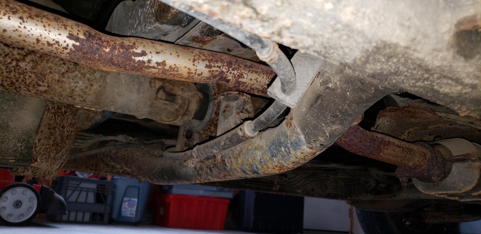

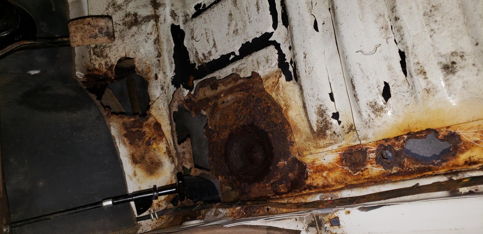

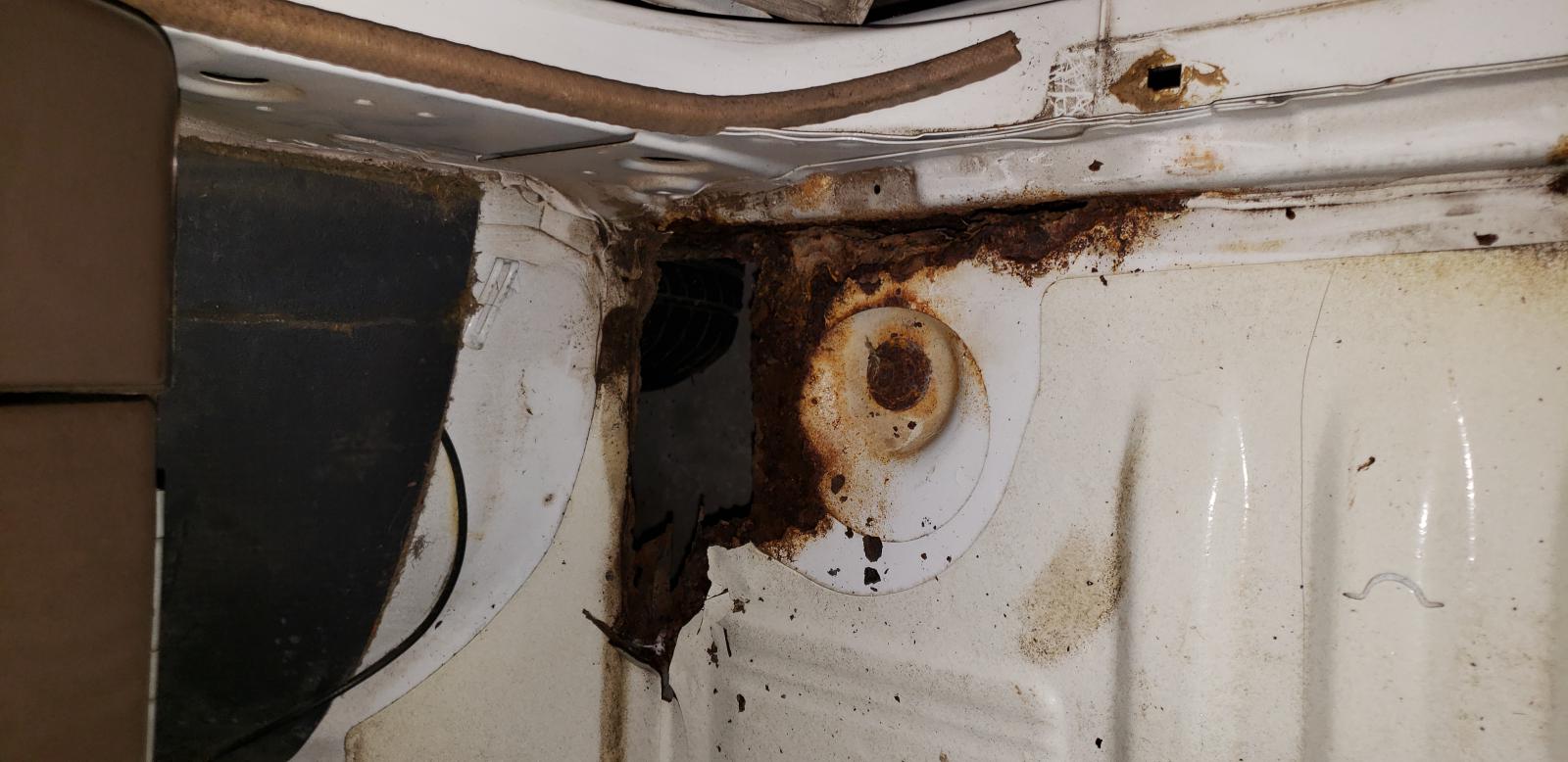

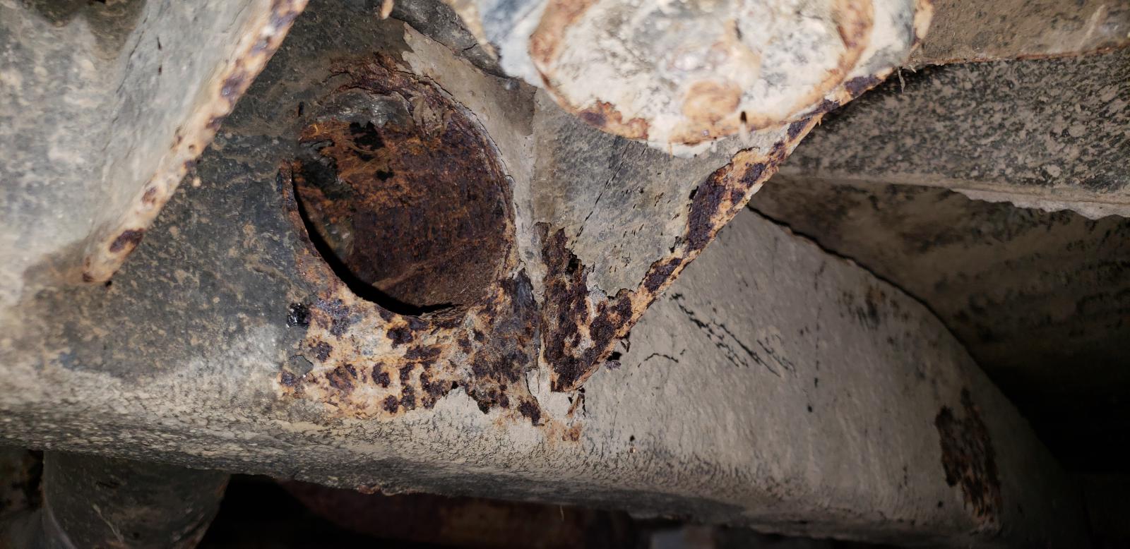

    A lot of floor pan and frame rust , runs - drives with leaks of course .... Is it worth trying to fix ? body parts like floor pans seem like they are not available20200426_134128.jpg20200426_134159.jpg20200426_134248.jpg20200426_134253.jpg
    Are there any good sources for parts and body panels ? Thanks

    A member has been fabbing his own cab supports (Tortron) so maybe put a call out to him and ask if he'll do you a deal. The rest of the rust repairs... either as camo has suggested or a sheet metal shop would be able to supply you with some material to patch up the flat areas.
    1,219
    Depends what you mean by worth and if you start paying someone else to do it you are probably better off parting the truck out and getting something in better cond. How bad is the rest of the cab? Might want to take a good look at the chassis for holes
    I haven't measured up a 2nd gen, but it looks similar in shape at the floor/cab mounts, so what I make is probably close enough to fit
    There's a guy in NZ that makes new outer sills
    Our dollar is worth nothing at the moment, so even with postage it's probably affordable lol
    This is purely subjective but you have to evaluate what 'worth it' means. If you got the truck dirt cheap and factor in how much you'd be prepared to spend on a cleaner truck and split the difference, you have a figure on what makes the fix up viable. If it's to flip the truck, there's no money in restoring cars unless it's so rare that you can afford to invest the resources (I'd bet at least 80% of 'restored/modded' cars that are being flipped have some nasty ghetto botch work done to them). If it's an emotional investment (the truck belonged to a close family member or it's something you grew up with etc) then what you get out of it is what you put into it. Skills and time wins over towing and workshop hours. This gets asked a lot and there isn't a right answer, but you will find that all of the members here aren't pulling out receipt books and bragging about how much cash they think their truck is worth.

    Jeffum, from your zipcode you look to be in the Harrisburg area of PA. There is a salvage yard in Slatington PA with at least two Gen 2 MMs. You may be able to swap the cab or cannibalize body panels if you know how to weld.

    i have a 1976 F100 with rotted floor pans. take some sheet metal, cut out the bad, and weld in the new. take a side grinder and a cutoff wheel and 'sand' (grind) the metal off by dragging the wheel across the weld. common stuff (sorry for going into detail not many people in my immediate freind zone know how to make a weld flush. you may know how to weld)then spray it with primer, and if you want get a paint shop to color match your current paint and buy a cheap little spray gun and get to work. doesnt have to be absolutely perfect but it should look good. the door on my truck has been painted (i think, its a slightly different color) and the fender has a bit of rust. its visible in photos but overall its solid. as long as you have a solid frame and cab and solid control arms and rear axle housing, youll be absolutely fine.

    Just to pitch my $.02 worth most body panels are connected with epoxy these days. If you can't weld you can glue and you can use Bondo to smooth the edges.
    That frame looks to be mostly superficial. Clean it up and get a better idea of how bad it really is. Looks like a coating of some rust treatment like Ospho to stop it should be enough.
