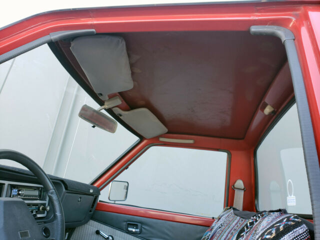

    just found a picture online of the interior of a first gen and it looks like the dome light is different than a second gen.
    immaculate-1986-dodge-ram-50-sport-5-speed-rust-free-california-gem-121k-miles-13.jpg
    It kinda reminds me of the light in the trunk of my Dodge Conquest so maybe a part number on it might be best so maybe an MT138325?

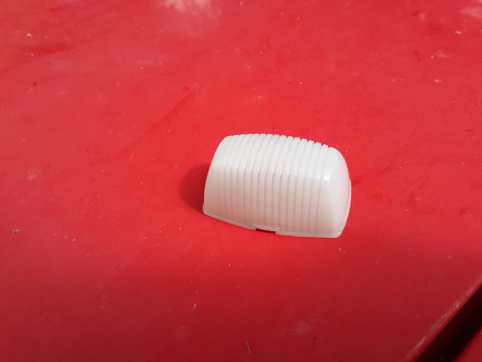

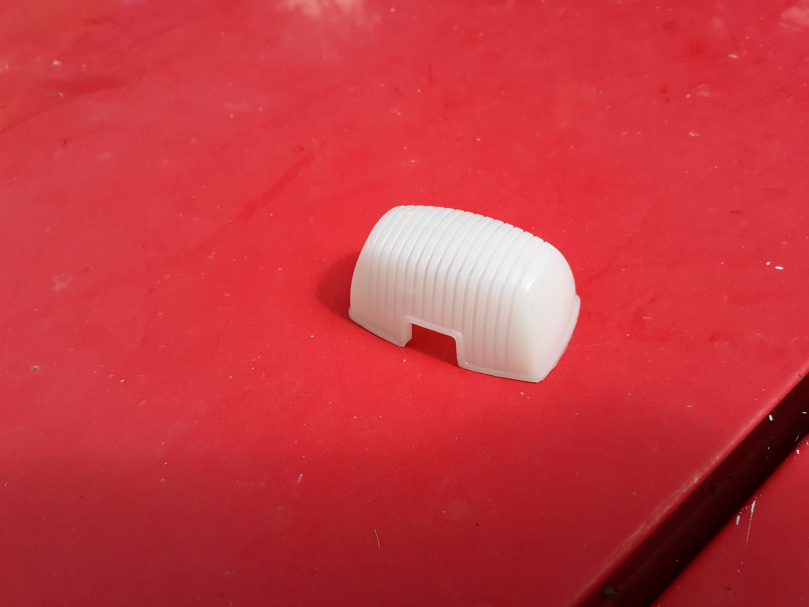

    Here is some pictures of the trunk light lens from my Conquest with a key for size reference. i can go measure my truck dome light if you don't hear back from the seller
    10-29-2014
    1,261
    Earth, the Solar System
    Seems similar. Mine, the mounted light fixture itself, is 1 3/4 side to side. I had ground off the curved top trying to make an after market cover fit but the metal of it kept shorting out the fuses every time I tried to fit it on.If that is 1 3/4 side to side inside it may clip itself on.
    08-29-2016
    253
    Siskiyou County, CA
    i just measured the conquest lens and its 1 7/8" wide. i looked at the dome light in my truck and its 3" by 2" so its a fair bit bigger than a first gen light.
