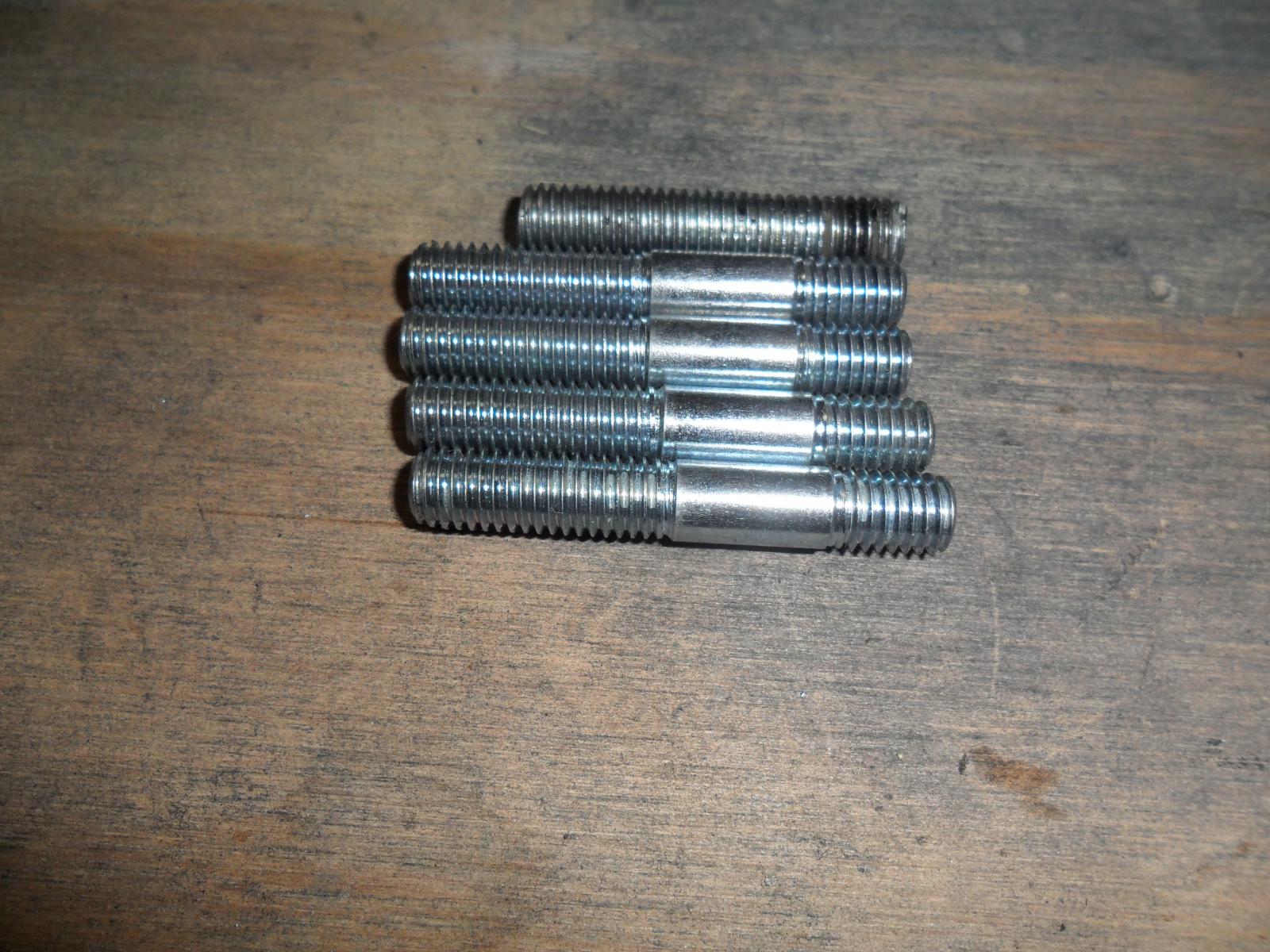

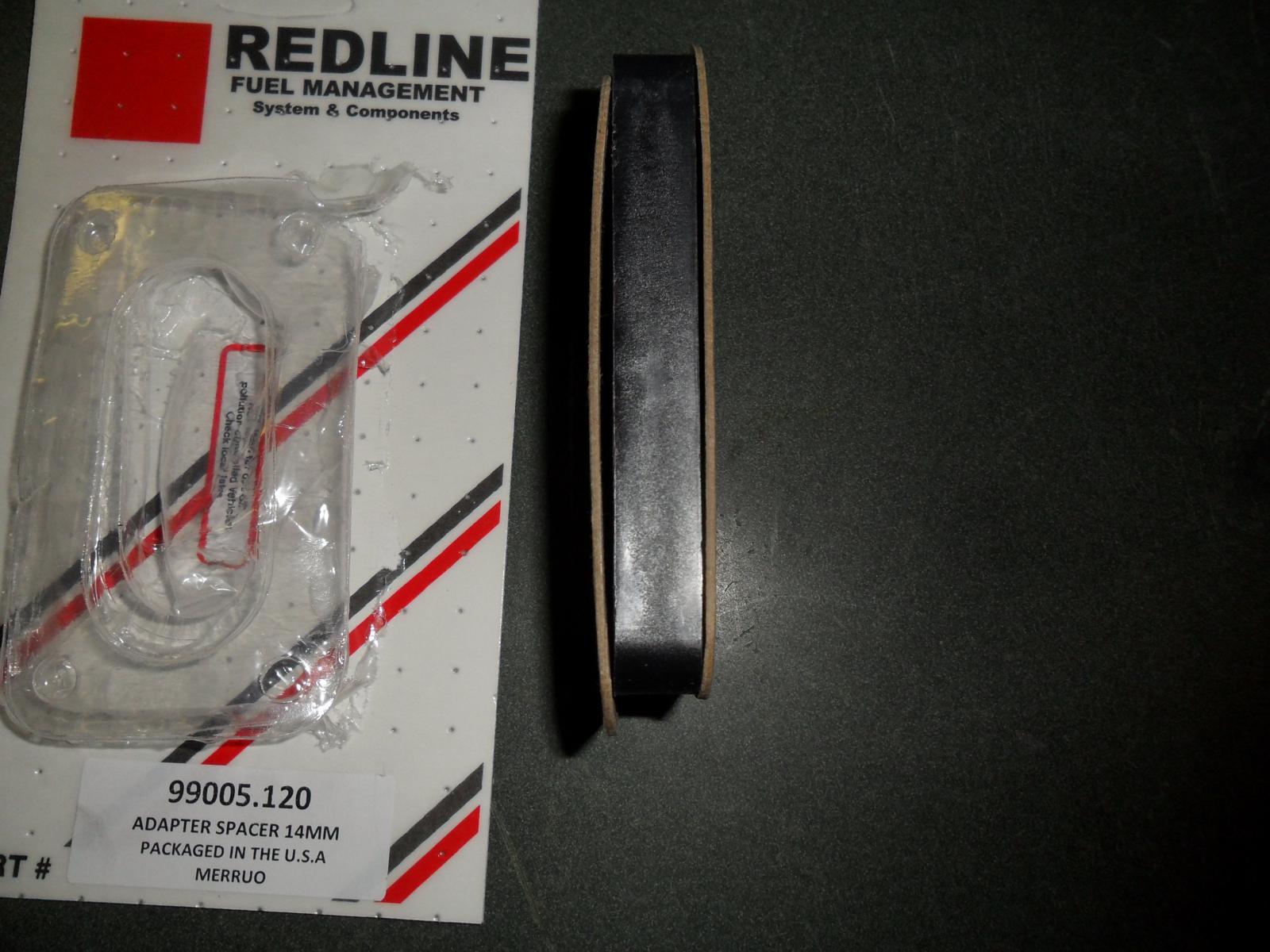

    Received the spacer. Won't be able to put it in until I get the other rig back on the road. Should be within the week Just posting to show pics of it. The packaging is obnoxious you will need a razor blade and to be very careful the gaskets are fully sealed in the same vacuum wrap but somehow separate too. ?? Just sprang into my mind, What if the studs are not long enough? spacertop.jpg spacerside.jpg Cost $16.83 shipped, free shipping actually.
    Holy crap, that is one thick spacer
    about 5/8 inch for you English folks. Should still be able to use the studs you have to bolt down the carb...

    Studs were too short. You can see the dark bit on the short one is to my eye minimum amount that needs to be seated for it to function properly so backing it out isn't really an option to me. Got some new proper studs 1.25" x 38mm it said on the drawer they came from. if you do that be careful these came through the bottom so I back them out until it was smooth. I used blue thread locker. I took a nut in to be sure it fit. It started up fine. I might take it out to get it hot later in the week.
    For those who don't read
    Oh yea on nut was real easy to back off and the others were no effort at all. !!!? I went around them many times this time and I will check again once they get heated and cooled a couple times.
