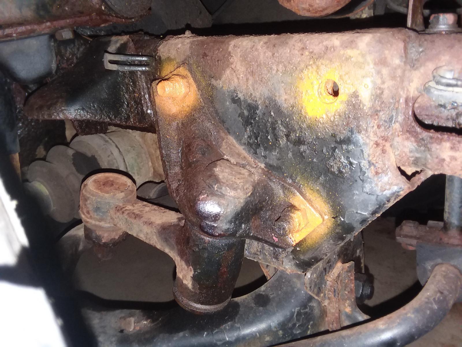

    it worked. here they come look out....
    these are the bolts/holes that hold the steering box & idler arm.
    i ordered a RHD idler arm from the UK last week, its for the next generation mkIII L200, but the bolt pattern looks
    very close to the mkII L200/max. its taking its sweet time to get here unfortunatley, soon as it does
    and i can verify the pattern is the same or close enough to mod, ill order the box and get that coming.
    i fear to see the shipping quote on that, the new idler arm cost $40, shipping (slow shipping was $50)

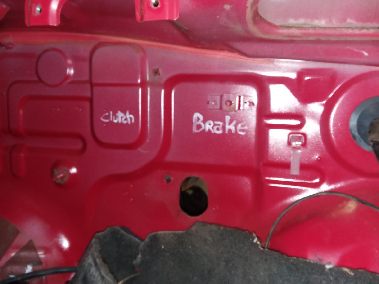

    got some progress made on the interiour. pulled the dash, a/c unit, blower motor, and heater box.
    now i can start replicating brackets to move the column and pedal cluster assembly to the right side.
    20190306_194022.jpg20190306_193902.jpg20190306_190455.jpg20190306_193550.jpg20190306_190218.jpg
    you can see the spots the brake master (B) and clutch masters (C) go on the firewall.
    theres an entire panel spot welded onto the firewall that has the pedal cluster studs welded to it
    its welded on the bay side so the studs stick thru into the cab to catch the pedals, the brake booster
    studs are also on or thru this panel, its to re-inforce the firewall and make locating the pedals quick in
    assembly at the plant. im sure theres a LHD & RHD panel as they are stamped w ridges & such, so i cant
    quite flip it over, ill hafta cut out a mirror image from some 1/8" sheet and spot weld that to the right
    firewall. you can see it in these pics, around the booster and near that diagonal groove in the firewall
