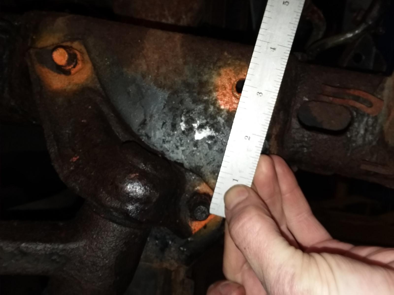

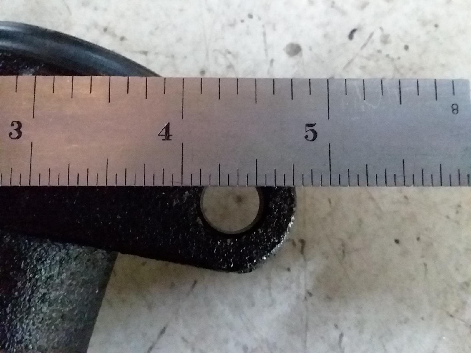

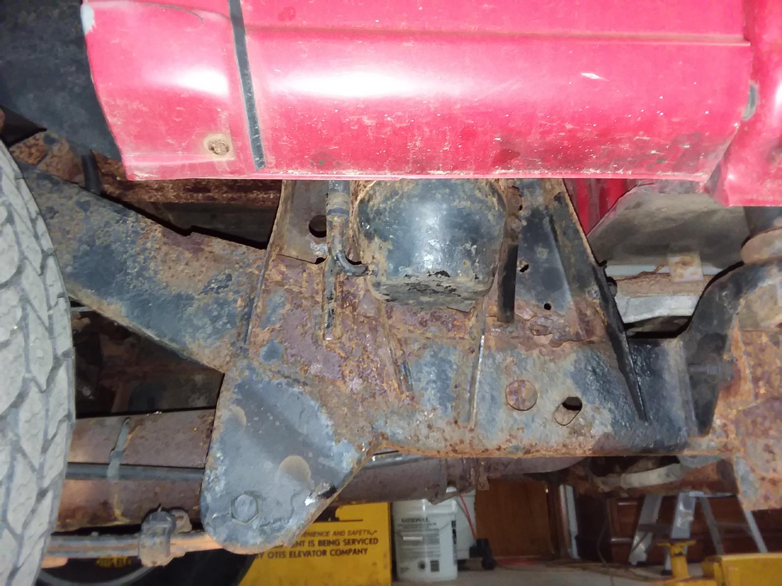

    My hasty purchasing has supplied me with parts off of a 2005 mkIII trition/L200, which is nice
    cause they are newer parts, esp the steering box which is used. But alas, the dimentions are
    NOT quite the same. Not off enough to worry me, just hafta persuade things a bit more is all.
    the two forward holes are close enough to call the same:
    but the 3rd is off by a good 1/8 inch off, maybe a tad more:
    thats how much its off, not much:
    they are just thru-bolted thru the frame rail so ovaling out a hole is not a big
    deal, but there are other dimentional issues at hand here. most obtrusivley

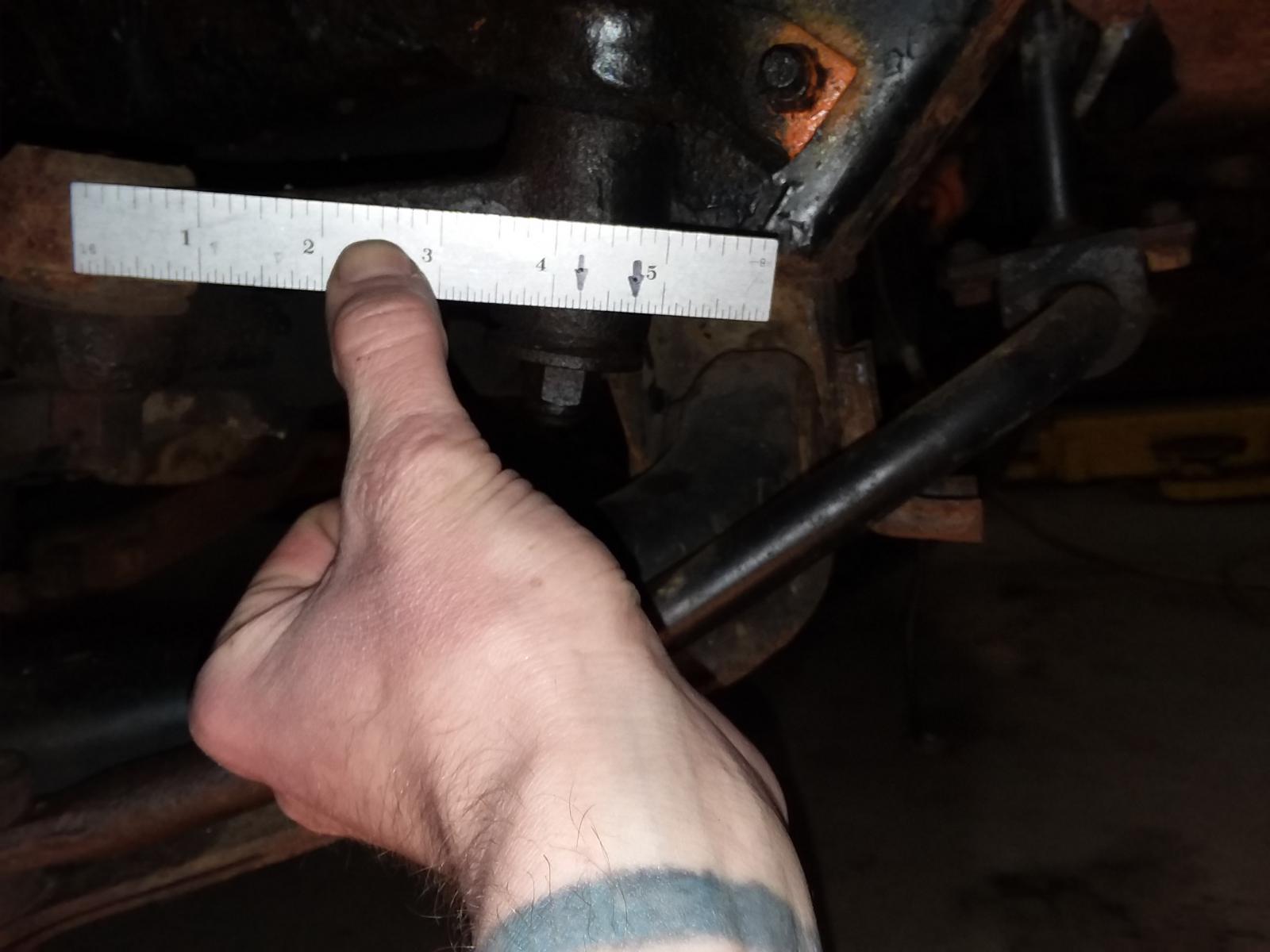

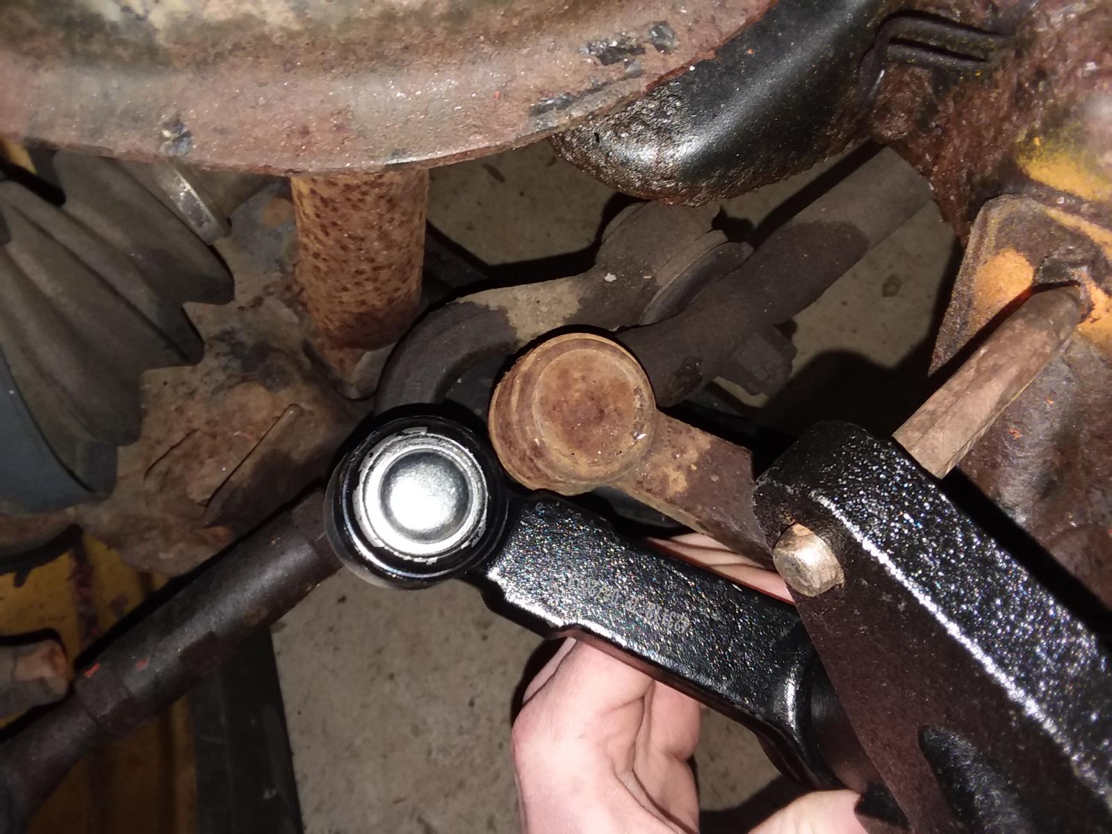

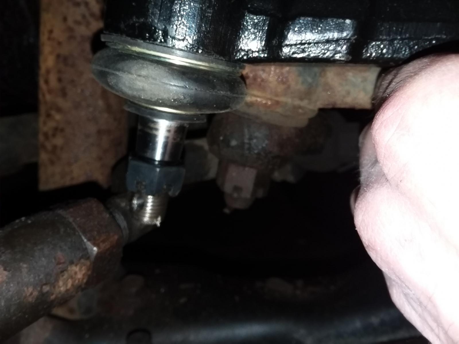

    is the idler arm itself, which is about 1/2 inch LONGER than the MKII maxes:

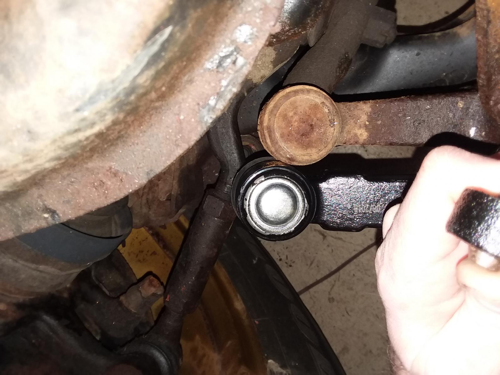

    now things start to get tight when you look at the clearances between the
    lower control arm, the tie-rod, shock, etc. in here. until i can get the LHD
    idler arm & box removed and actually place things against the framerail its
    hard to tell exactly how close everybodys gonna be:
    hopefully the idler arms balljoint will clear the bump-out in the tie-rod, if its too close
    im either going to slot the steering box holes & move the idler arm & steering box
    forward on the framerails like 1/4-3/8 inch, shudnt need more than that, prolly wont
    take the whole 1/2inch, looks like enuff space.
    OR, i was going to rotate BOTH the arm & the box a tad to change the angle of the
    idler & boxes pivots like 10 degrees or so, thusley:
    thing is it'll move the balljoint down which is closer to the lower control arm, so we'll
    see once the box arrives ( if you jinxed me geezer so help me...) and i can get things
    mocked up on the frame.

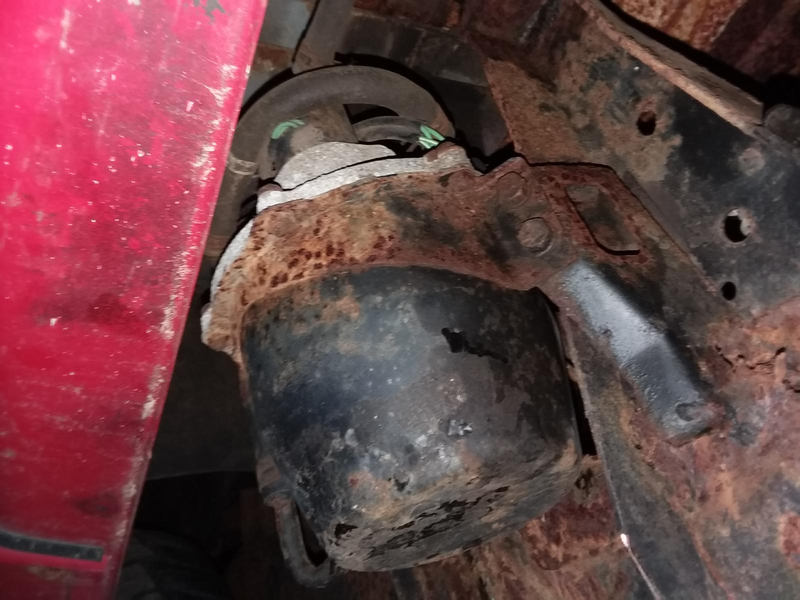

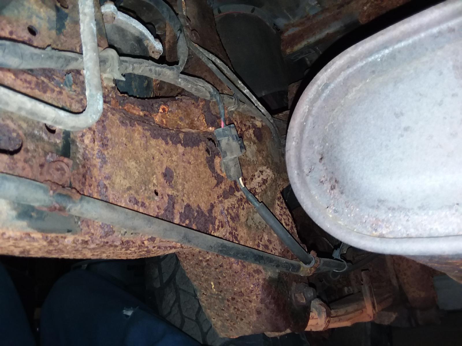

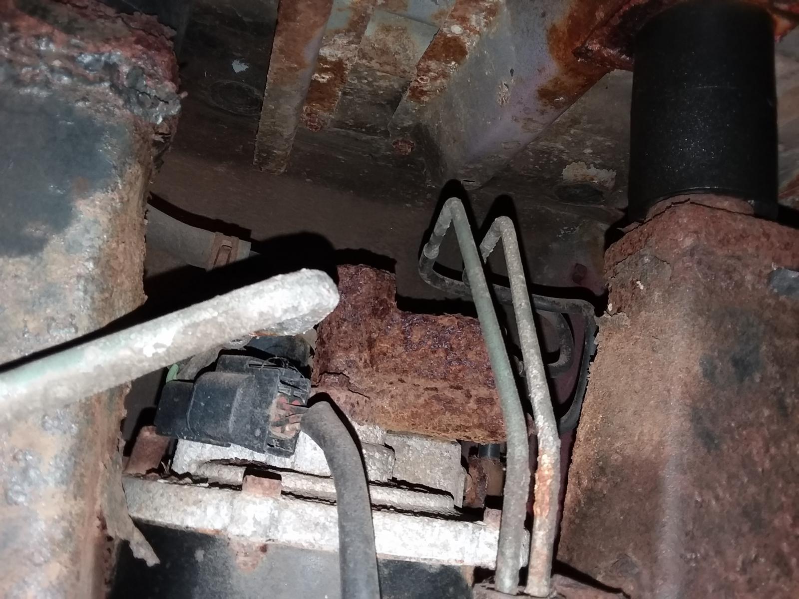

    i forgot to snap some pics of the rear brake lines and the odd capsule/canister i found in front
    of the right rear wheel, tucked up under the bed corner, has brake lines and vac lines going
    into it. i was following the 2 brake lines as i want to delete the load/pressure regulator unit
    that is mounted over the rear axle.... hoping i can delete all that shit and just have a brake
    line ( or even if need be) to the rear brakes. ill snap some in a bit & slap em up show u wat
    im talkin bout.

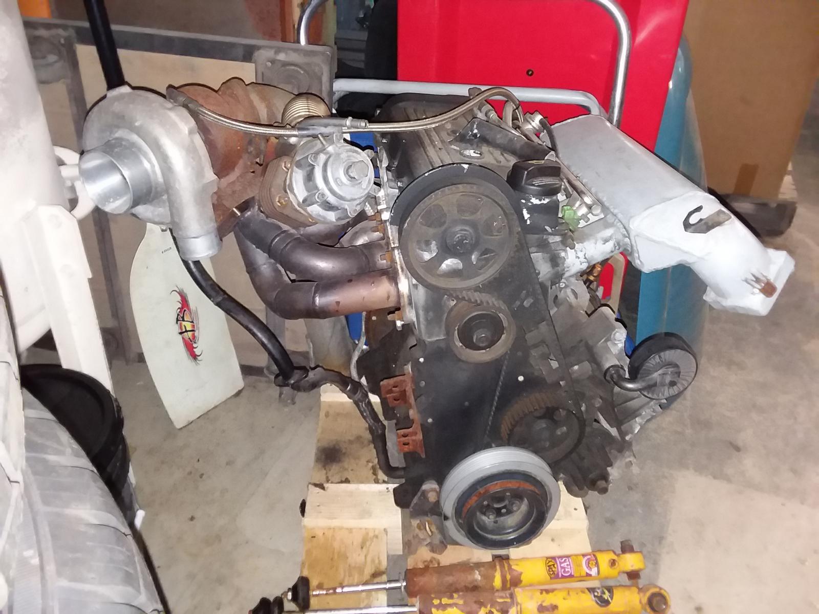

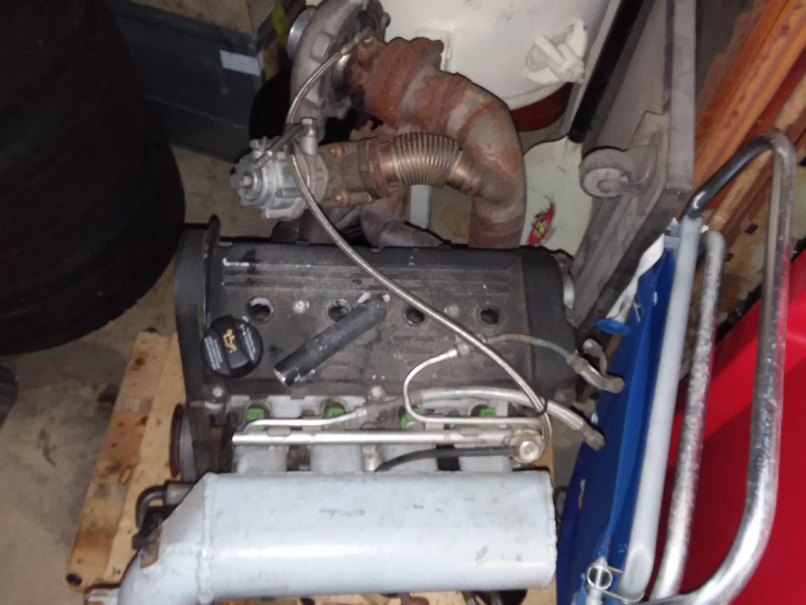

    So ive got this thing sittin around, it wouldnt be hard to fit this guy into Montgomery.
    its a vw 2.0L 16v dohc (aba/16v) w/ t3/t04 custom header & intake manifold.
    just needs a megasquirt kit and it'll do 300whp....

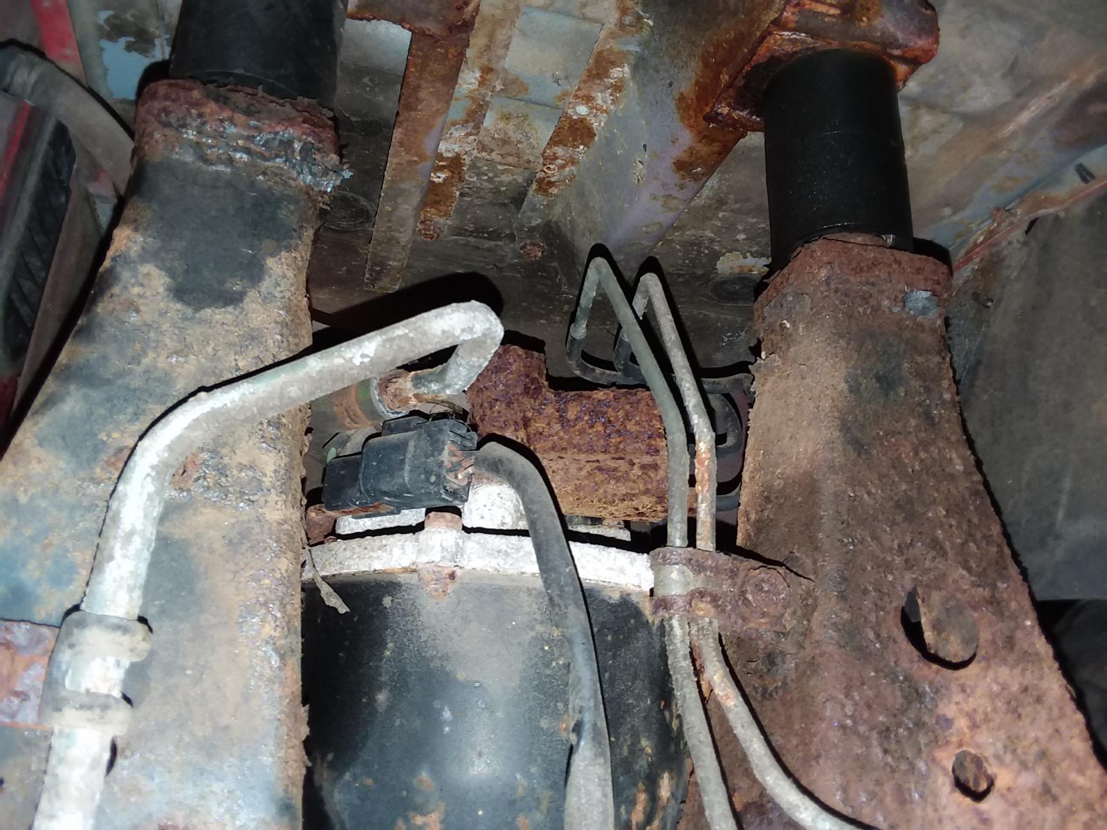

    heres the stuff i want to delete from underneath the truck, any reason why i should NOT???
  8. #58
    I think the rear bias brake proportioning valve has to stay. IIRC at least one or 2 members have had problems with their brakes after messing with these things (one was due to it failing outright and not being able to source a replacement unit) but this may be load proportioned - more load on it via the spring = more actuation of the brakes. Someone will chime in on this...
  9. #59
    03-02-2019
    166
    Connectisuck, New England
    1991 Mitsubishi L200
    i know what its there for, but i want all that extra shite gone...
    even if i gotta install an aftermarket bias valve, im thinking about ditching the mechanical e-brake and putting in
    a line lock or was even thinking about a stand-alone cylinder with its own resivor so its not reliant on the primary
    brake system & can actually be an emergency brake.

    I just don't know what this thing is. I'm leaning towards a vacuum tank to keep the booster & brakes harder if u stall out on a steep incline maybe, idk?????
  11. #61
    10-22-2015
    532
    Nevada
    Proportioning valve and the other looks like the rear ABS. I would at least keep the proportioning valve.
  12. #62
    Yeah the entire e-brake/hand brake assembly isn't exactly inspiring or beautiful. I'm considering going hydraulic e-brake/drift brake with a lever locker on it just to simplify the set up, something easy to mount between the seats on the trans tunnel...

    those are the bed mount towers coming up off the framerails, the black cylenders atop them
    are the 4inch lifts. that shot is from above the driveshaft looking to the right over the right-side
    framerail. ill take more pics soon.

    Charcoal canister?

    nope its not the charcoal can. thats up underneath the hood.
    heres sommore pictures of the mystery can and where it is:
    Attachment 22085 Attachment 22086 Attachment 22087
    Attachment 22084 Attachment 22088 Attachment 22089

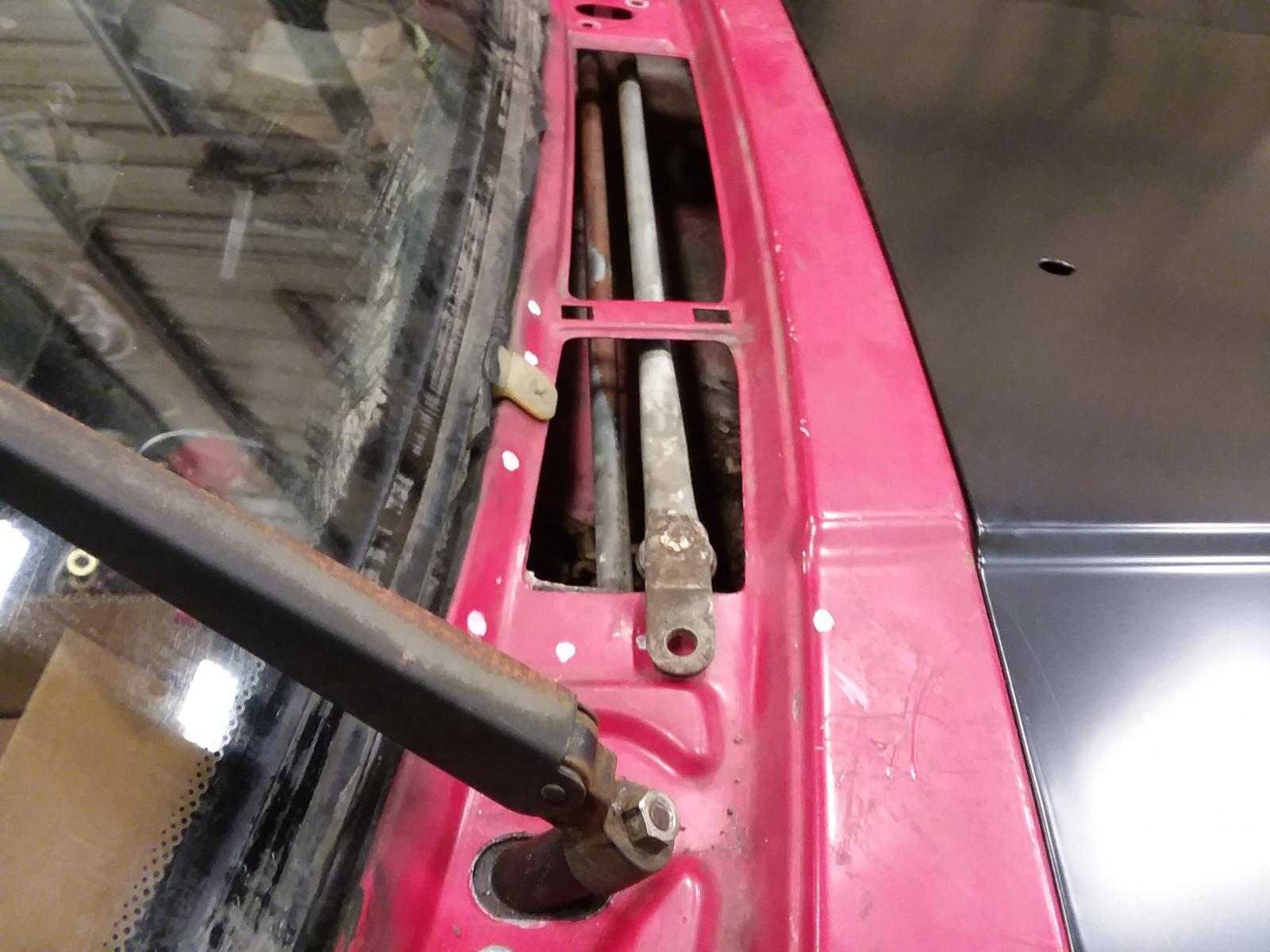

    heres where im at with the wipers. the linkage is mounted, but theres a tiny difference between
    the RHD & LHD linkage, i have to clock the end of the arm which bolts to the motor, see:
    need to get clocked 90 deg from 12 to like 3 or so.
    the wiper blade arms are also R/LHD specific, theres a wee little tweak that needs to go
    the other direction:
    and heres what they look like now:
    still need a little tweaking but theyre close. ive got it nextdoor tonight in the
    welding/body shoppe. gonna tryin get some firewall stuff welded in. hopefully
    weld in the wiper motor mount & fix the linkage. ill post up whatever i get done.
    gonna have a cup of tea and a schmoke & get to it. more pics in the wee hours

    IDK wat happened to the 1st mystery can post. mysterious.....
    try again
    realized theres a vacuum line that comes out of the top of this thing and into the rear right
    corner of the cab. im puzzled by this.:

    I had an idea to make my own wiper linkages using heim joints and threaded rods - however I have no idea if it would work... These linkages are getting old like the rest of the truck and IDT anyone will do through the effort to either reman these or find an off the shelf /newer assembly that is compatible.

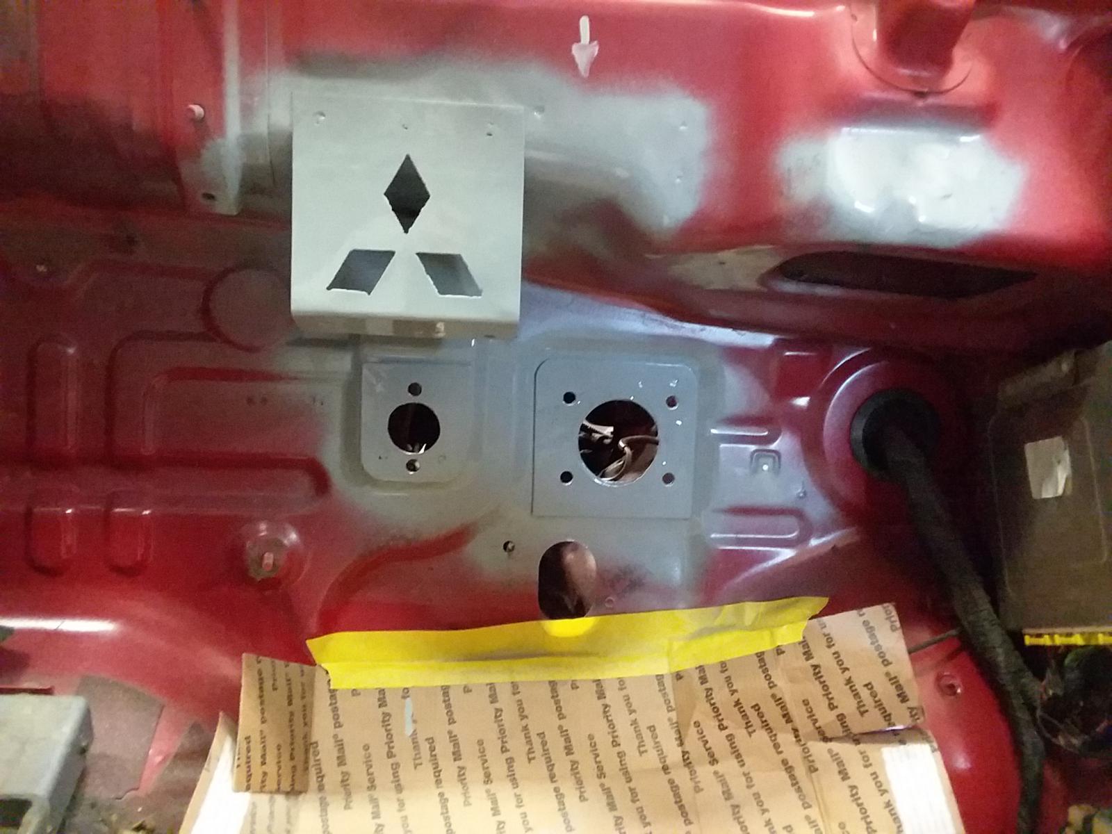

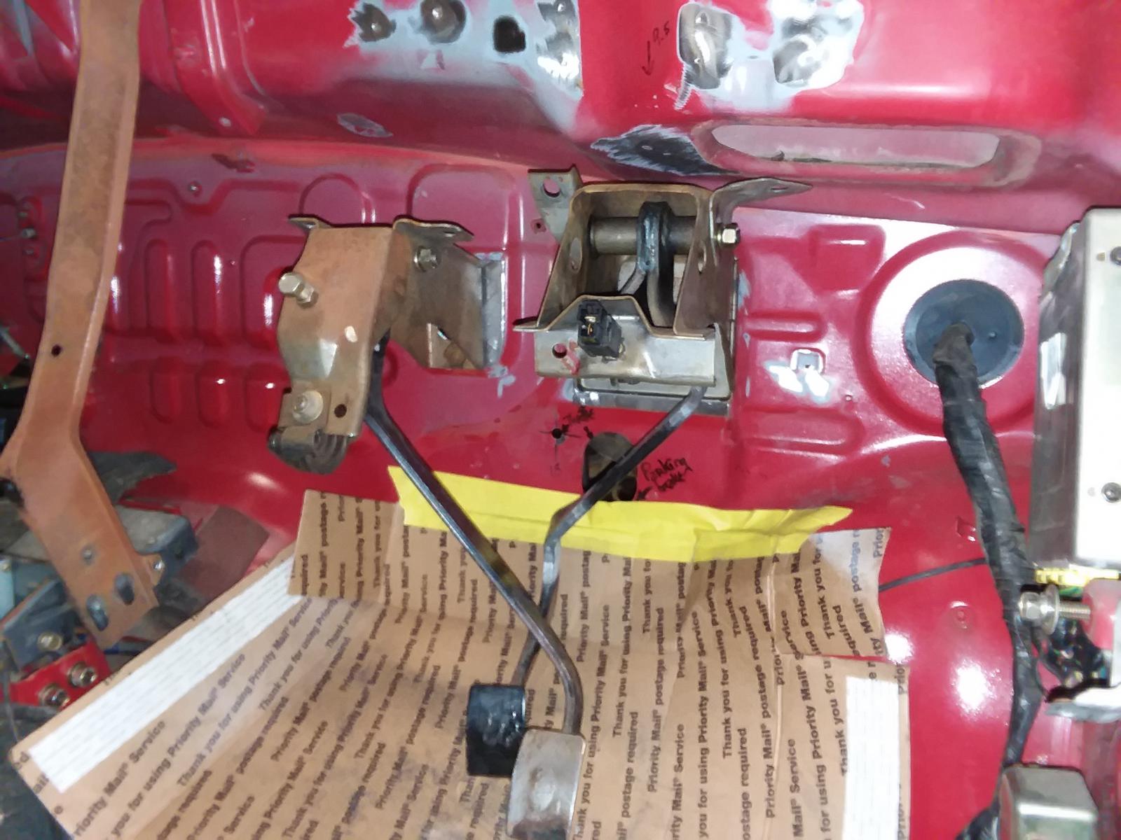

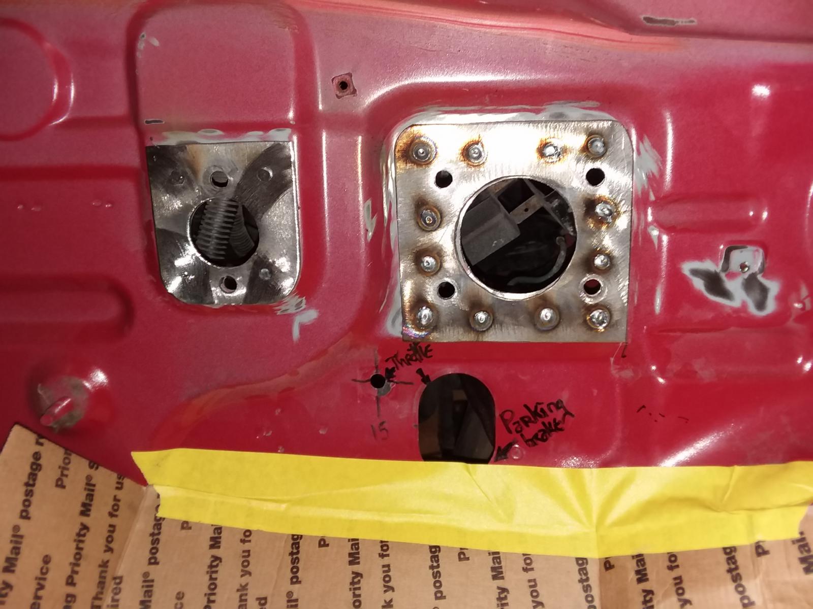

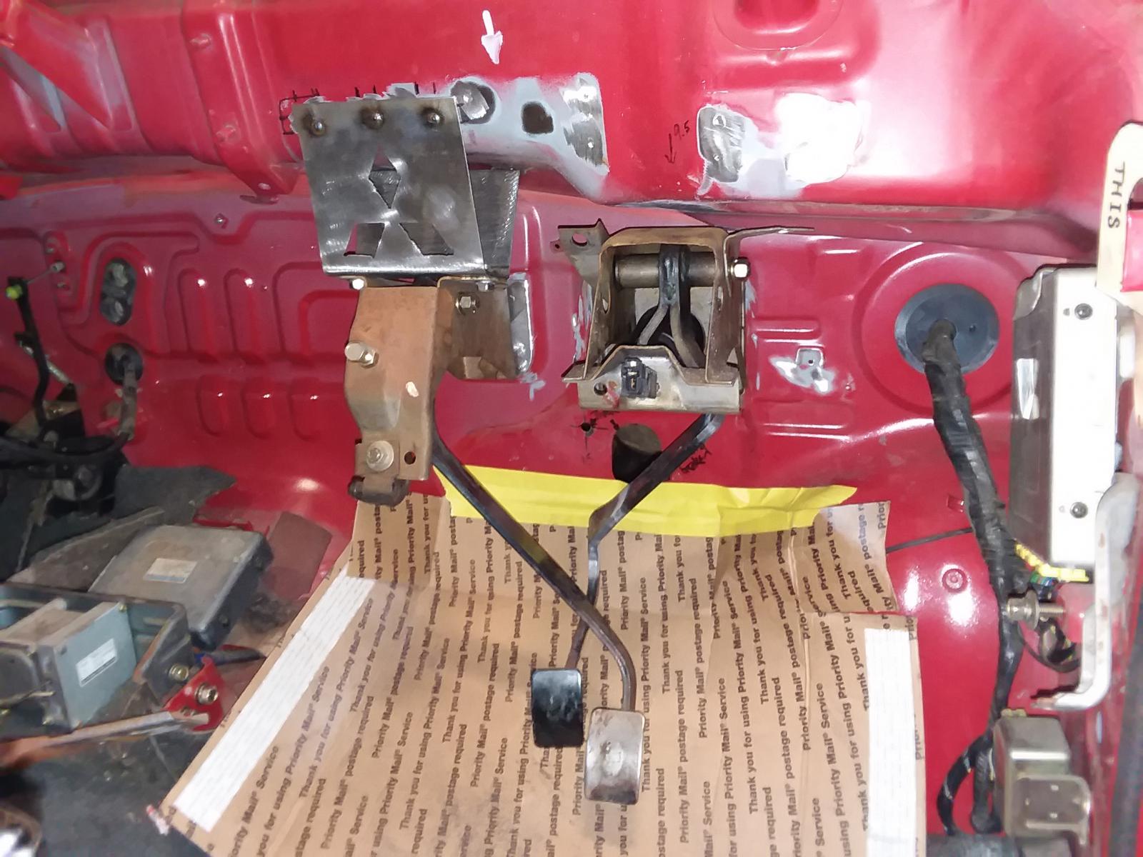

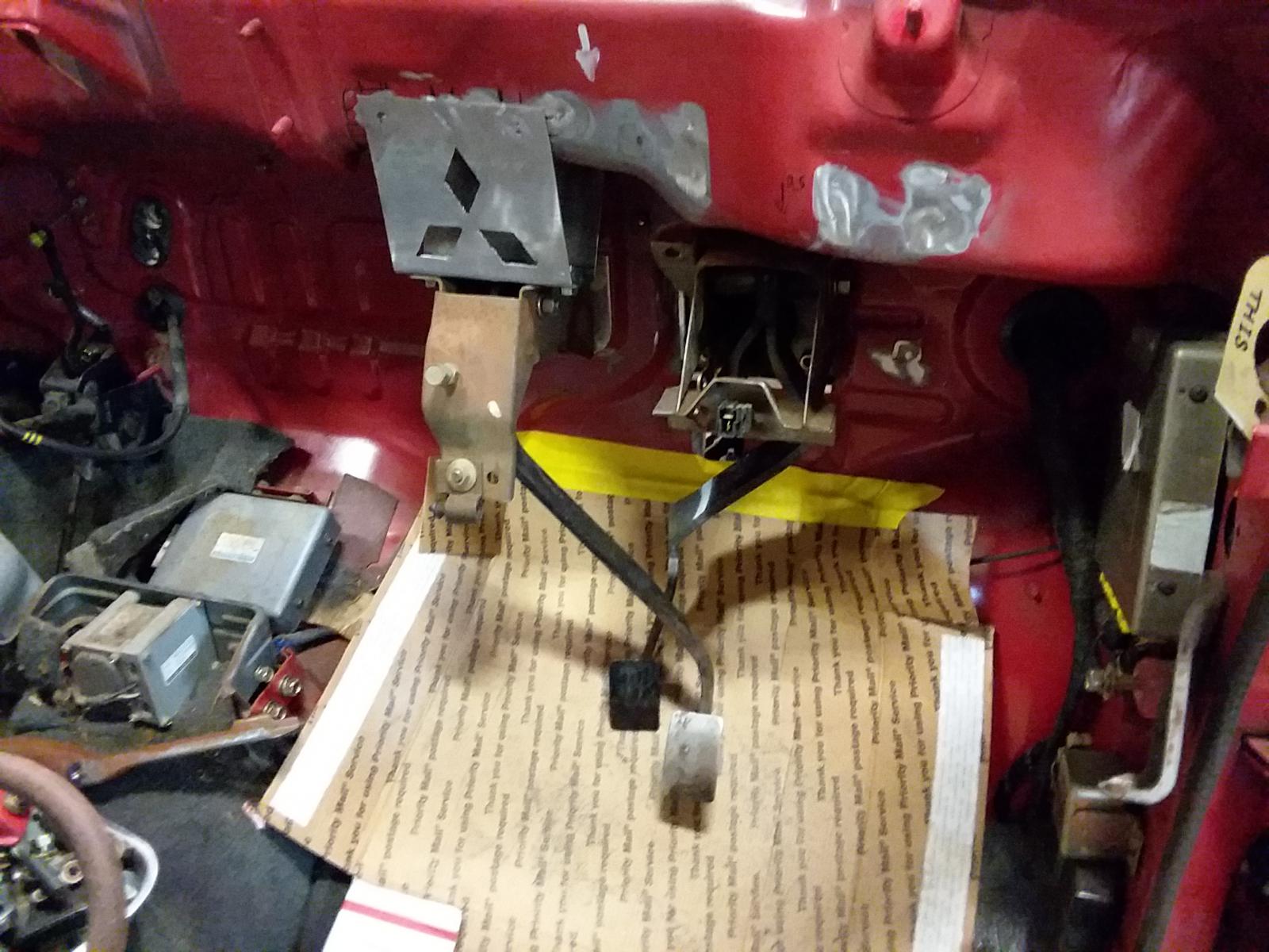

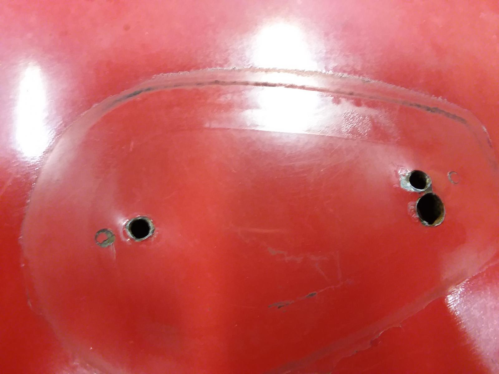

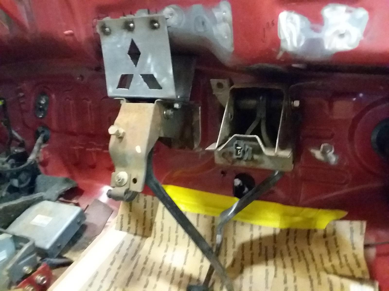

    i got the clutch & brake re-enforcement plates done and welded on the firewall. and pulled off the horrid clearance
    lights atop the cab, bunch of screw & wire holes to fill. PITA. have pics in few more hours.
    now onto the clutch support, wiper motor & linkage.

    so i pulled the BS clearance lights that some dumb shite drilled 3 holes x5 lights so x15
    holes in the paper thin roofskin. lots of body work up here:
    looks much much betterer.

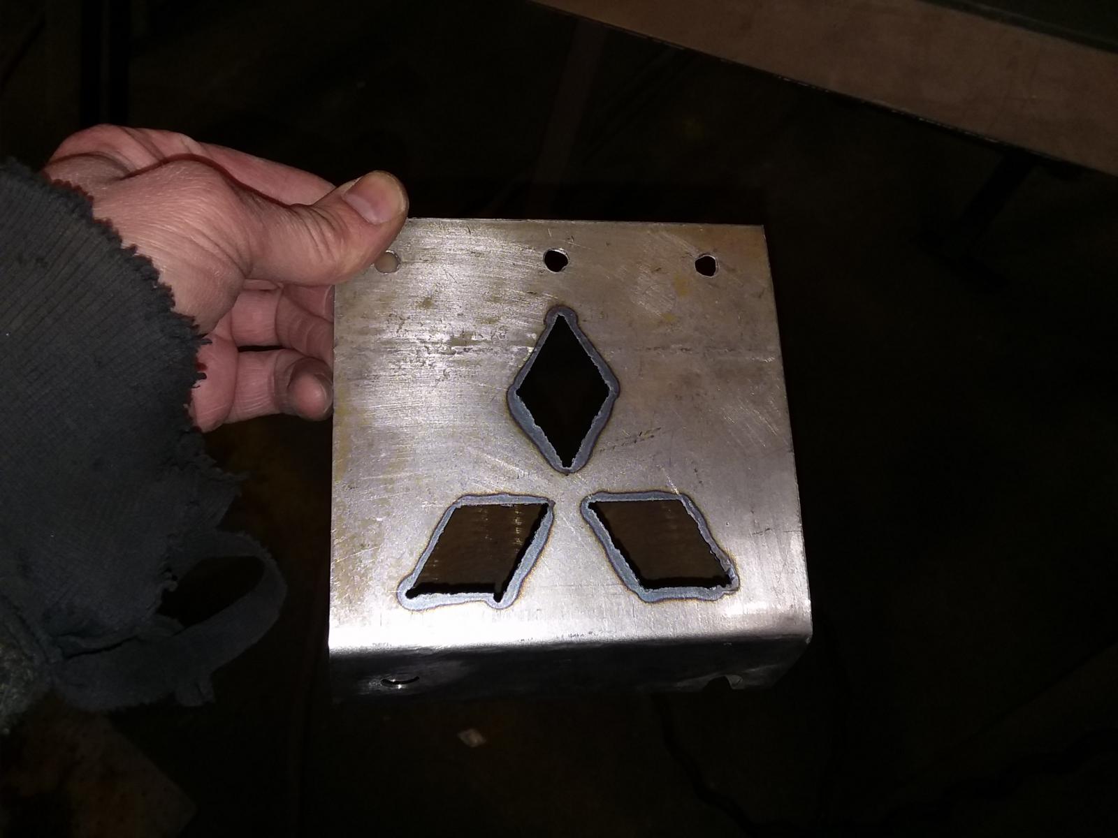

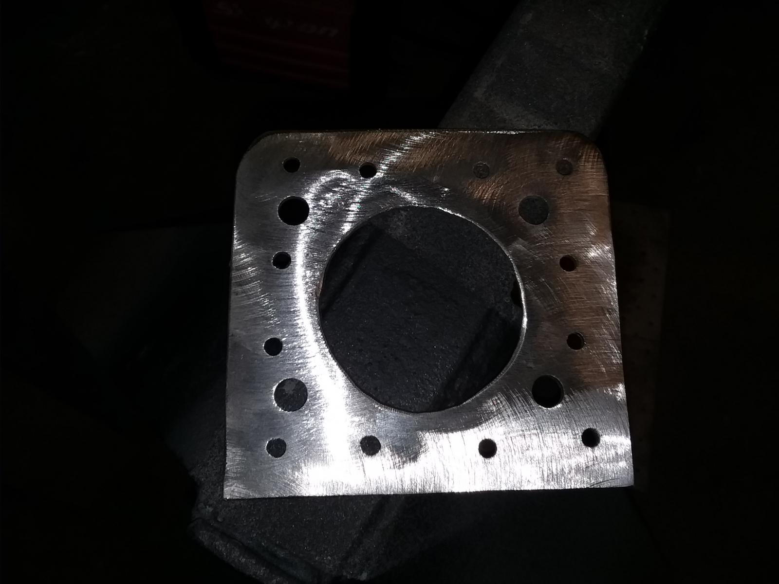

    Got the brake booster plate cut out and the mitsu logo too:
    And the plate re-enforcements and clutch support all welded in place, then a quick grind
    and some primer until i can prep the whole cab and paint the floors, firewall, and jams.
    i still need to make two bosses to bolt the tabs on top of the brake pedal assembly to, but i haft to wait
    until I patch the old blower motor intake hole, because one of the tabs is under that hole at present...
    i gotta go to an appointment at 9am, so im done for the night/morning. ill be back at it later on.
    hopefully that steering box shows up in the next few days. im ready for it.
