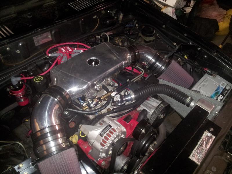

    I’m running a 97 4.3 Chevrolet with a TH-350 with a Edelbrock 500cfm carb.
    But this is coming to a end.

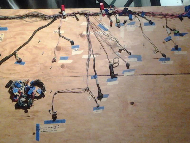

    This is my 97 S10 engine harness and we will be changing it to fit a 2002 blazer which uses a xxxx0411 pcm, they are tunable.
    Gm uses the VAT System, the “chipped key” which can be as they say, masked or shut off. More on this later.
    So with that said, if my attempt fails I can buy a custom Vortec v6 stand alone engine harness with a 4 wire hook up and turn key.
    Starting out I still need the stock configuration of the harness so I pegged to a piece of plywood and marked each and every wire. If I checked once I've checked it three times. Accuracy here counts.

    So here I have all my wires identified and triple checked starting to remove parts of the harness I’m not using, such as the VSS (vehicle speed sensor) or the clutch switch . On the lower left is the wiring pulled out and no longer being used. (there's more later).
    Next is the fuel injection harness.
    So yes, I am completely taking each and every mini harness out of the makings of a full harness. (We have ZERO room for mistakes).

    I do believe pegging the harness to plywood helped me out a lot and I can see this wiring could make one feel overwhelmed.
    I didn't have to extend any the fuel injection wires. Going in a different direction with the Cam and MAF sensor harness had about a foot of extra wire, they share a keyed 12v source that I cut (behind the distributor) then I'll extend it. The coil and ignition control module wires where long also.
    Seeing a bunch of wires and knowing each is circuit puts that overwhelmed feeling at at ease.
    The pink wires are the keyed hot 12 volt, the pinks will end up on 4 circuits, each on a fuse. I still need to make the two hO2 sensors harness.

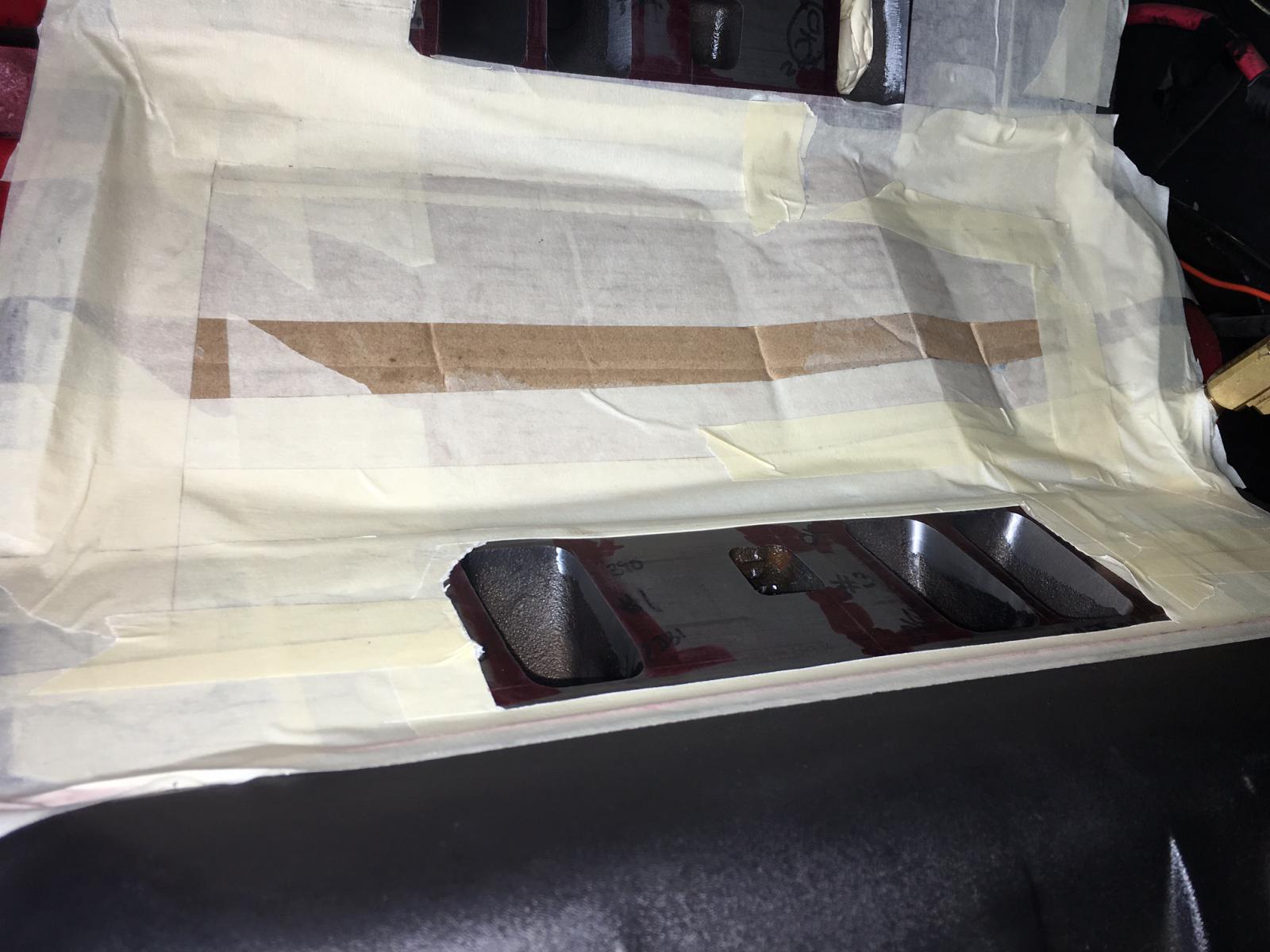

    Head to intake
    Head to intake miss match. Some good some bad. I am going match the ports. I circled the H for head or I for the intake where the shaving work that need done. This wasn't in my plan at all.
    Quote Originally Posted by Rickdees View Post
    Might not have been in your plan but it still would've been a good idea from the get go. It will help flow and that has to be a good thing.
    Yes sir, it no doubt it has to be helpful. I never did checked the edelbrock I took off, but now I'm way past that. I have no regrets doing this now.
    This went down like surgery or like being at the dentist since the heads are on the engine. (Crazy)
    So I caught myself with some readings but that's why I check it twice then check it again. I stuffed rags in the ports pack it tape it mulitlpe layers then sealed the tape edge with some vasoline. I missed one cut so this picture I had to cover up again.
    I laid out and plotted off the bolt pattern on the head and intake working off of center. I still have small cuts to do on the intake.
    Two days to do this but doing it correct. I am beat.
    Here are my old and new injectors, the ones in the fuel rail are the new ones and they came with the smaller black o-ring at the base of the injector, the older ones (but still new) had the red o-ring at the base which both are to be seated deep into the intake. The new ones didn't fit and were lose so I switched the red o-ring on the upper o-ring grove on the new injector which made them seat on top of the intake nice and tight, which is also machined at a taper.
    These both have bump stops on the injector, the old ones the stop is at the base hitting the intake and the new are at the top hitting and stopping on the fuel rail.
