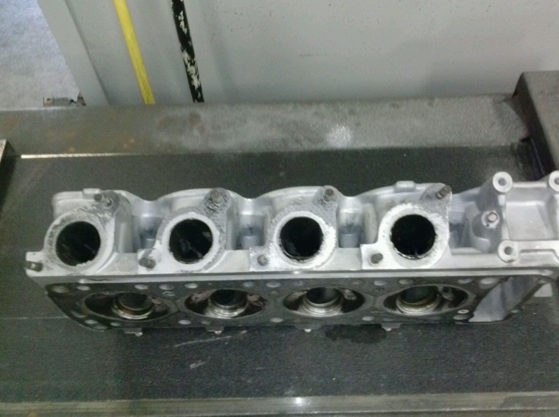

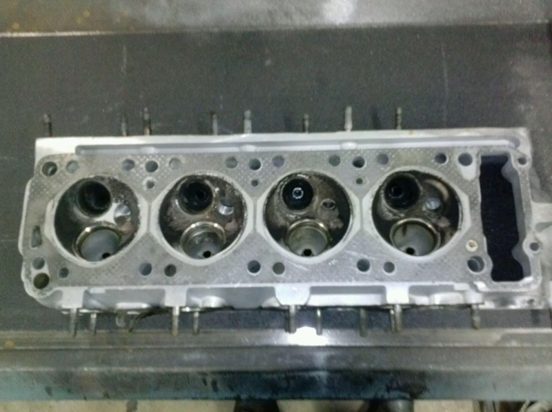

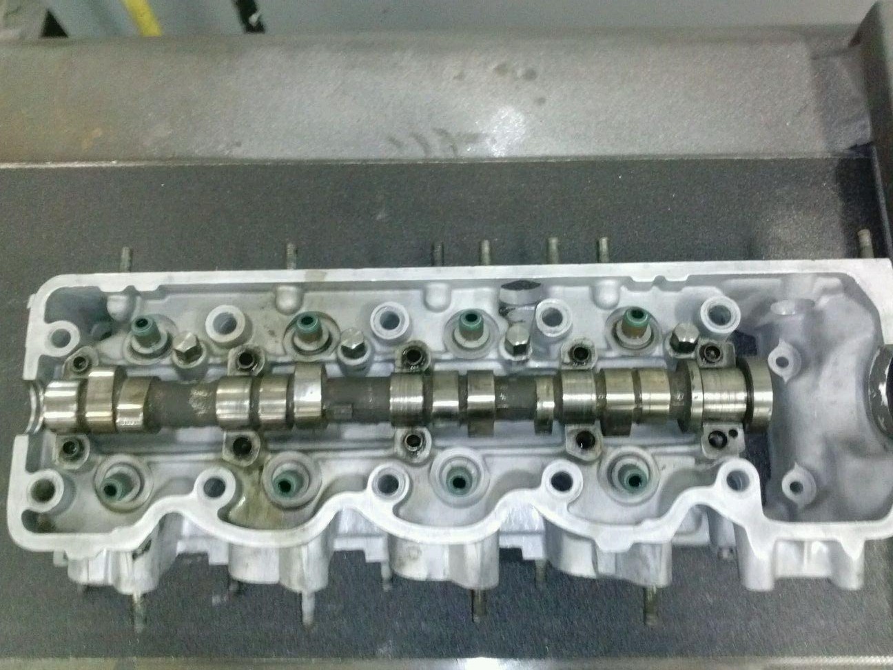

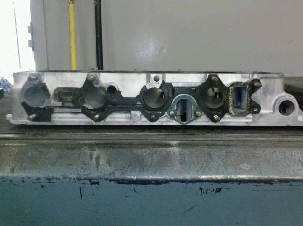

    My father and i are in the process of rebuilding the engine in our 1981 D-50. Unfortunately, we found that the head was cracked out beyond repair...As well as every other head our local auto parts stores can come across. Autozone's website suggest they have quite a few of the correct heads from Surefire, Moore's and American Cylinder Heads, however Autozone's representatives say that they're not actually available anymore despite what the website says.
    Also, given that we live in California, smog requirements are very stringent making an engine swap, or excessive modification, or deletion of any smog equipment with the exception of the jet valves nearly impossible (to my understanding of current smog regulations).
    So, we're sunk.
    Would you guys happen to know where we could find a good condition complete head assembly or core for our truck? Would it be possible to use a 2.6 head on the 2.0 if we absolutely had to?

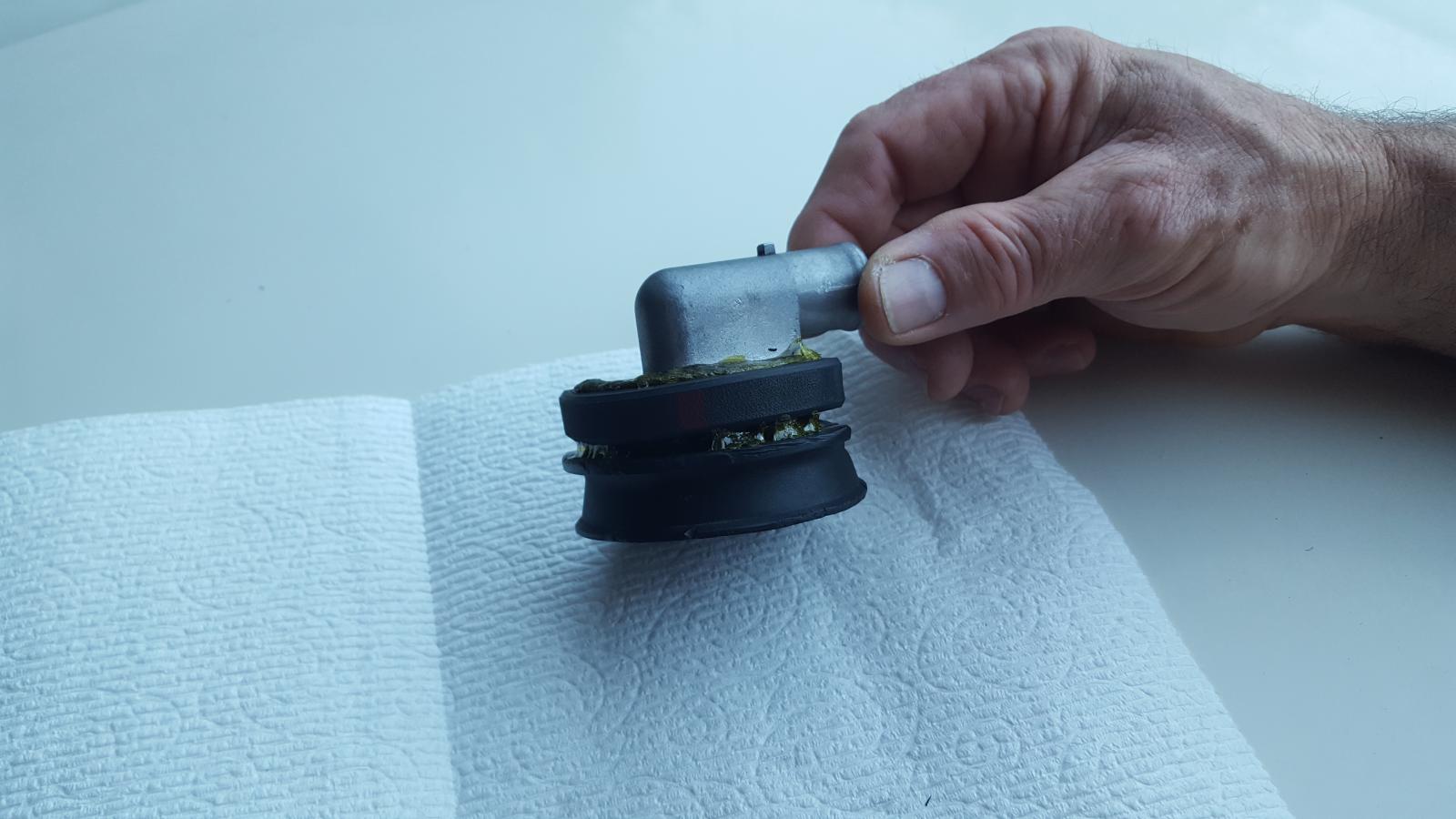

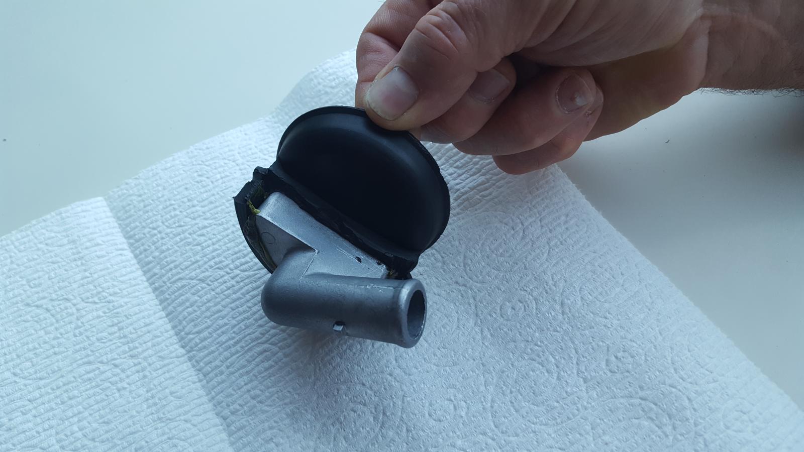

    We're also looking for another cylinder head breather grommet. The rubber peeled apart when trying to remove it. A local auto parts store tried to hokie something together, but we'd much rather have a proper condition one if possible.

    try these guys http://www.ramscyl.com/index5.htm They accept broken heads as core. I used them for my 2.0 and they were great, very helpful.

    You can swap a 2.6 head on a 2.0 IF it is from a 79 - 81 2.6 from a truck - it will drop the compression 1/2 point. The hot trick in the early days was to use the 2.0 head on the 2.6 to raise the compression 1/2 to 1 point. You may have to get a rubber molding kit from Eastwood to remake that grommet. I have a spare 2.6 head from an 80 or 81 truck, but I haven't looked at it in a while to see if it is any good. If you go for the non jet valve heads, you will have to get a newer intake manifold, as the bolt pattern is totally different, and it would probably fail Cali visual inspection.

    Thank you pennyman and 85Ram50. We sent our damaged head off to Rams Cylinder Heads and Ivan sounds extremely confident that he can repair it.

    Wasn't until I sent Steve at Top-End Performance in California some pictures of my head that we discovered my head is a 2.0 G52B Chain Drive Jet-Valve head. My truck has the under hood labels for the 2.6 G54B engine. I am not concerned with gaining any compression so am open to going with either head as long as we can find the correct valve cover to go with the head as the 2.0 and 2.6 do not share a valve cover from what I have been able to find. If I have to stay with the jet-valve head, then I will get the block off kit. I just want the thing to run reliably. I didn't buy it to sit in my driveway taunting me....
    Any help from you all would be greatly appreciated, as I have wasted the better part of a day at work trying to locate some parts.
    I have the valve cover you need for the head you have. I also have an early 2.6 head that is in unknown condition sitting in my Ex-wifes garage that I can get and look at it to see if it is any good. AS I look at your head, it has the jet valve eliminators already installed. Let me know if you want me to check the head out.
