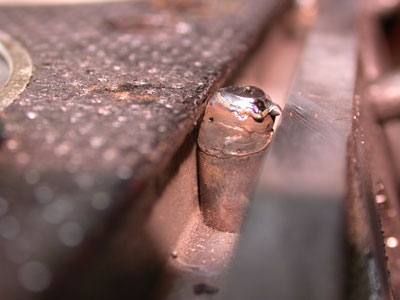

    On with for the repair. How to fix the problem of the holes in the heads. To fill the holes I used some tapered drive pins.
    I cut them down so there would be less to remove inside the exhaust port with the die grinder later. I then cut down the fat end and checked the fit. I wanted them stick out of the head just a little after setting then in with a hammer. I want them to protrude above the head surface somewhere around .080 of an inch.
    With them sticking out of the head just slightly it makes them self-drive into the hole after the head is installed, locking them in place by the block.
    There is no way they can fall out or come loose. I ground the pins down inside the port after tapping them into place.
    After setting the head and torque down the studs I could check to see if my idea had worked. If all goes well then they should drive into the exhaust port just a few thousands. Here is what it looks like after installation. Then just grind off the last bit and there plugged.
