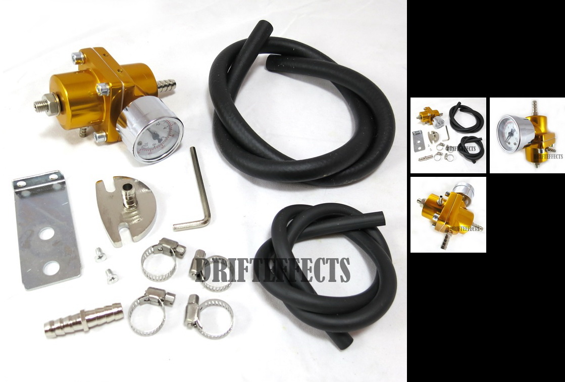

    any thoughts on this i got myfuel pressure regulator in today was wondering where to mount it? i was thinking on the wheel well across from the carb/fuel pump i,m figuring the shorter the distance the better .
    the fuel pressure regulator i got was the one that pennyman1 suggested

    i called quick fuel tec support and they told me that the distance i,m going was fine no worries.
    so if anyone else is thinking of going that distance then maybe this helps.

    lol forgot to post how far i,m going with it from fuel pump manual pump to wheel well 2.3 ft and then the return line to the weber carb 2.5 ft

    thought i would give an update on the carb: installed the low pressure regulator on the wheel well about 2.3 ft from the manual pump and the return line about 2ft to the carb everything seems to be running great so far i did have to readjust the carb a bit it was dieseling on shut off . the loctight seems to be working the carb is still sitting solid.
