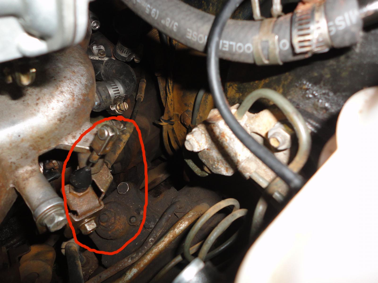

    here is a few pics to give you an ideal of what i,m talking about

    ok thxs for the info now for the $1000 question just what does it do? the cable i mean
    it is the throttle position cable for the tranny - it tells the transmission how to shift by how much the gas pedal is depressed. If you don't hook it up and drive it a lot, you can damage the transmission. The u shaped bracket in the picture is the auto tranny kickdown lever.
