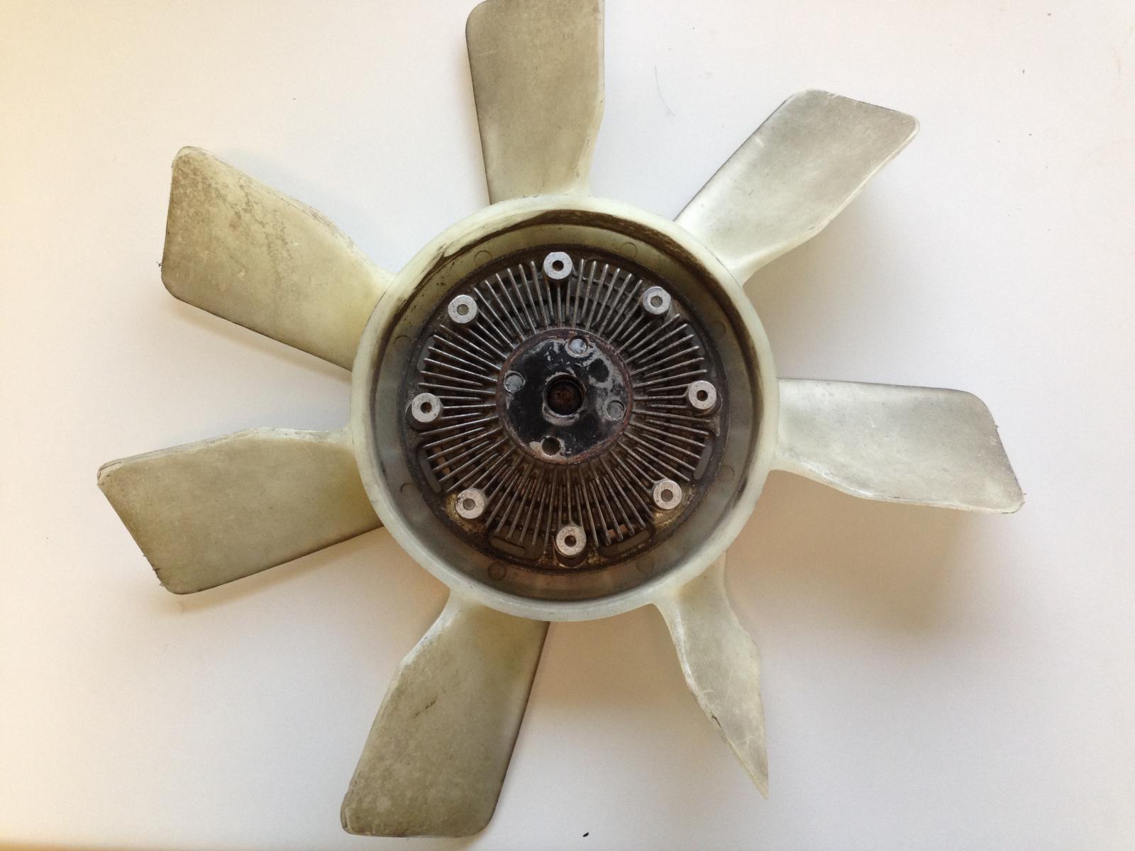

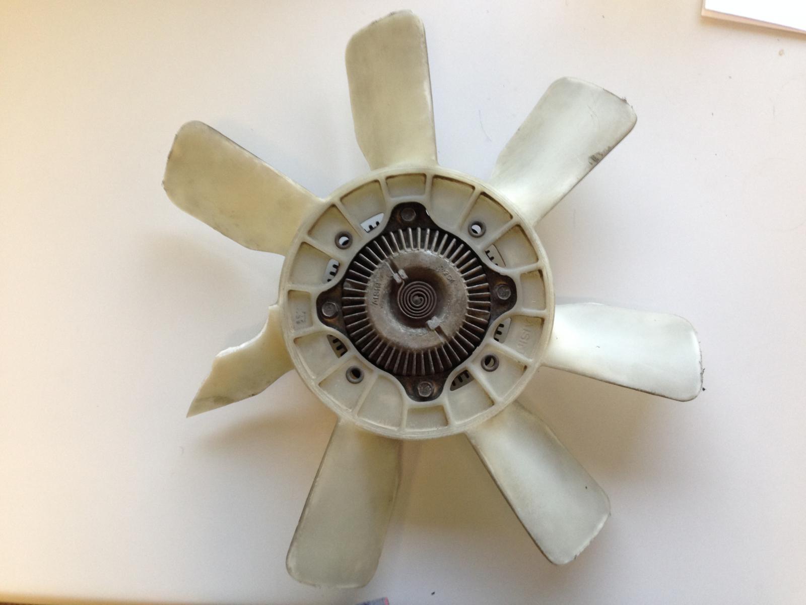

    Hey I'm looking to replace my fan blade on my 1st gen 2.6 liter D50. Having trouble finding an OG replacement. I'm thinking about ordering a Flex-a-lite 5715 5700 Series Clutch Fan 15 in diameter.
    Has anybody used this part/know if its a good fit? or know of any other good replacement fan blades? Thanks

    An electric thermo fan will have a number of advantages over the mechanical clutch fan. Keeps the engine cool when it needs it (like stuck in traffic on a stinker of a day), takes the load off the engine (these things rob power and response) and prolongs the life of your water pump bearings. Plus they can be front mounted to free up engine bay room. The newer type of slimline fans run rings around the mechanical fans and old 4 blade electric thermo fans for efficiency, are very reasonably priced and are super reliable. Might be time for an upgrade?

    Hmmm, something to consider indeed. Whats the process for capping where the fan clutch used to be?
    1,511
    All you need to do is maybe add some washers under the nuts(can't remember If it has studs there or bolts) to take up some space where the fan body used to sit so the water pump pulley is still secured tight. Nothing tricky about it just make sure the water pump pulley will stay where it needs to be on the waterpump shaft.
