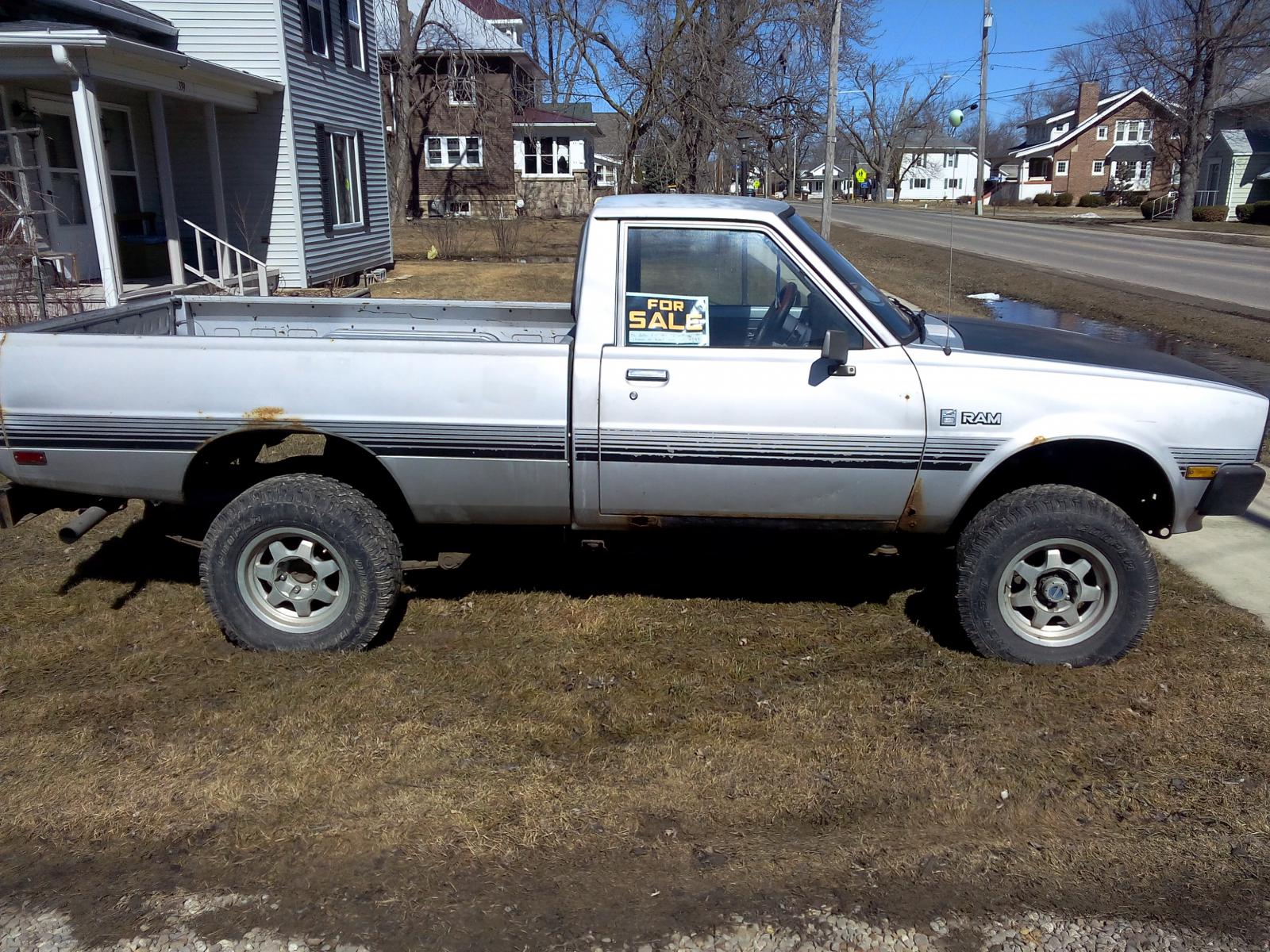

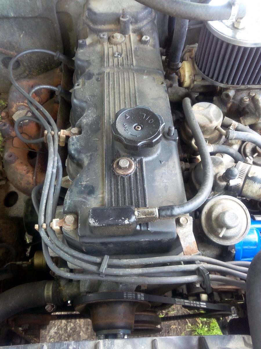

    Hey all I bought a Frankenstein of a D50 a few months ago and finally have the money to start fixing her up. I have a few questions and I'm not exactly sure where to post this. It's a 84 body on a 86 frame and the guy said that it has the 2.6 motor but under the hood says that it's the 2.0 G63B is there an easy way to ID which it is?
    Anyhoo, the main question I have for you guys is that the guy I bought it from said that it has 462 axles and was running 35 inch tires on it. It came with 30 inch tires but they are junk. I'm not sure where I need to be tire size wise for optimal gear ratios. At 55 in 5th I'm running at 2.6k and the speedo reads about 61 MPH. I'm only getting about 14 MPH and I have the Weber carb so somethings up. I figured the gear ratios would be a good place to start.

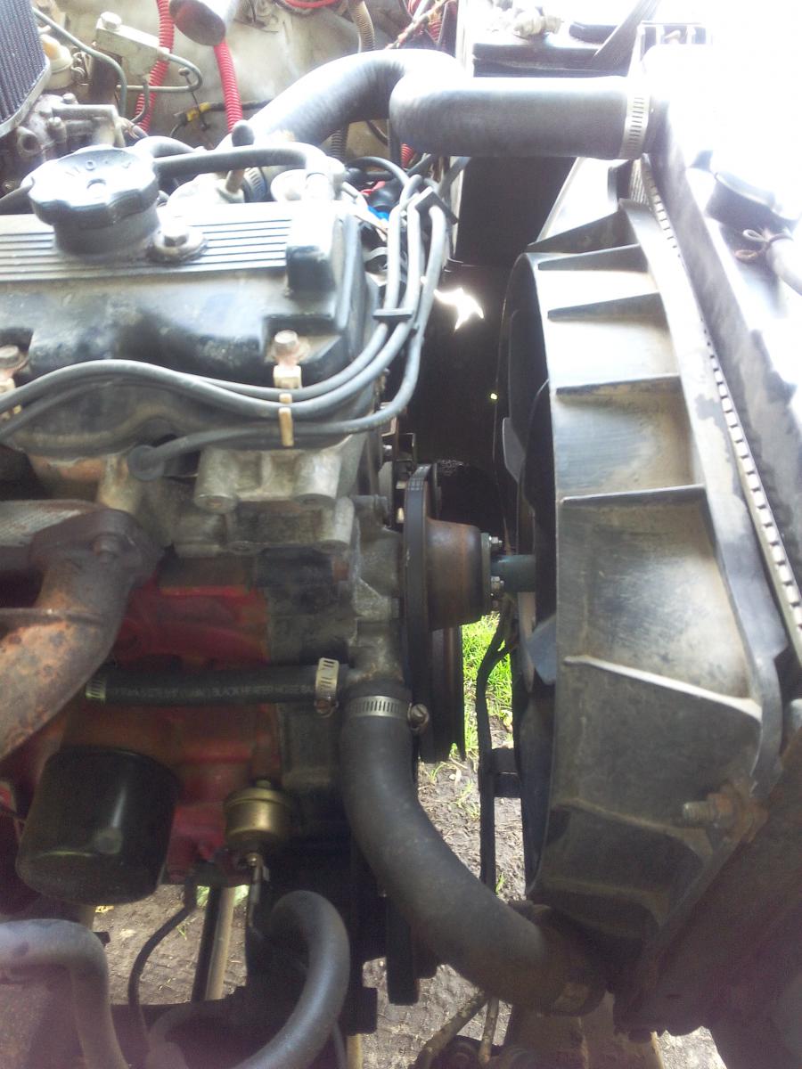

    to determine which engine you got at a glance, look at the front on the motor, if the timing cover is black plastic, then it's a 2.0 g63B; if metal, it should be a 2.6. 4.62 gears are very desirable for large tires, but not for stock sizes. It should also make 1st gear useless. Post an underhood pic so we can be sure of what motor you got.

    Looks like It's a 2.2 . That would explain why the distributor cap I bought off of rock auto doesn't fit lol.
    no its a 2.6 - you also need to hookup the vacuum advance to the weber carb - it goes to a fitting on the side of the carb above the throttle plates.

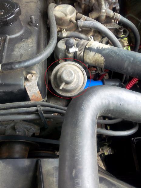

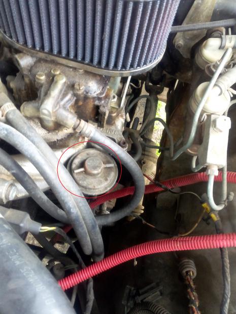

    Sorry about that. I meant 2.6! So I'm going to hook up thisd50pic1.jpg and put it on this?d50pic2.jpg

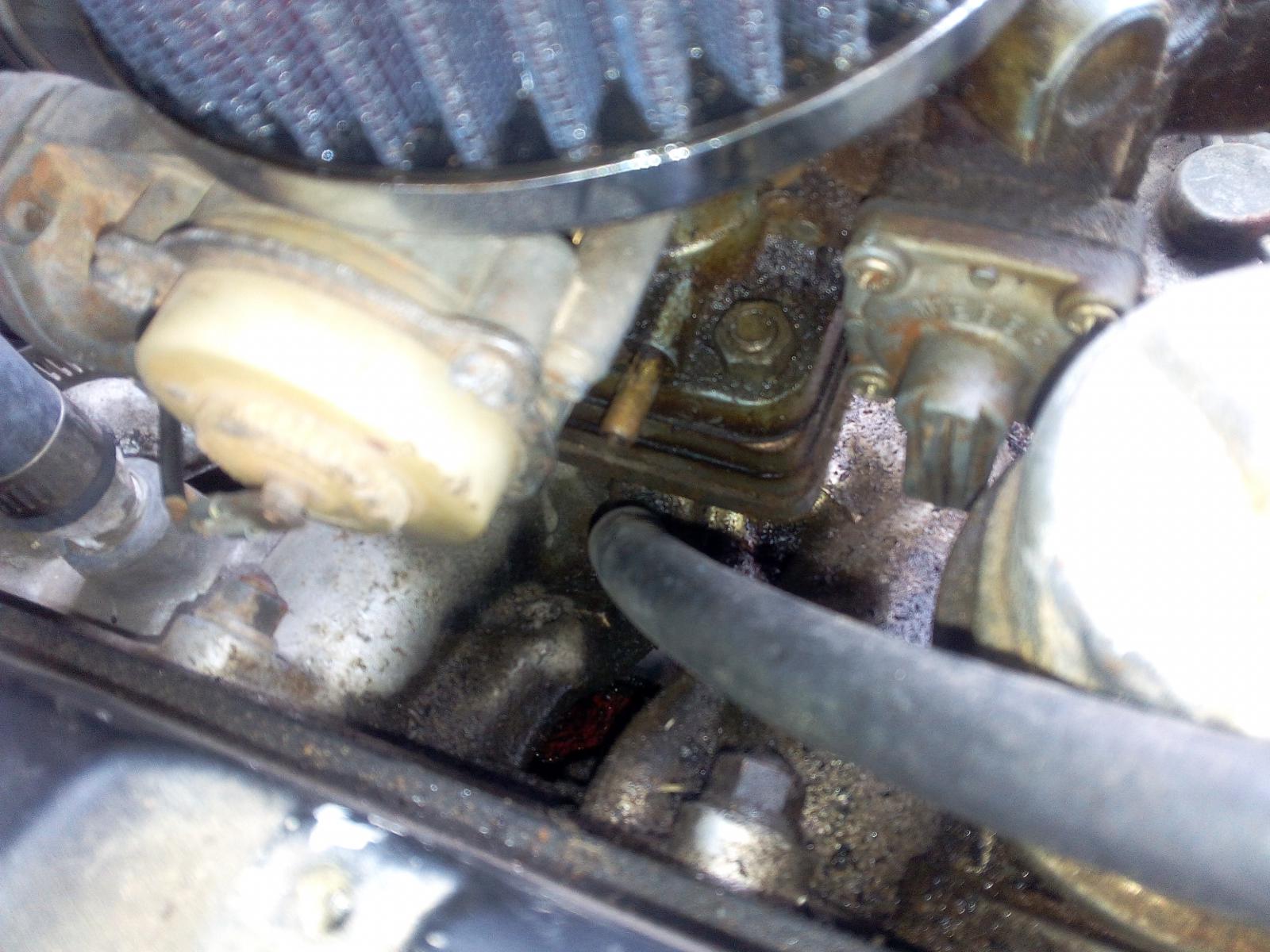

    I think I found it. Its not what I posted earlier. It's directly on the carb and has a cap on it. What size tube do I need? Sorry for being so new to all of this.
    1/8th inch vacuum hose

    Just to confirm, This is what I'm hooking up for the vacuum advance on the carb right? 2015-07-01 12.41.12.jpgIt's not 1/8 inch.

    Good looking truck! I love the first generations!!!
    This is from BradMPH's thread called "Rebuild, replace, refresh" or something like that of his prized "Mitsy"
    Here's the link to his whole build.
    http://www.mightyram50.net/vbulletin...ighlight=mitsy
