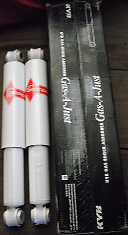

    Put these in the other day, the old rear shocks were trashed.

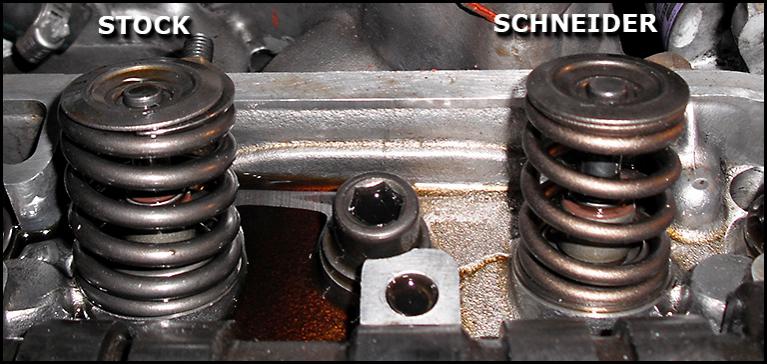

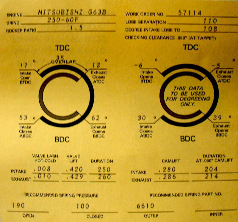

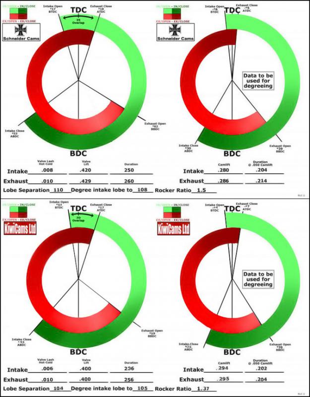

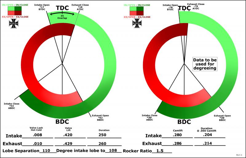

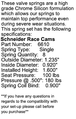

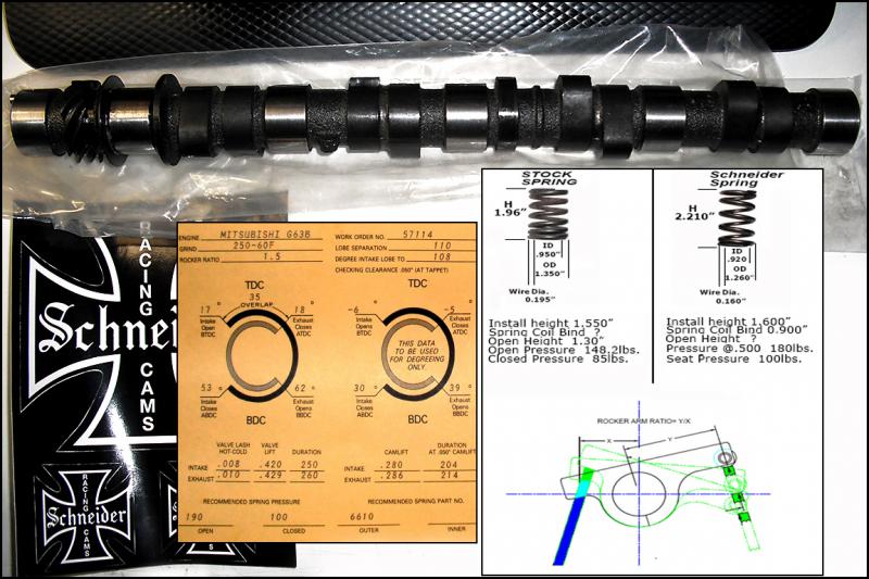

    The Cam came in today and the springs.
    Looking at the Cam card is a little complicated in that I hope that the new springs will fit correctly and things match up the way they should. I put some numbers down on this post and if anyone has any early warning advice to give before I take the head apart, don't hesitate to post. The head will stay on the block, but the valve springs will be changed out. My main concern is that the springs will be working in their correct ranges. But, most of all...how should I start out the timing setup for this thing? What would be the best method of attack on making the timing adjustments? I do see on the card that my rocker adjustment changed a bit on intake by .002, but I don't see a timing mark setup. I guess to start out at the factory and begin pushing towards TDC as close as possible until it runs best.
    Anyway, I hope to maybe get a start on it tomorrow afternoon or early evening if I feel up to it.
    If you Cam guys can decipher the cam card, let me know what you feel about it.

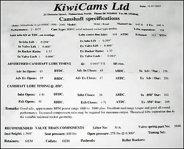

    Here is a (mild grind) CAM grind I found ......................Below is a comparison between these two cam grinds.
    online that an Aussy posted for his rebuild g63. I thought I would post it for
    maybe someone who might want it

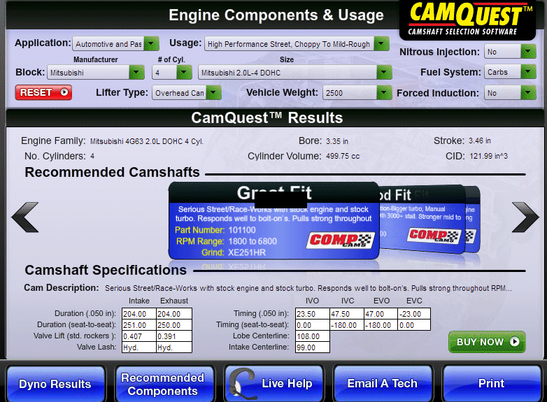

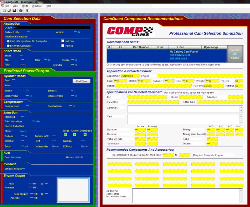

    Download Full Version Program for Configuring Cam Grinding Specs.
    CamQuest6.zip
    Desktop Version Only Supports the Mitsubishi 2.0L Cam
    Here is an Online Cam Grind Configuration Program
    http://www.camquest.com/

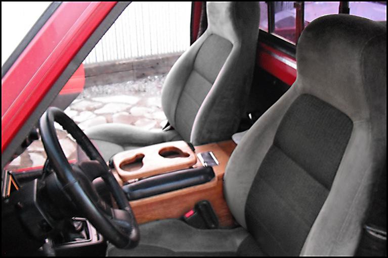

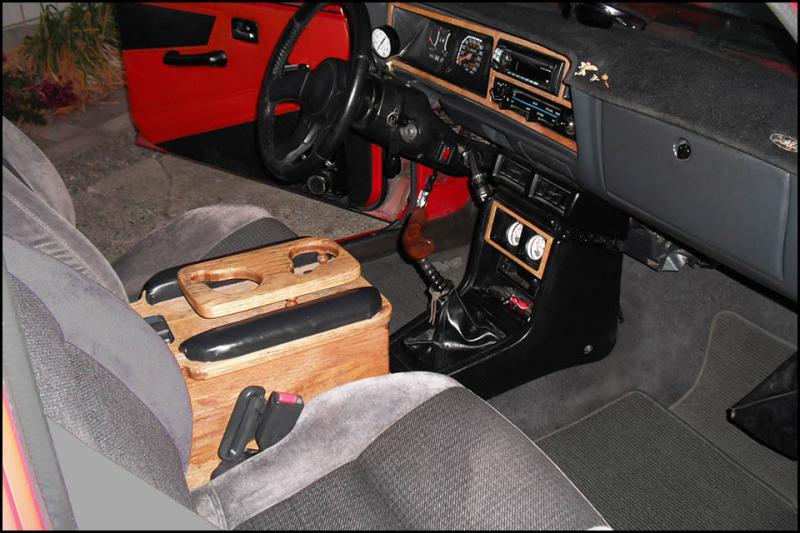

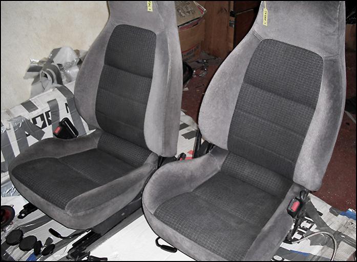

    While I was there the other day, I picked up these Eclipse seats for $17 for the pair. These are going into the truck ASAP.

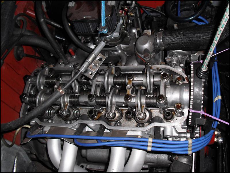

    I did some searching concerning the Camshaft installation for a G63B SOHC. I know that there is not a terrible amount of performance to gain from the SOHC but, there is some to find. The most valuable change would be to time the distributor advance to the cam. So, I did some looking around and located some pretty good information about timing the advance of the dizzy. I also located some information on installing the Cam into a SOHC Mitsubishi motor if anyone is interested. I'll upload the information and you can download it here below.
    Cam&Gear_Install.zip
  6. #81

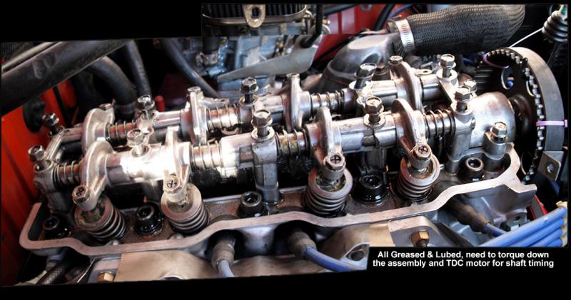

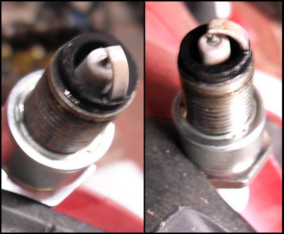

    Started the installation of the cam, springs, and bucket seats tonight. Checked the spark plugs for the first time since the rebuild. Here are some images.
    I am surprised how well the Schneider springs fit and they measured perfectly for height. I hope they help to quiet down the tappets, but this sound is normal for the non-hydraulic version of rockers. Valve lash has been reduced per cam recommendations by Schneider Cams. I have also been resourcing the modification of the distributor advance. The stock advance will not benefit the motor anymore and I will probably have to install the Chevy HEI vacuum advance into my dizzy to enhance the new cam.
    The plugs look a little lean, I'll give it a turn to richen it up when I finish installing this stuff.
    I am very happy with this ceramic header paint that I used also. The paint is remarkable so far and has not shown any type of heat problems at all.

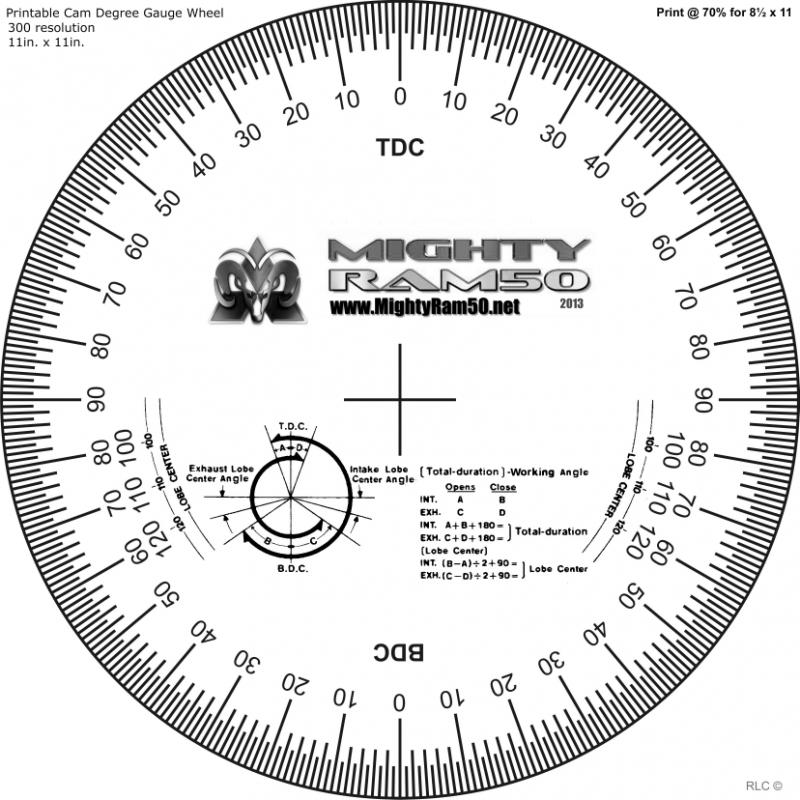

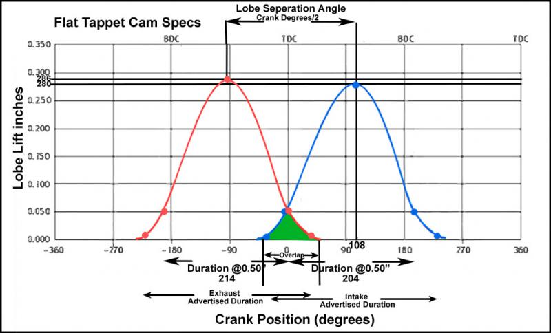

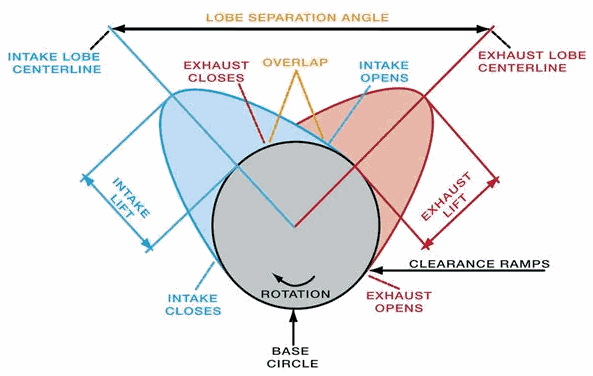

    Created a little more visual animation so the cam timing can sink into my deteriorating northern hemisphere. Going to head to the auto parts store and get a magnetic dial indicator. I probably can make the wheel myself, if I can't find one for under $60. I have a few spare pulleys I can create some that will work.
    (click image for full size)
    PRINTABLE DEGREE WHEELS
    (mount to a round metal plate)
    Download - MightyRam50 Wheel
    MightyRam50_DegreeWheel.zip
    Download - 2 Izzy Degree Wheels
    Timing_Degree_Wheels.zip
    For figuring out your cam timing events, here are the equations.
    CAMSHAFT SPECS FORMULAS
    1. Intake Duration (ID) IO +180 + IC degrees
    2. Exhaust Duration (ED) EO + 180 + EC degrees
    3. Intake Center Line (ICL) ID/2 - IO degrees ATDC
    4. Exhaust Center Line (ECL) ED/2 - EC degrees BTDC
    5. Lobe Separation Angle (LSA) ICL/2 + ECL/2 degrees
    6. Lobe Separation Angle (LSA) (ICL + ECL)/2 degrees
    7. Valve overlap IO + EC degrees
    8. Valve overlap (ID + ED)/2 - LSA degrees
    9. Intake Opening (IO) ID/2 - ICL BTDC
    10. Intake Closing (IC) ID - 180 - IO ABDC
    11. Exhaust Closing (EC) ED/2 - ECL ATDC
    12. Exhaust Opening (EO) ED - 180 - EC BBDC
    _________________________________________
    Lobe Lift
    Refers to the distance, measured in thousandths of an inch, that the lobe of the cam is raised from the base circle of the cam. Increasing valve lift allows more air/fuel mixture to enter the cylinders and more exhaust to exit, which generally leads to an increase in engine performance. An increase in lift almost always leads to an increase in duration because increasing lobe lift requires more distance to create the opening and closing "ramps" on the lobe. However, today's computer-designed, asymmetrical profile cams have a high acceleration opening ramp, while the closing side sets the valve down softly, helping longevity.
    Valve Lift
    Refers to the distance, measured in thousandths of an inch, that the valve is lifted off its seat at the cam lobe's highest point. Remember, the cam's rotary motion is converted to linear motion thru a lifter, pushrod, and finally a rocker arm. Therefore, valve lift equals lobe lift multiplied by the rocker arm ratio.
    Lifters
    A cam lifter, aka a follower, aka a tappet, makes direct contact with the cam lobes and follows the contour, or profile, of the cam.
    Types of lifters:
    Hydraulic flat-tappet
    This type of lifter is self-adjusting, thanks to a valve-controlled plunger inside its lifter body. engine oil pressure maintains preload against the pushrod, and since no lash allowance is needed, they run quieter than mechanical lifters. On the other hand, they can perform poorly at high rpm due to an inability to bleed down excessive oil pressure
    Solid (Mechanical) flat-tappet
    Essentially a solid link between the cam lobe and the pushrod. Allows for greater rpm potential, since bleed-down is not a concern, but do require that lash, or clearance, be set between the valve and rocker arm to allow for expansion as the engine gets hotter.
    Mechanical roller-tappet
    Allows for the most aggressive lobe designs, due to the roller follower, and lends itself to high rpm operation, since it's a solid body design. Like a solid flat tappet lifter, it requires a lash setting that must be readjusted over time.
    Hydraulic roller-tappet
    Allows for aggressive lobe designs along with self-adjustability and quiet operation. They can, however, also suffer from bleed-down at high rpm.
    One of the roller cam's greatest advantages is that rolling frictional forces are less than those caused by the "sliding" of a flat-tappet cam, which frees up some power. In general, roller-tappet profiles can be more aggressive for a given duration. On the other hand, a flat-tappet cam actually accelerates the lifter more quickly in the initial portion of the lift curve. With a short-duration cam, a flat-tappet cam can actually get to a higher lift faster than a roller cam.
    Duration
    As lift refers to how far a valve opens, duration refers to how long it stays open. The opening time is expressed in degrees of crankshaft rotation, so a cam spec to 230* duration means the valve is being held open for 230* of crankshaft rotation.
    Usually referred to by two types of duration
    Advertised Duration
    The number of crankshaft degrees that the cam follower is lifted more than a predetermined amount off its seat. the SAE standard is 0.006 inch. So advertised duration is the number of crankshaft degrees that the valve is open at least 0.006 inch.
    ***Not all manufacturers use SAE standard***
    Duration at 0.050 inch
    Measures the movement of the cam follower, in crankshaft degrees, from the point where it is first lifted 0.050 inch off the base circle on the opening side of the lobe to the point where it descends to 0.050 inch off the base circle on its closing side.
    ***Common industry-standard ***
    Duration has a dramatic effect on engine performance. Stock camshafts usually offer relatively short duration and lift figures. This is done in the interest of a smooth idle and optimal part-throttle response. Longer intake duration opens the valve sooner in the cycle and closes it later. At lower engine speeds, this means the intake valve is still open as the piston begins to move upward, pushing the fresh air/fuel mixture out of the cylinder. On top of that, cylinder pressure can't build until the intake valve closes. The result is an engine with poor low and midrange response. But the late-closing intake valve becomes an advantage at higher rpm, when the higher air inlet speeds keep filling the cylinders, even with the late closing valve. Basically, the increasing duration will move the torque curve higher in the rpm range. Choosing a performance cam becomes a big compromise, you have to give some to get some.
    Overlap
    Overlap is the amount of time, measured in crankshaft degrees, that both the intake and the exhaust valves are open. This happens at the end of the exhaust stroke and the beginning of the intake stroke. Increasing duration or decreasing LSA, or doing both, increases overlap. A cam with an exhaust closing point of 4* ATDC and an intake opening point of 8* BTDC has 12* of total overlap
    Lobe-Separation Angle (LSA)
    Indicates the angle, in camshaft degrees, between the maximum lift points on the intake lobe and the exhaust lobe. Lobe separation is usually calculated by adding the intake centerline and the exhaust centerline, then dividing by two. For example, a cam with a 106* intake centerline and a 114* exhaust centerline has an LSA of 110* [(106+114)/2=110]
    Narrower LSA
    Increased overlap
    Increased low-rpm torque
    Narrower power band
    Reduced idle quality
    Increased cranking compression
    Decreased piston-to-valve clearance
    Wider LSA
    Reduced overlap
    Improved top-end power
    Wider power band
    Improved idle quality
    Reduced cranking compression
    Increased piston-to-valve clearance
    Single and Dual pattern cams
    Single Pattern
    In this type of cam, the intake and exhaust lobe profiles are identical, using equal amounts of duration and lift.
    Dual Pattern
    This type of cam has different intake and exhaust profiles. In general, the exhaust lobe will employ more lift and duration to help evacuate exhaust gas from the cylinders.
    How a Camshaft Works

    Started doing some camshaft timing last night by checking the centerline of the cam. Want to make sure the truck is still correctly marked on it's timing marks and that things haven't changed drastically. Didn't get completed yet, but got the exhaust #1 valve checked. Need to do intake #1 and then calculate the difference and then degree. Friggin gauge I got to check the rise of the valve needed modification since the chromed adjustment shafts were too slippery and the lockdowns were not keeping it locked onto the shafts. I took some sandpaper and roughed both surfaces which helped a ton. The magnetic lockdown also needs to be adjusted because it sometimes will turn itself off if bumped. I did manage to install my new Eclipse buckets and replace the old IROC buckets. Now the only problem is not falling asleep in the seat while driving, so comfortable now and they lower the seating a bit in the cab.
    I'll get to play with Mitsy some more today and teach myself about this CAM timing and stuff. I feel like I am jamming for finals at college so far. I am constantly reminded that you can't teach an old dog new tricks, but I fight it and thanks to a wifey that can understand that.

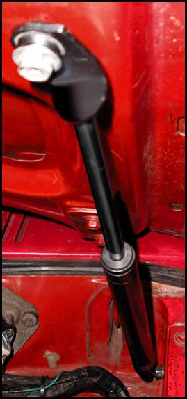

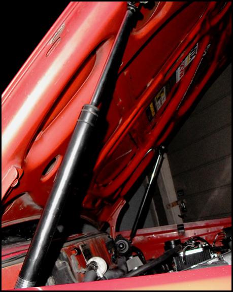

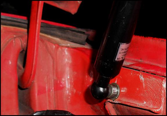

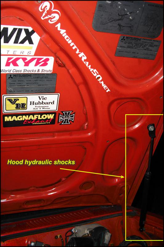

    I also had time today to install some shock tubes for the hood of my truck. I no longer need the rod to support the hood and it is effortless to open it too. I added 2 shock tubes that I located at the wrecking yard that were pulled from the hatchback of an older RX7. They work great and do not rub anything when the hood is closed. Here is the completed project that took about an hour to do. If you decide to try this, I could supply the numbers of the tubes that I used if any are on them. It actually was pretty easy to configure the tubes to the hood too. Keeping them close to the hinge allowed the hood to open completely and let them fully extend to use their locking strength that is at the top end of their stroke.

    what year was the rx-7? I like that setup on the hood.

    haha I have some bad trunk shocks from an SC 430 that I have been meaning to put on. those trunks are really heavy for some reason so I figured it would hold up the hood on these trucks no problem. my do that this weekend.

  15. #90
    The car looked like this...mazdaRX7.jpg with the hatch. Tomorrow I can take a look at these ones I put in for a serial number.
    The other great thing when I installed these was that on the hood mounting, your ability to get fingers between the hood and the support piece sheet to put a nut on the bolt. Then on the area where the lower mount is bolted, there is enough layered body metal right there to drill and tap for threading a bolt into the body firmly.
    Not sure if the wrecking yard RX7 hatch shocks were changed or modified at any time, but they came off the style I posted the image of. I would follow the same areas to mount them also. I took extra time to locate the right place for them to fit correctly, away from hitting the fender lips and be opened to their full locking position. Strange that when I tried to compress these shocks by hand it was almost impossible. Once installed they worked beautifully being at their right compression and decompression strokes. It is so nice to open the hood now and it rises with almost no effort now.

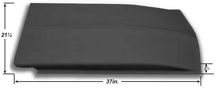

    Today we ordered this little mod device for the truck. $69.00 and some change shipped from FL. Should arrive in a few days and then I will paint it and figure something out to install it so it doesn't look like it's bolted on top of the hood. I also don't want to pork the hood all up either, but we'll see how brave I am once it arrives. COld weather is here and I sure would like to start parts painting the truck in the garage. Anyway, we will update you on the arrival and installation when it drops at the door.
  25. #100
    I think I have seen a scoop like that somewhere... bond studs to the underside to bolt it to the hood.
