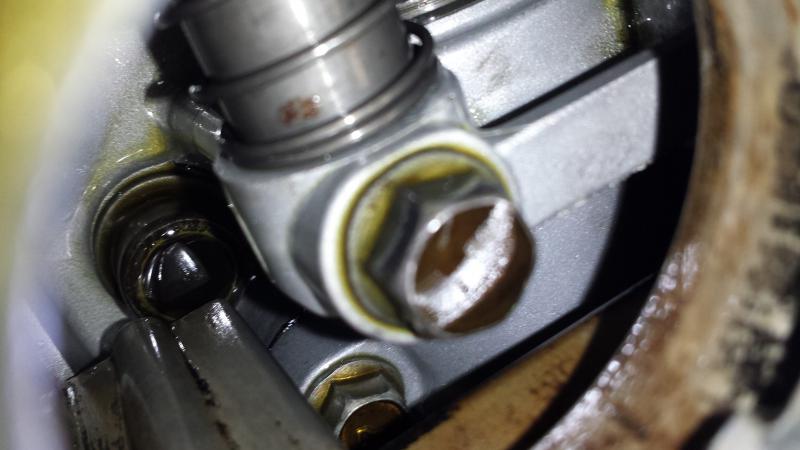

    I am glad this thread has opened up so much. I really appreciate all the help on this one. However, even with all the help, I still have no idea as to what engine I have.
    What I do know:
    1. The oil pan is flat
    2. The firewall says 4G64
    3. Here is a pic from the inside of my valve cover. They look like regular bolts, but I can't tell.
    I guess I'm gonna have to bite the bullet and check the flywheel so I will know once and for all. Can anyone send me to some instructions on how to get to the flywheel?

    Those are the factory 1gen Allen head bolts, Congrats!! You have a 6 bolt!!

    Quote Originally Posted by thehive View Post
    indeed... 3 yellow lines for reference.
    Attachment 12018
