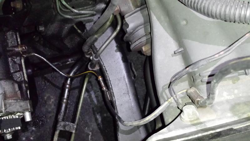

    My first major question has to do with the negative battery cable. The old one is completely shot, so I got a new one. There is only one problem. The original goes from the negative post to the engine, which makes sense. What I am concerned about is this:
    From this pic you can see where it connects to the engine (blue square) but it also is connected to the frame and the wheel well. The new cable doesn't have places to mount this way, which I was told will work by they people at Advance isn't needed. So I figured I would ask yall about it before I hooked the new cable up and turned the car on.

    you need the negative cable to connect to the body, frame and the block - the idiot at Advanced doesn't have a clue about these trucks. That is how all the metal in the truck is grounded, without the body ground, lights, gauges and even the starting and running of the vehicle will be affected, possibly to the point of nothing working. Even worse, if a high draw item needs a ground and doesn't have one, it will find a path even if it is high resistance, melting metal and starting fires. Get a piece of 0 or 1/0 gauge wire, terminals to fit, and make a new set of ground cables - from battery to body, body to frame, them frame to block, cleaning all attachment points and using dielectric grease to prevent corrosion.
