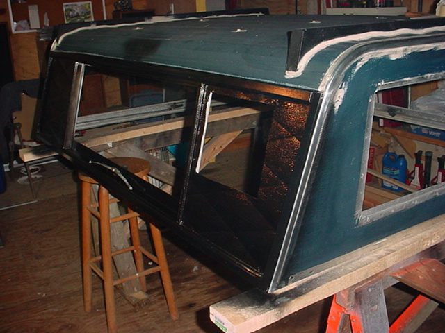

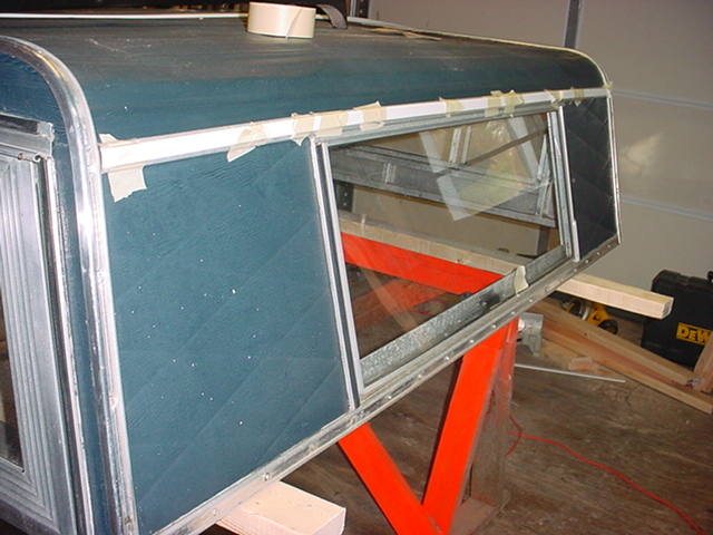

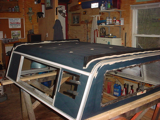

    Someone gave me an old aluminum camper shell that had been sitting in their garage for years. It's not a perfect fit, but it isn't a bad one, either.

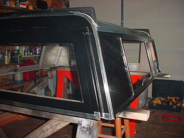

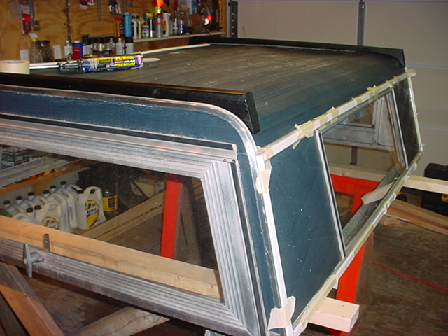

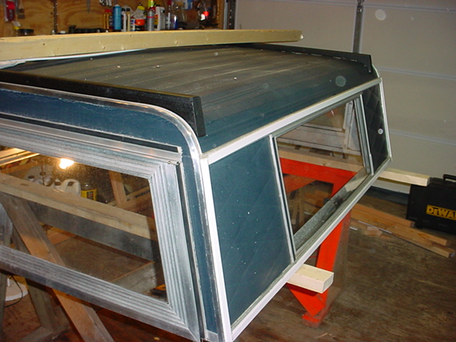

    Looking ever-so 70's, there's not much I can do to improve the lines on this thing. It was a cheap production shell back when it was made. That's not to "look a gift horse in the mouth", that's simply stating facts. I need to be able to carry my 28-foot ladder, so I planned the same modification I performed on my F-150 fiberglass shell.
    Much of the plastic trim, that covered up the screws holding the skin to the frame, deteriorated. I'm using 3/4" plastic screen bead, glued first to the heads of those screws, then will caulk the seams before painting. I'll let the photos speak for themselves.

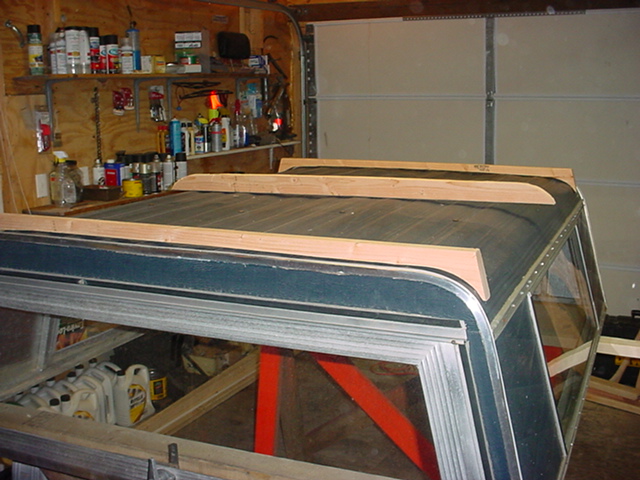

    I'm using LockTite adhesives (available at Lowe's) and sealers, which are about the best you can find. After a failed attempt to get the curve of the top transferred to a 2 x 4, I decided to make a template from the rear aluminum strip. It worked perfectly.
    The top will be painted with truck bed liner paint, the sides will be Dupli-Color metalic black...same as I painted the rims and bumpers. Not sure what color on the trim, but that's a day or so away. Feel free to make suggestions. (About the trim color )

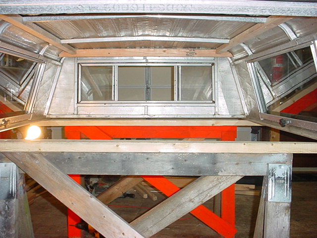

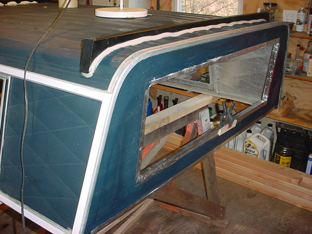

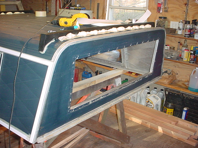

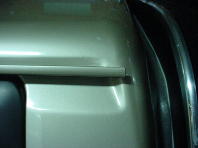

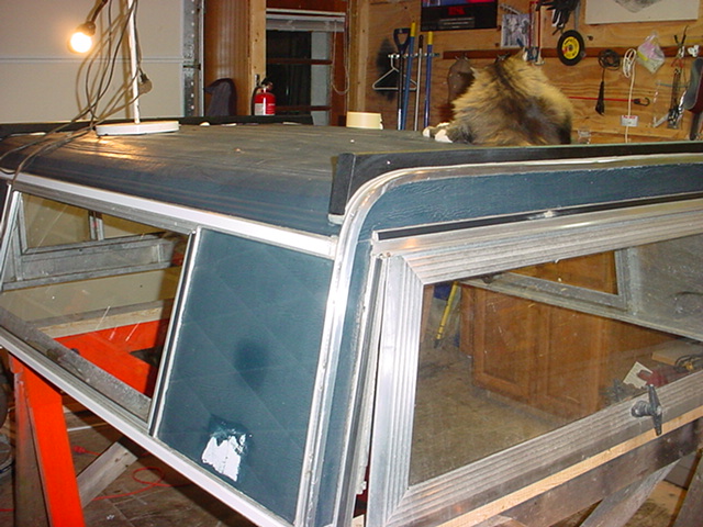

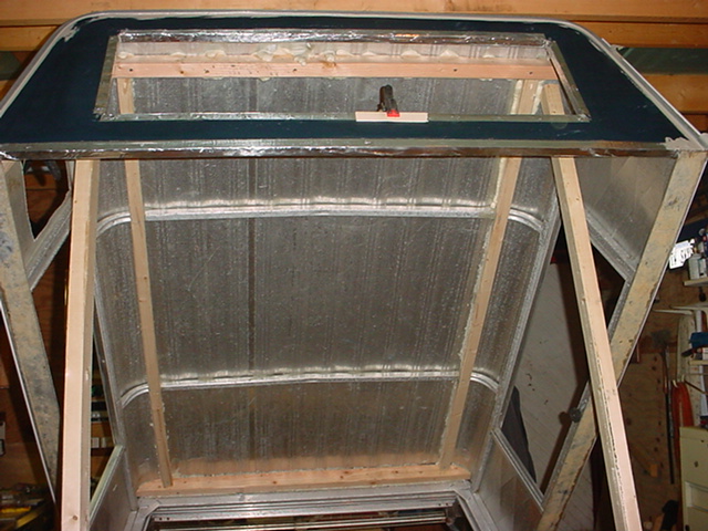

    The front window had some issues, so I tried cleaning around the trim, only to decide to just take the thing OUT. When I did, I realised I could put it back in from inside the shell, and this gives about a 1/2 inch I can move it forward on the truck bed. 1/2" is exactly how much the shell sticks out beyond the tailgate. This might allow a perfect fit, front-to-rear. Photo below also shows expanding foam across the top cross bar (ladder rack).
    I used LockTite sealer and metal duct tape to secure the aluminum skin. This side of the shell isn't seen, so I'm just going to paint it the truck bed paint. I also removed the bottom flange. I'll see what I need when I do a fitting, but I should be able to snug this right up to the cab and create a boot between the cab and shell.

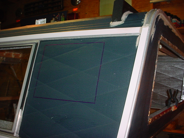

    There is a horrible blind spot when the shell is on the truck. I bought a piece of plexiglass and will have an additional window before it's all said-and-done.
    The side windows were easy enough to take out, so I can re-hab those on the counter. It was frickin' light as can be. Below, it's tilted up to allow easy removal of excess expanding foam, touch up glue, and wipe down everything.
    Around 4:00 I was pretty tired, so I left it looking like this...for now:

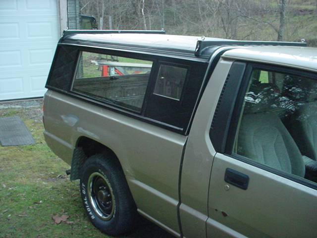

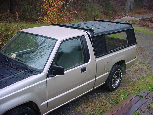

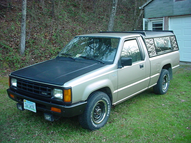

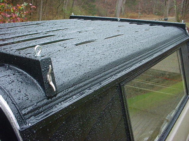

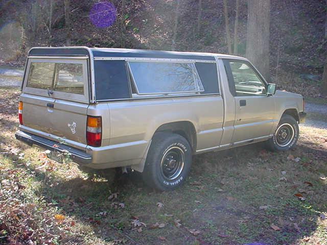

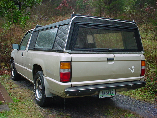

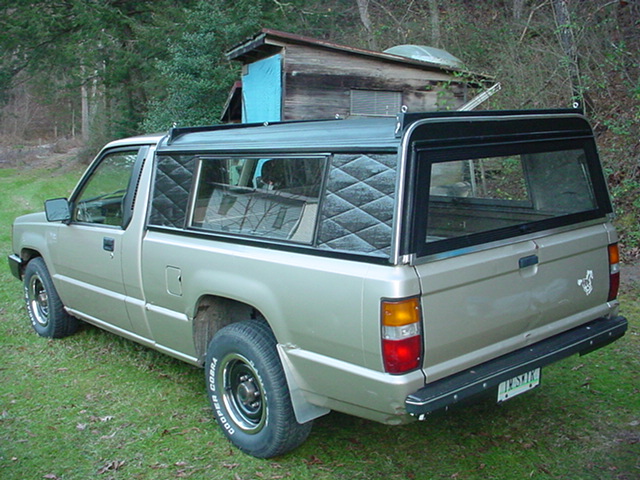

    Okay, photos of the finished product. If anyone's interested in the construction, just let me know.
    I hate that diamond pattern, but had to get this thing in service. Perhaps next Spring I can cover them with flat panels. But for now, this is what I have.
    The little window I added on the side really works great to eliminate that blind spot. Cosmetics be damned : I wanna SEE!

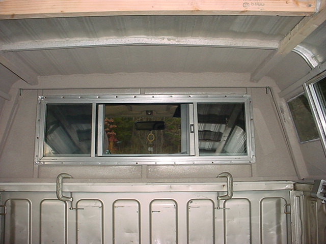

    On the interior I experimented with "stone" paint...it spatters some four different colors. It worked well, and although it isn't finished, here's how it looks. Also, the window mounted from the inside indeed gave me a perfect fit. I mounted a foam gasket between the shell and truck, and it works fine.
    The lumber rack I had on there had clamps that fit the sides of the shell adequately. The two c-clamps in the front are temporary...until I can locate some shell clamps. I really don't want to drill holes to bolt it down.
    From some angles, the damn thing looks like a hearse. From other angles, it looks like the old flip-side lunch trucks. There's no bringing a 1980's item to look "today", but it at least has a better look...and I have a ladder rack.

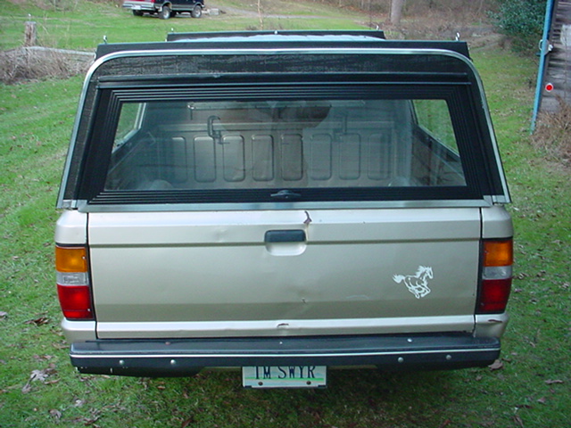

    I appreciate that, RRTT. I was able to create a seal using a "rope" insulation and mounting tape. I essentially made an eyebrow that snugged up against the cab window. It hasn't been subjected to rain, yet, but tomorrow it certainly will. I have a good seal between the shell and bed. It's my hope to put some nice carpet back there, but I want to be sure it remains dry.
    On a personal note: you see your camera is still giving me good service! I still thank you every time I use it.
    1,271

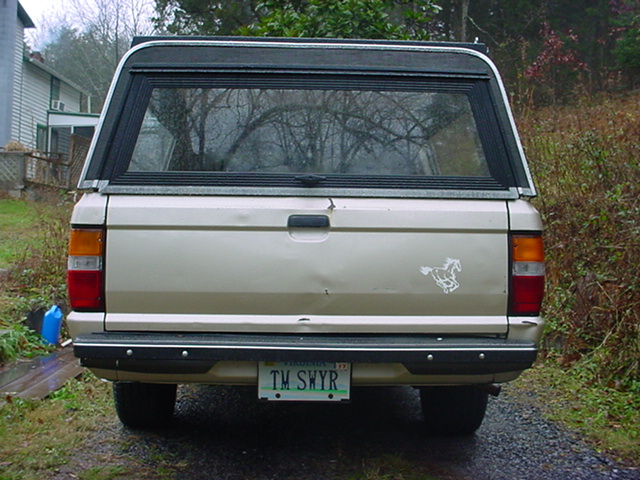

    Hope you can see it...
    And final photos. The shell is subjected to rain today, and isn't leaking a bit. I call it "A Day".
