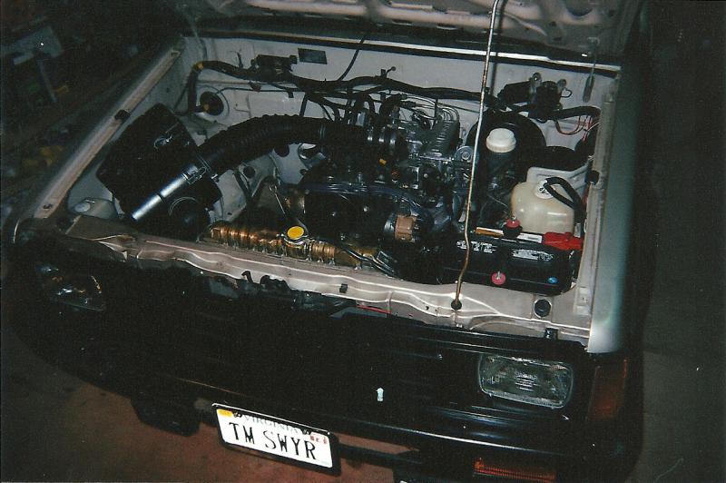

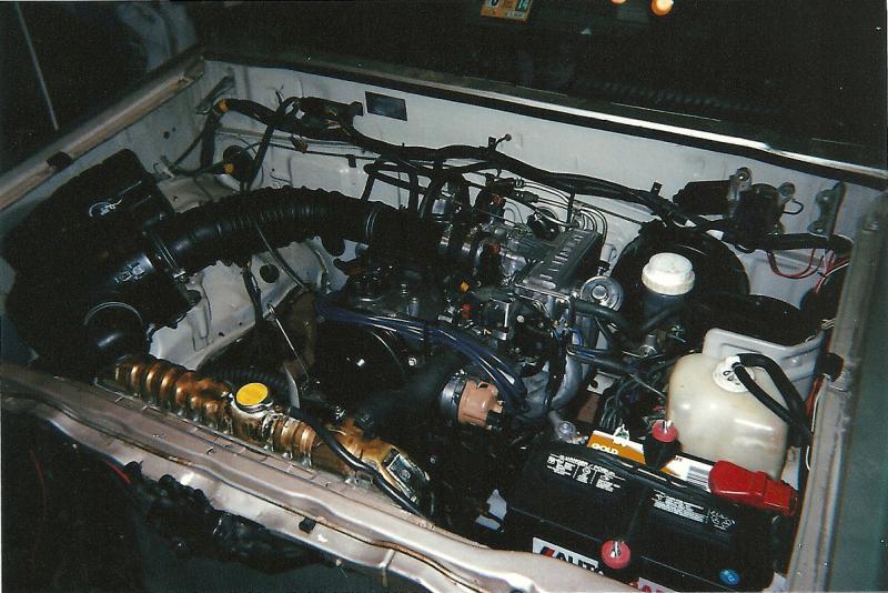

    Ready to close the hood and call it a day.

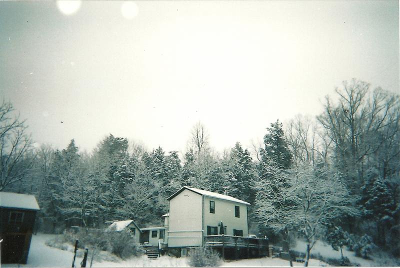

    View of the house from the garage, just this morning. I bet an old guy is taking an afternoon nap in there with three contented cats while the snow falls.

    Wow, it looks so clean I'd feel guilty getting it dirty. Great job! The snow, while it creates a few headaches, sure looks nice for this time of year.
