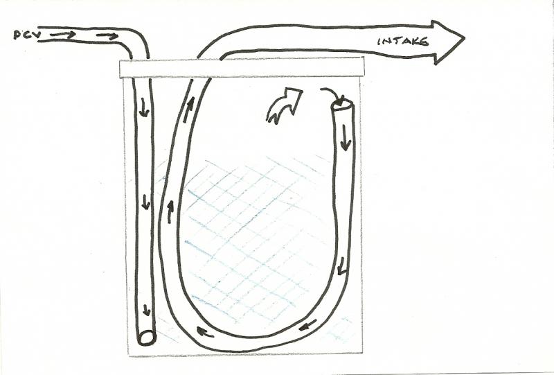

    Here is the simplest design I can think of. Using literally a jar, sealing the lines in and out, and loosely filling 1/2 to 3/4 of the jar with cheesecloth.
    Any reason why this wouldn't perform the task of filtering gunk and trapping moisture?

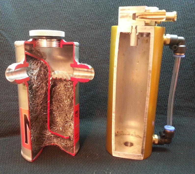

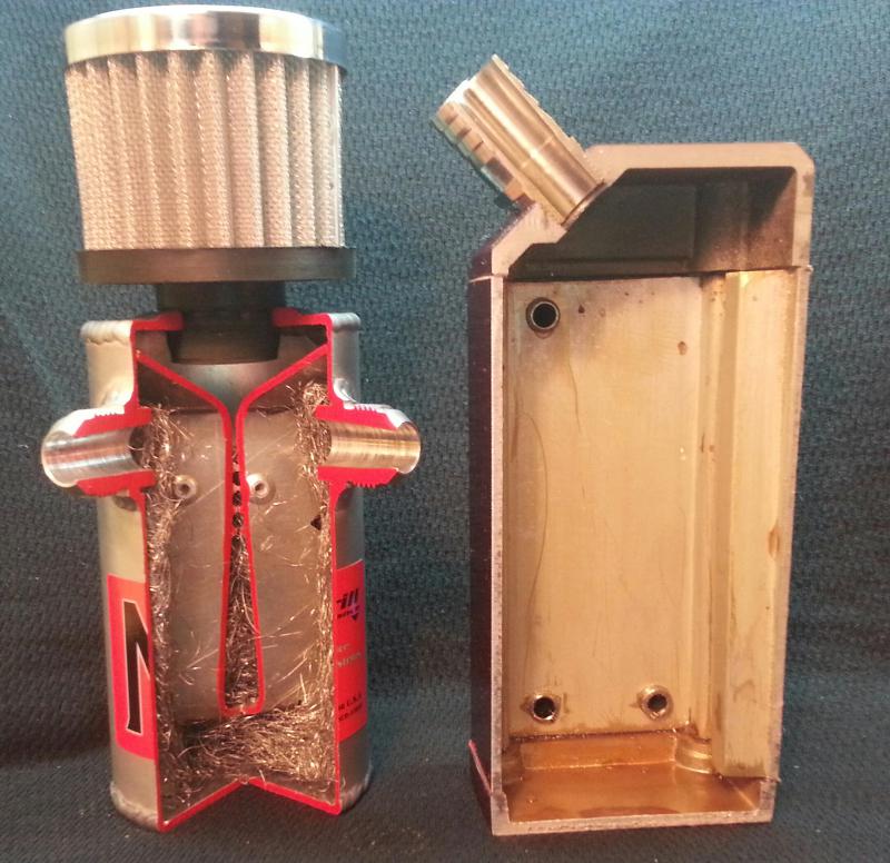

    I don't know how to put this without trying to sound like I'm making a pitch here, but we manufacture catch cans as part of our product line.
    Only catch cans, are meant to be catch cans. There is a separation and filtering process that needs to take place to keep the ventilation high and the crank waste low as well as out of the engine.
    Here is an example of an empty "Universal catch can" can vs a real catch can
    Here's the thing - YES proper purposed catch cans will keep the crank waste out of the engine and allow the crank case to breathe better. However, they are not going to do anything for you if you don't actually need one, other than adding bling. If you have no serious mods, you don't need one. The factory system will do just fine and regular maintenance will keep the vented crank waste from harming anything. Simple things like fuel cleaners (I like BG44k personally), and intake cleaners will wipe all that stuff away and all you need to do is dump it in the tank or spray it.
    If you use a makeshift can, or an empty "universal" can, you run the risk of clogging your ventilation system, restricting it, or even worse, storing oil and moisture that is un-contained (slosh). If you use a recirculating ventilation system, you run the risk of letting your engine take a giant drink of crank waste if you let it slosh around. That's worse than the factory recirculating system.
    Some re-circulation type catch cans of the "Universal" variety (like eBay) have ports that are actually smaller than your factory system. This is also worse than the factory system because you are taking a restrictive system (compared to performance systems) and restricting it even more. They are also empty cans, many of which can't be opened to be baffled.
    Just some food for thought. I can answer just about any question you have about this subject.

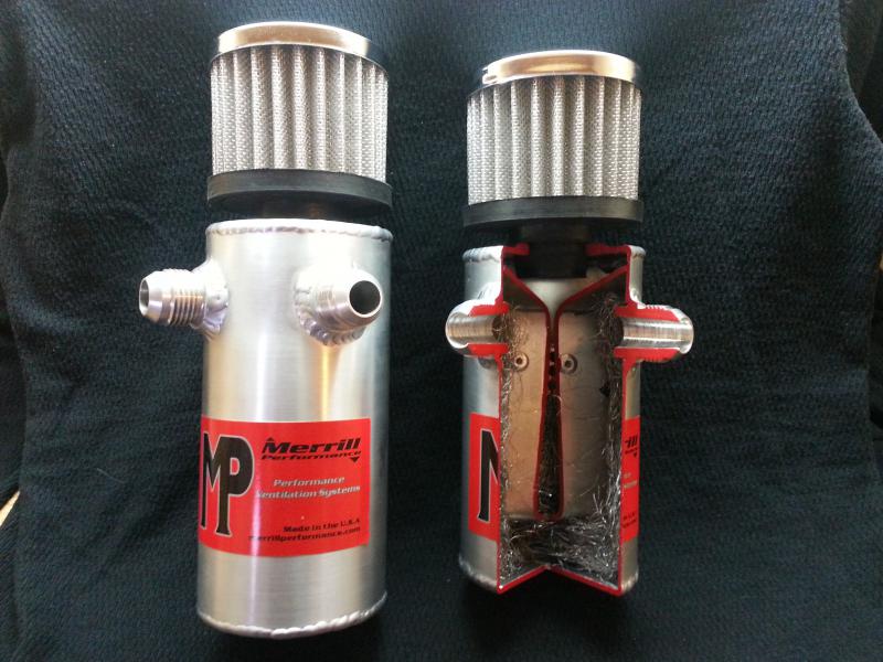

    California smog is mid evil to say the least lol. However, the bottom pic I posted is for re-circulation style systems (closed). All it does is filter the crank waste, and send the air back in. Many of our California clients use this system exactly for that reason and none of them have reported a failure because of it. The atmospheric type (with the filter on top) will fail a California smog right off the get go.
    Hey Merrill on those catch cans your selling with the material inside, what is the material (filtering product) that is contained in the canister?
    Also I would imagine that the material is replaceable so when it gets clogged with collection of the crank case stuff. (if I'm correct)
    Gravity is the filter. The baffling and chambers of our system allow gravity to do its job (separate the crank waste from the air). There is a ton of R&D, engineering and live product testing that went in to these. They took over a year to develop. The main reason they took so long is they are a sealed, lifetime use product that never needs filter of baffling to be replaced. You simply wash them out during normal service intervals. You can use products such as brake parts cleaner, de-greaser, detergent, or just tip it over to dump the crank waste out. If the baffling ever does fail for whatever reason, it is covered under warranty.
    The other part of this is the factory ventilation system. Yes many systems will line the intake manifold and CC's with gunk. They technically were meant to do that. The combatant to that problem is regularly scheduled maintenance. Catch cans are primarily for performance engines. Relieving excessive crank pressure is a modification that produces results (like installing a cold air intake is a modification). Unfortunately it also produces excessive crank waste (oil and moisture). Many race engines remove their baffling which allows more airborne crank waste to escape. The last thing you want to do is send all that crap back into the engine - especially an engine with a lot of performance mods. The catch can is the solution to the problem.
