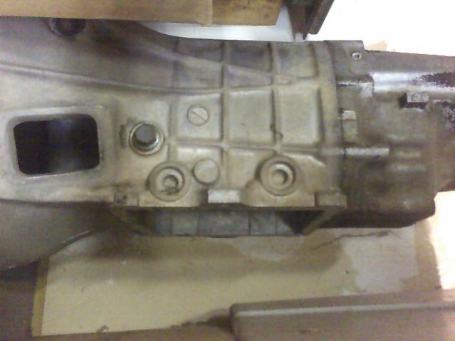

    We have only seen one odd ball trans on here. On the second picture, do you see the holes that are "not" knocked out of the casing? The trany in question had 2 shift forks through those holes. We think it came out of a mini van, Aries K car, Colt, or a fork lift. But it was the only trany we have seen that used them holes and external shift linkage. It's on here somewhere. But all the parts were the same. It was about a year ago.
    Found it. Look here. http://www.mightyram50.net/vbulletin/showthread.php/308-Manual-tranny-I-D
