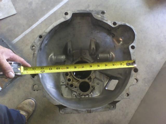

    I almost think that someone was already using it as a manual tranny. The ATF lines were plugged up with silicone, plus it has the slave cylinder on it. I found a clutch kit on Amazon made by Beck Arnley, only it is for the sport, and is 8 3/4X23X1 instead of 8 7/8X23X1. I wonder if this matters?
    3,847
    That is a manual trany, so some of the parts should work with the trany you have. The big difference will be the tail housing and out put shaft, where the shifter is. Looks like a 4 speed. I wonder what it came out of.
    Look at how short it is. What is the width of the bell housing between the bolt hole centers on the two widest holes? That will narrow down the ID of it. Narrow or wide block. If it's a narrow block I have a new engine that will bolt up to it. From the archive. ( 12.5 inches = Narrow, 13.25 inches = Wide )
    04-10-2011
    32
    Eugene, OR
    1984 Dodge Ram 50
    4D55-T
    looks like 13.25
