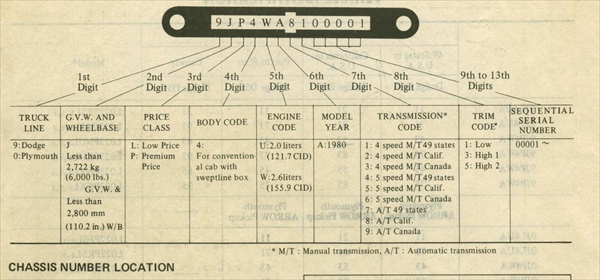

    from 1 decoder
    [top]1989 DODGE RAM 50
    VIN numberJB7FM24E8KP031197
    RegionJapan
    Factory / ManufacturerToledo, OH
    MarkDodge
    ModelRam 50
    Model Year1989
    BodyRegular Cab 2D
    Doors4/5
    Engine2.6L L4 SOHC 8V
    Fuel TypePetrol
    Serial Number031197
    This is from the 1 gen manual. I wish we had more of these.
    3,848
    Well I just put a call into mitsu to see what they can find for us in the line of decoders and other manuals. We will see what they come up with.
    They just sent me a fax that will decode from
    1983 - 1992
    1993 - 1996
    1997 - 1999
    I'll get them up asap.

    OK I put up the decode sheets in the manual section.
    http://www.mightyram50.net/vbulletin...0854#post10854
    The vin you show.
    JB7FM24E8KP031197
    J: Japan
    B: Dodge
    7: Truck
    F: 4001 to 5000 LBS
    M: truck 4X4 1987+1
    2: Series = Low
    4: Conventinal Cab
    E: 2.6L
    8: UNKNOWN
    K: 1989
    P: Nagoya-2 plant
    03119: production numbers
