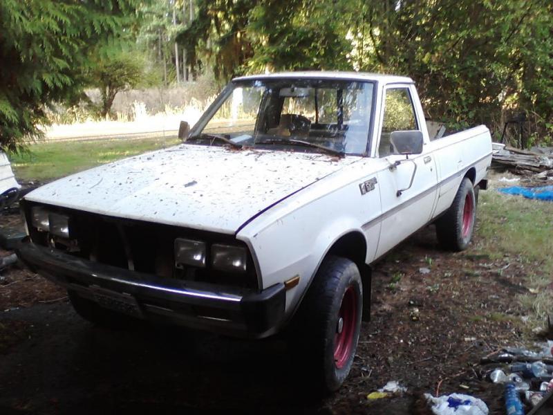

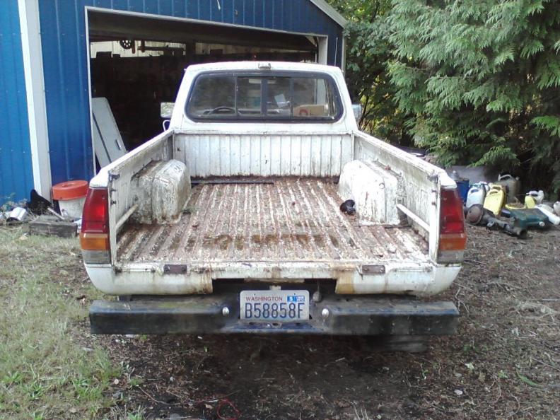

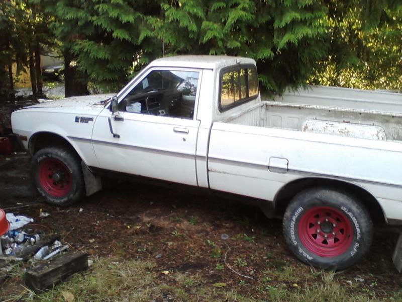

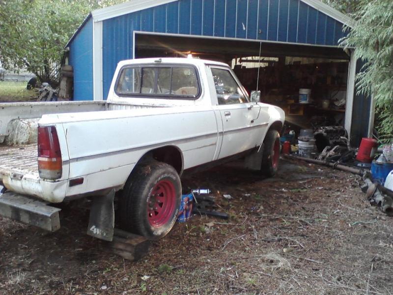

    here are the only pics i have of the truck... in front of the driveway.... :'(
