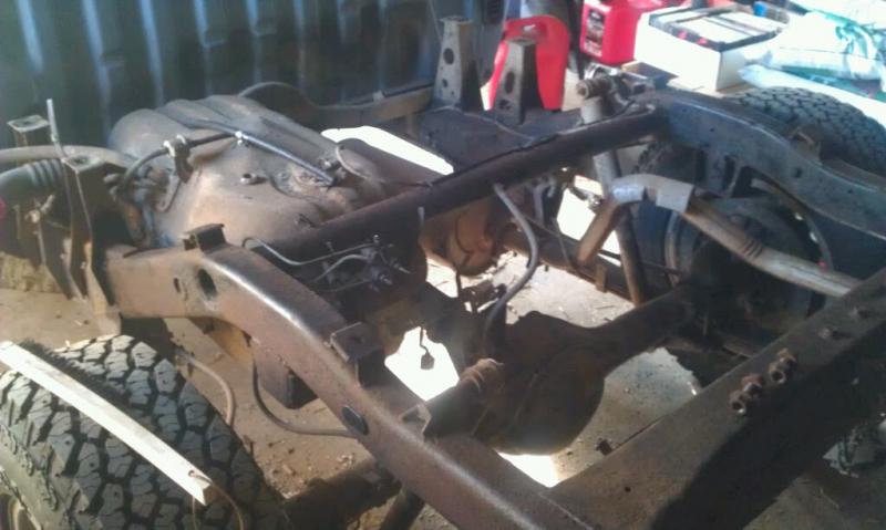

Noah - Any chance you could post a picture? I bought a Carter some time ago to replace the existing one in the engine bay. I have just been struggling with a good position to place it on the truck. I like the way Mopar_ja had mounted his, but my gas tank layout will not allow me to do the same. Thanks!
My truck is closed for rennovstion right now (slowly bagging it) but it's just a machined aluminum project enclosure for electronics hobbyists from mouser.com. Almost identical to mopar_ja's. Do you have a picture of your tank and frame? What's it hanging up on?
Noah - It's hard to see in this photo, but if you look to the left you can see the mounts/supports for the bed behind the cab. Between those are the hoses that connect to the fuel inlet spout. Their placement is making it difficult to mount a plate between the supports high enough to keep the pump above the frame.

I can try to get a better pic, once the weather lets up.
the 87 up fuel lines are in the way to mount the pump like mopar -ja and I did on the 1st gen trucks - the lines come right out of the upper side of the tank right between the bed support posts. Not sure what the best way to mount one on the 2nd gen yet - just got an 89 and will look at it when I start working on it to see what it would take.

Try bolting it to the outside frame just aft if the cab.
that can work but is not the safest place to put it in case of collision in that area - do you really want a gas line sheared off with a running pump in a collision? Think 73-87 chevy trucks with gas tank outside of the frames...
