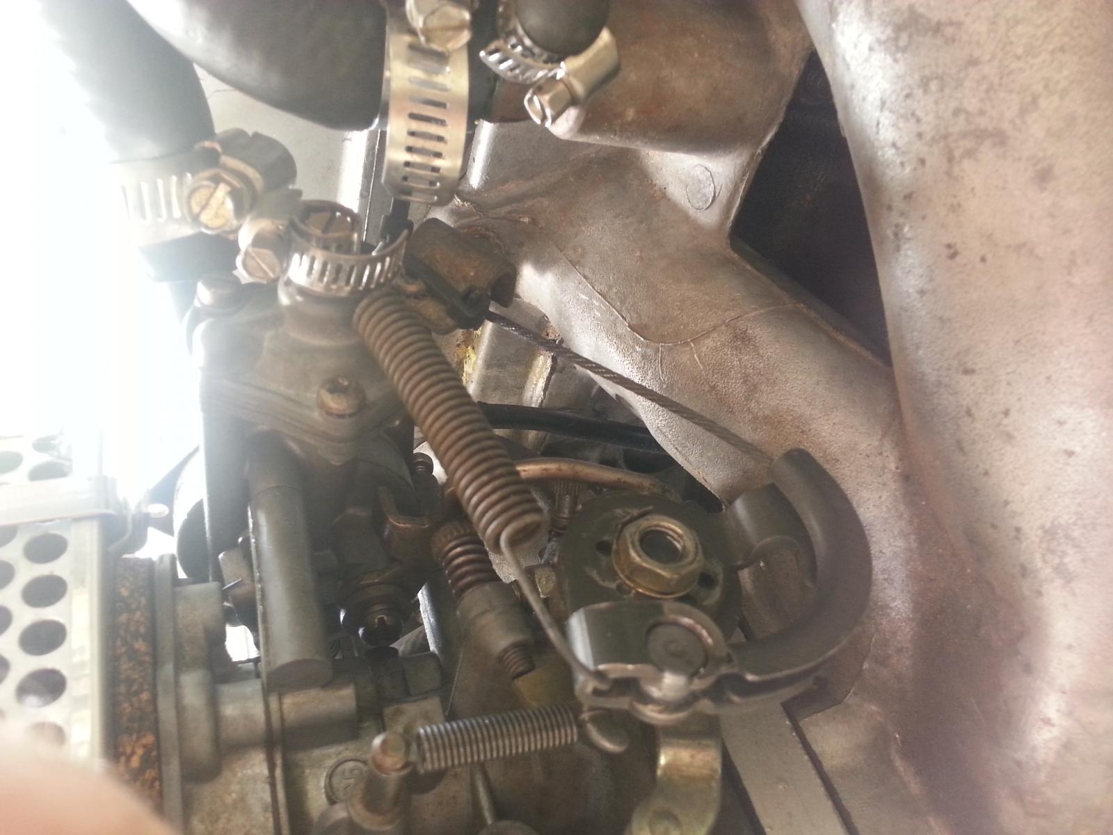

Attachment 19947
Attachment 19948
Fuel in on the right, return on the left. I'm not sure what the carb came off, its a DGAV 19A elec choke and the choke butterflies open down toward the fuelbowl.
Other photo is the dodgy looking but effective throttle body cam I modified to work as I wanted the fuelbowl forward so the jets arnt starved from inertia.
Also used a large spring off an old carter carb as a secondary throat kickdown and to make sure the throat is fully closed when off the gas. Theres a little resistance and a pop when the secondary's open
The mechanical pump over powers the weber needle and seat, forcing gas through the carb like you are dumping it in with a bucket. Change over to an electric pump at 4 psi, mounted at the tank will fix the problem. You must get the pressure right to the carb before messing with the jets.

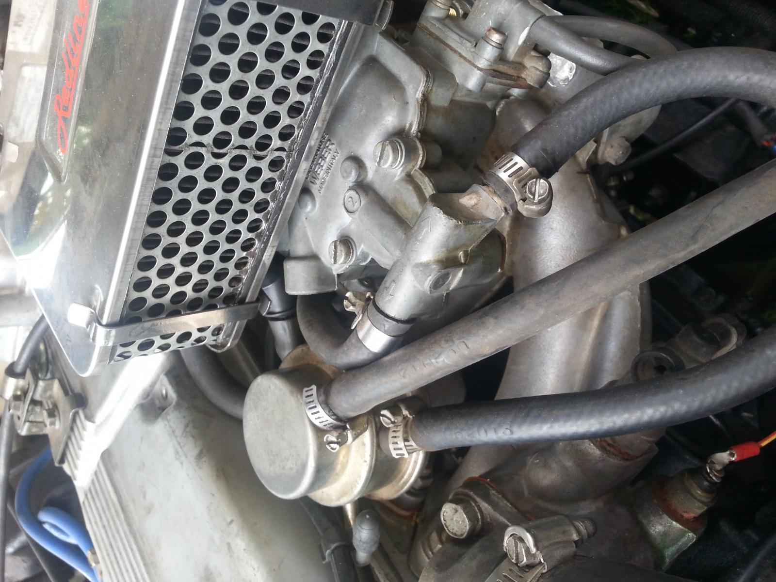

OK better get this up quick smart - see that metal cannister with the coloured tape on it? HOLD ONTO THE DAMNED THING. This is super handy for doing the Weber swap and redirecting fuel lines for fuel return systems. If you can't use it, some else doing the Weber swap definitely will. It's from the single inlet in/out mechanical fuel pump.
It is a fuel separator canister - it was on the early d50s up to 1981 in the US. Geronimo still has his.
