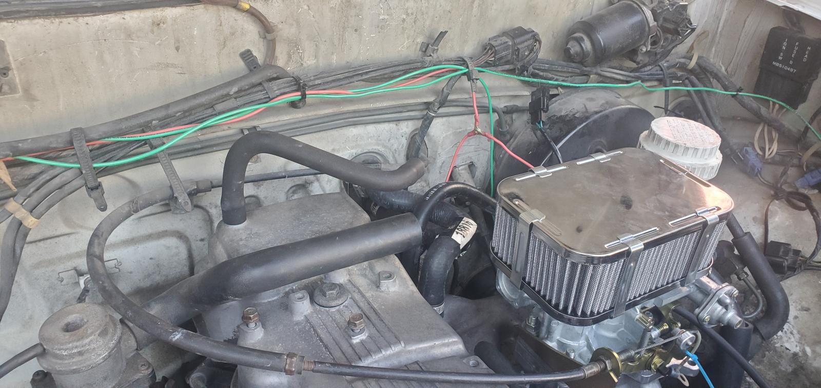

When you installed the carb, did you do it with the fuel bowl facing the front of the engine bay or the rear? Facing the rear will cause the fuel float to shut off the needle and starve the engine out. Any other info like has it only just started doing this or has it been like it since installation?
