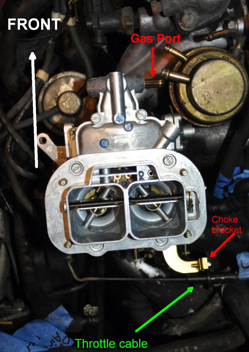

Some background: I have a '85 Dodge Ram 50 4wd pickup, manual tran with the 2.6l engine. Some, but not all, of the emissions equipment had been ripped out or disconnected when I bought it. It gave terrible gas mileage, ran so rich the cab reeked of gas when it was started and it idled very poorly both cold and hot. After reading up on this and other forums, I decided to get a progressive Weber 32/36 (not a knockoff). After speaking with the order guy on the phone he confirmed that a K610 was the correct kit to order.
Since the throttle plate opens counterclockwise, instead of clockwise (the mikuni) and is on the right side of the carb instead of the left (the mikuni) with the gas port on the front also on the right side of the carb instead of the left, I am thinking this is NOT the right kit for this pickup.
Is there a Weber kit that would install easier onto my truck than the K610? The features I am most interested in is a throttle plate which opens the throttle in a CLOCKWISE direction instead of counterclockwise and gas inlet tube on the left instead of the right.
NOTE: I am assuming there actually IS a 32/35 Weber carb kit which has these features. However if this kit is the closest match for my truck I will stop whining and get to the necessary mods. :-)
I have already dry fitted (no loctite or grease) this kit to my manifold and it fits fine except for the things I have mentioned.
