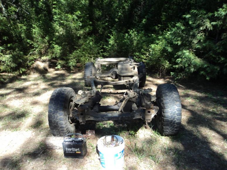

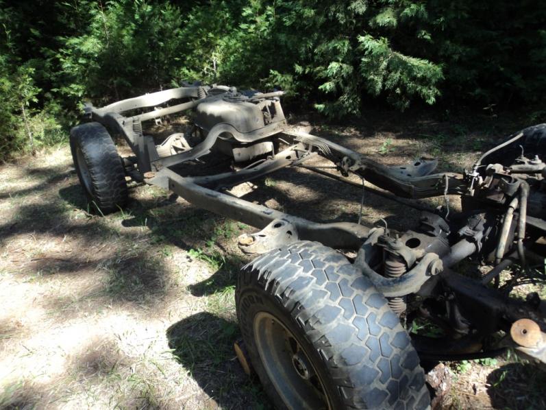

Attachment 1956Attachment 1957Attachment 1958Attachment 1959Attachment 1960Attachment 1961

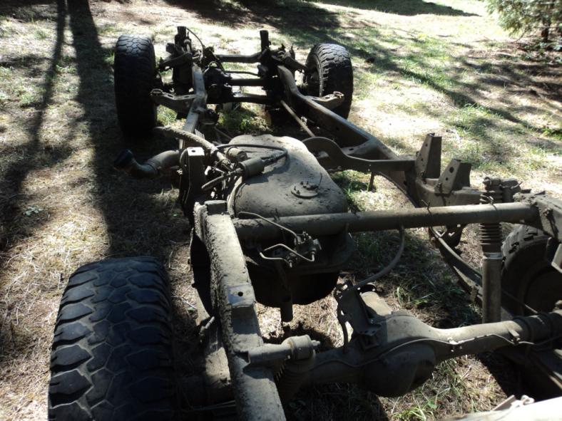

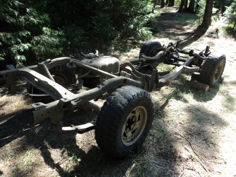

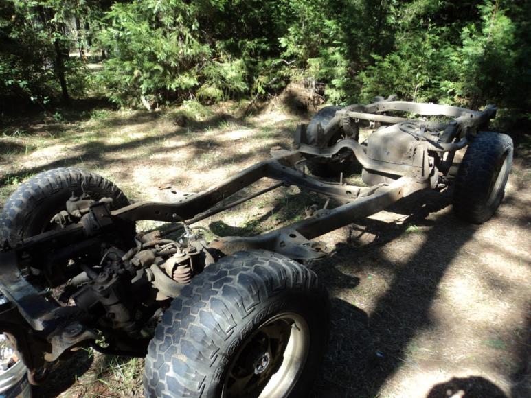

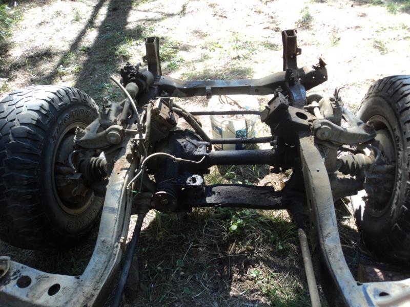

i haven't decided whether to go 4 link with the rear axle or going independent suspension. i have an extra front independent suspension axle with A-arms. my first thoughts were to use the extra front axle to go independent in the rear. my buddy with the cj8 tells me that 4 link is better. i think independent suspension is better.
to anyone who has been reading this build thread-
what should i do? independent suspension or 4 link. my ultimate goal is to use only d50 4x4 parts. no switching out the rear axle to a wide wagoneer axle or things like that. but i figured that i could use a front axle from a d50 and that wouldn't be going outside to the box. i will modify the frame and A-arms but i want it to be as much d50 as possible. this has been an idea in my head since i was in high school when i bought the truck. and i have kicked around the idea of using another front axle to go independent for a while as well. let me know what you guys think.
The front axle from the truck is a 7.5 inch and is too light to use in stock config. A front axle out of a second gen monty is an 8" that can be made lsd with a center section from a starquest, and will handle the power. You would also need to have new shafts made to center the diff, as the front has unequel length shafts. After all that work, you still won't get the articulation a solid axle with a 4 link will give you. If it was better, peope like extreme off road and monster trucks would use it more. Although Hummer H1 alphas have a pretty compelling case for 4 wheel independant suspension...
4 wheel independent is usually on off road racing cars trucks, and hummers, not ruck crawlers.
i'm kinda after the 4 wheel steering aspect as well as independent suspension. is there any way that i can beef up the front axle that i already have or would it be cheaper and easier to use a montero front axle?

Montero is the way to go, especially if you want 4 wheel steer

If I understood it right, you can swap out the rear axle with a Montero axle that already has the air locker AND big disc brakes. Junkyard price ~$250. ARB locker is about $1k as an aftermarket unit...
yes from a 2nd gen montero - I got one from a 95 montero - its a 9" not 8" with 4.63 gears, locker, disc brakes, and I got the suspension arms, panhard rod, the driveshaft stub and all the mounts for 250. Need to find higher gears for it, more like 3.91 or 4.22s so my low profile tires on my 1980 spin at a reasonable rpm at highway speeds. Supposibly, the gears from a ford 9" fit, as the mitsu 9" is a copy, abeit a stronger one
