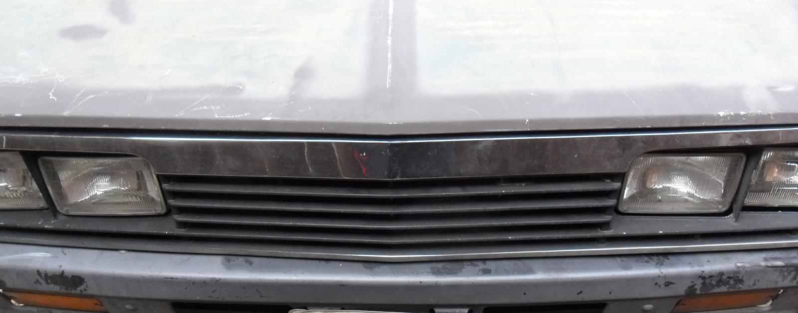

Does anyone know how to restore these grilles? The chrome is bubbling up in one small spot That I figure will get big over time.
Grill on here's a pic. Anyone know where to get the clips for the bottom?
Attachment 17856
Got the clips. Dodge Dealer wanted $10+ per from a discontinued parts depot!
MB has em for $1.88 each. Ordered four. Part number MB153825
