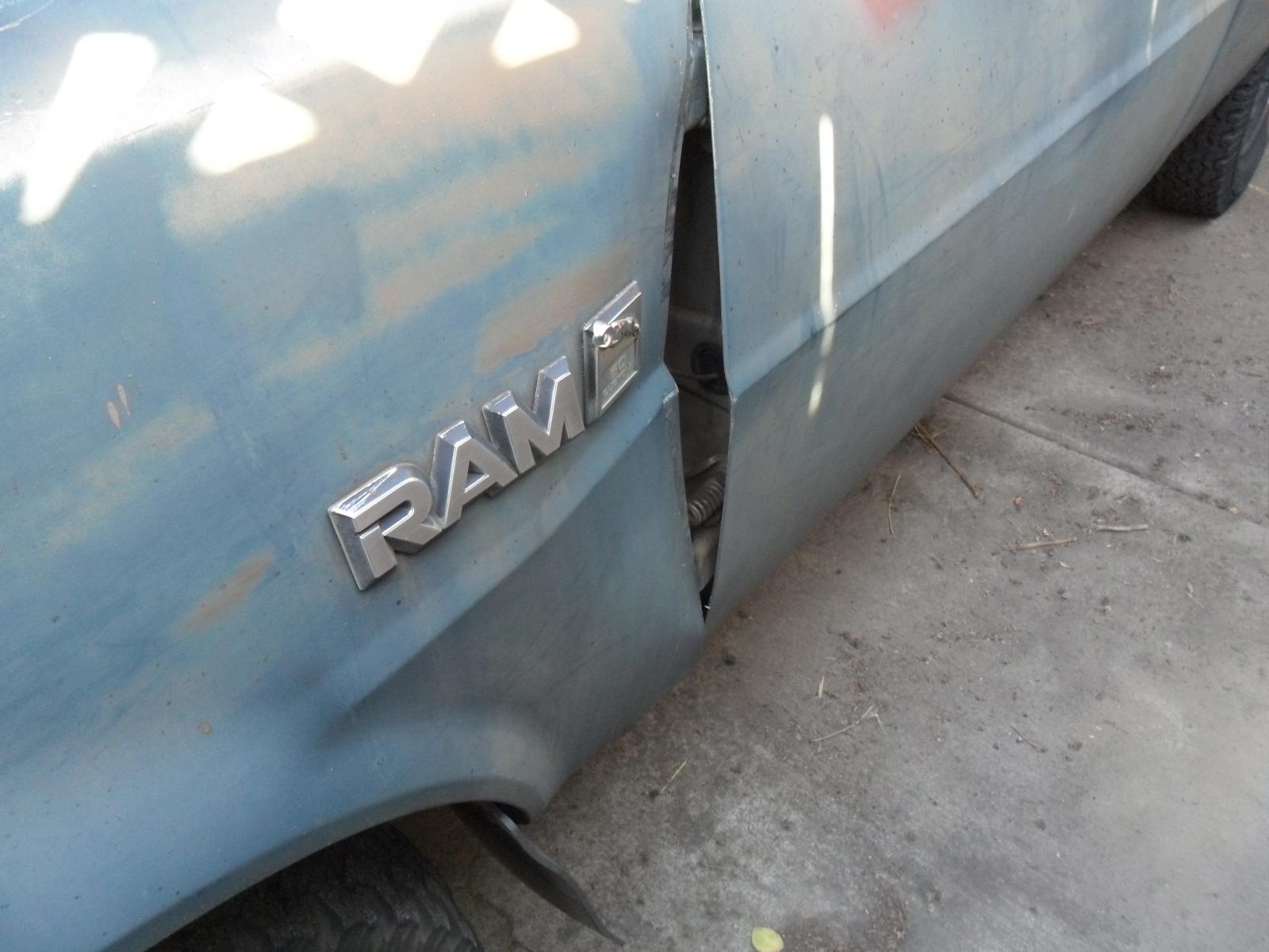

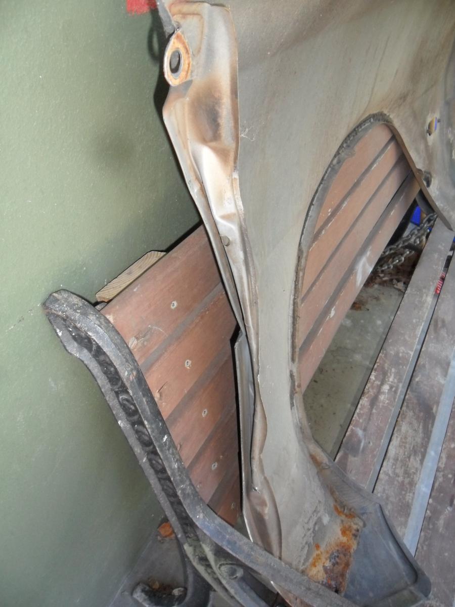

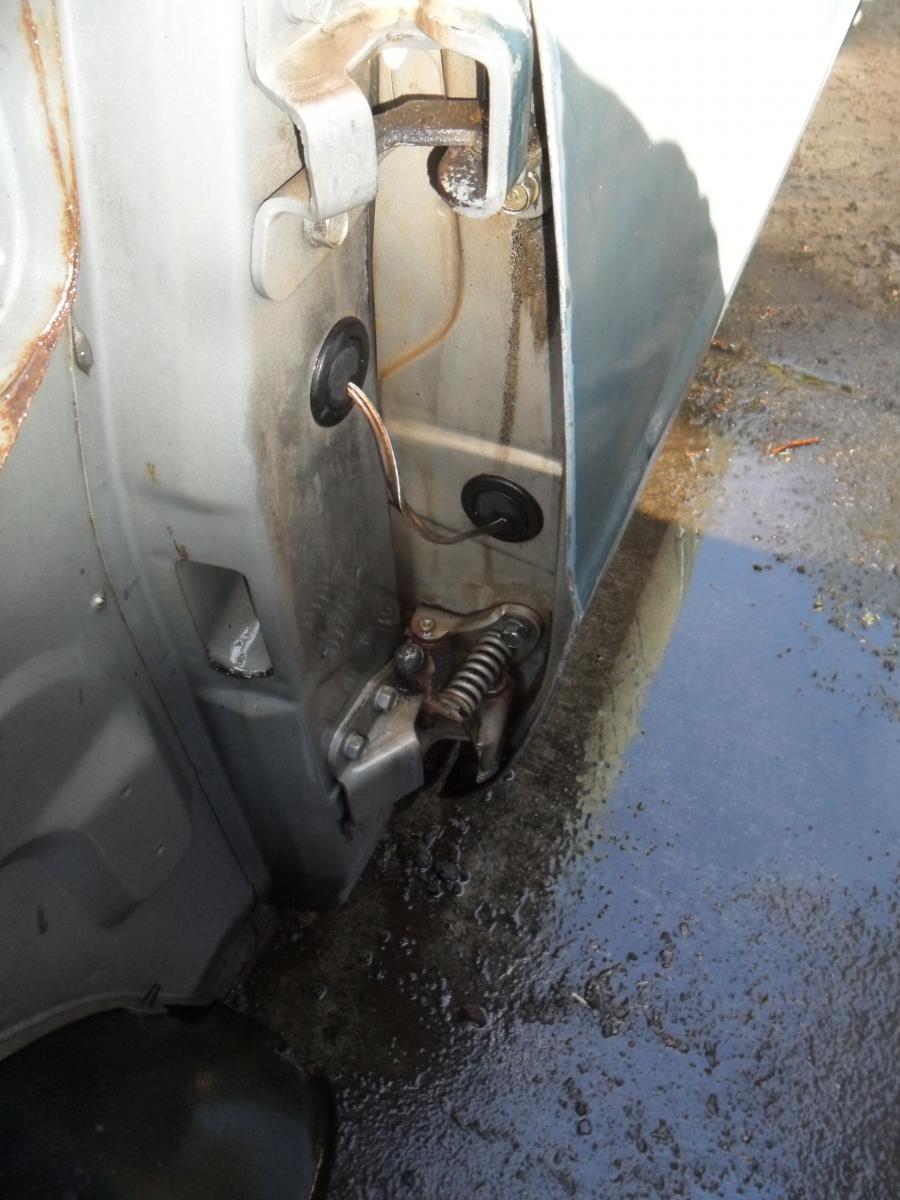

    I have pictures and I have the fender off. The hinges don;t look so bad but the door closes poorly now and it drops a 1/4 inch to 3/8 inch when it has that initial pop out after pulling the handle. Nothing on the pillar looks bent. It might actually be the door sheet metal where the hinges mount that bent. I haven't figured out how to check that yet.
    Pulling the fender. There is a bolt inside the door lip at the top of the panel at the base of the roof pillar and another behind the bumper end. Then there are the easy ones 3 in the fender well. Two at the base of the door/panel meet point. and another under the bumper at the bottom of the fender. Taking the fender end off is a pain. You can only get at the top and bottom bolt easily the middle one is a PIA 1/8 turn at a time. Do it first that way you can release the lower fender. the top of the fender inside the closed hood is easy enough but it has bitumen tape holding it down. I used a painters scraper and cut it without prying up on it and it worked well.

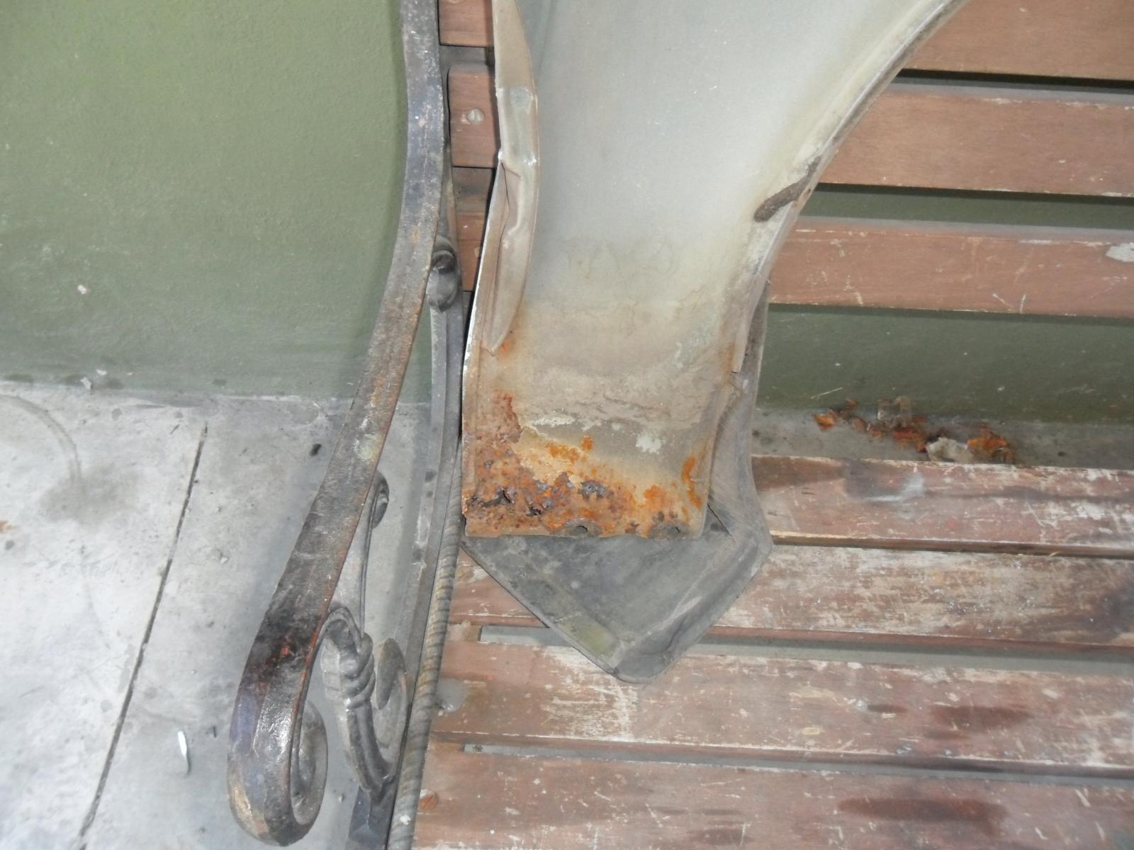

    Turns out I do have some rust where the two bolts hold the fender at the bottom next to the door.

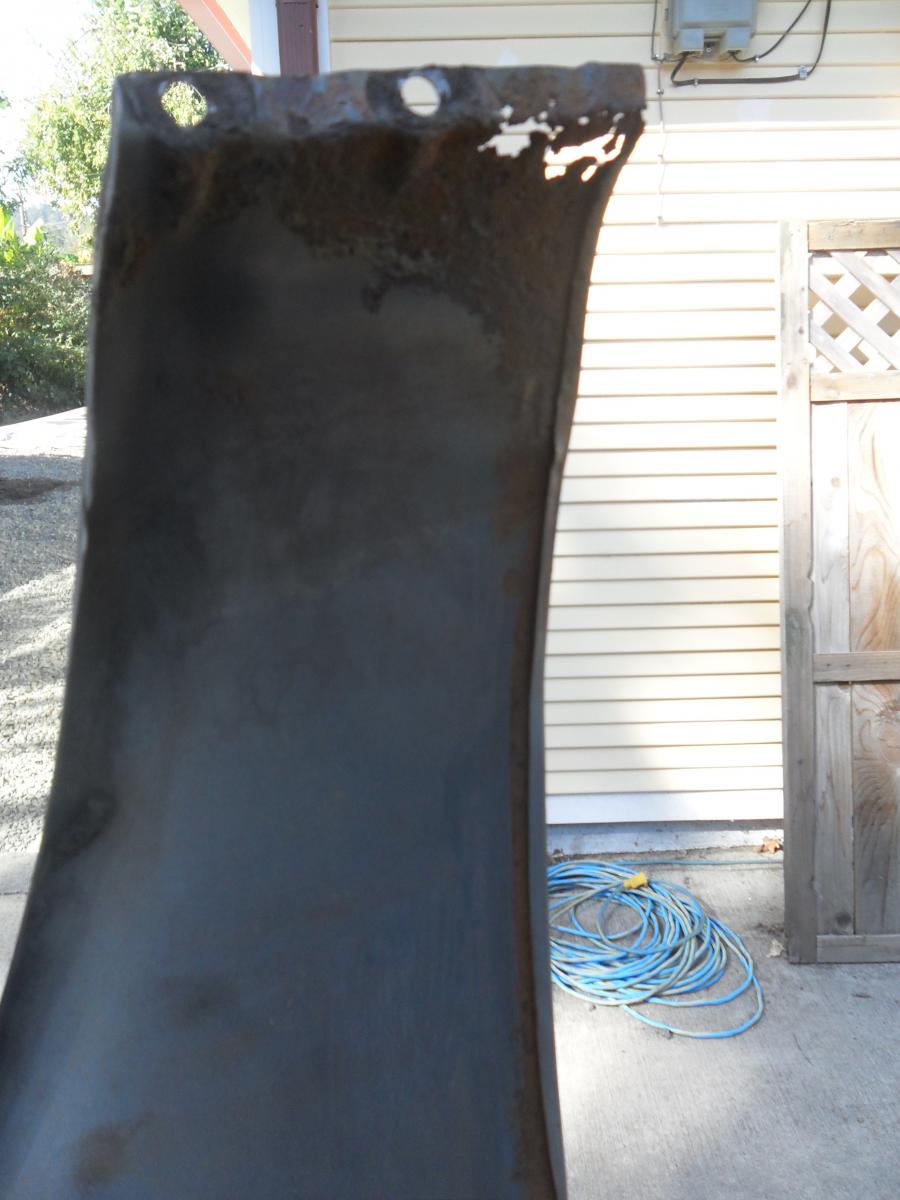

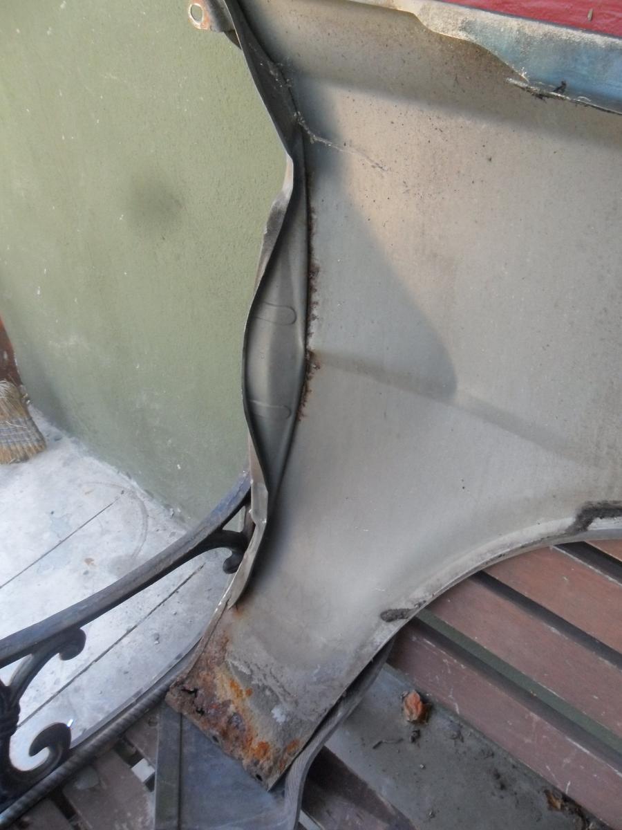

    More pictures of the fender off. I might go out to the yards where they have a couple of these and see if the fenders there are in better shape. I might even take those two bolts off the bottom of the fender on the other side to see if as much dirt falls out. I'm pretty sure it was that dirt holding water that caused the rust.

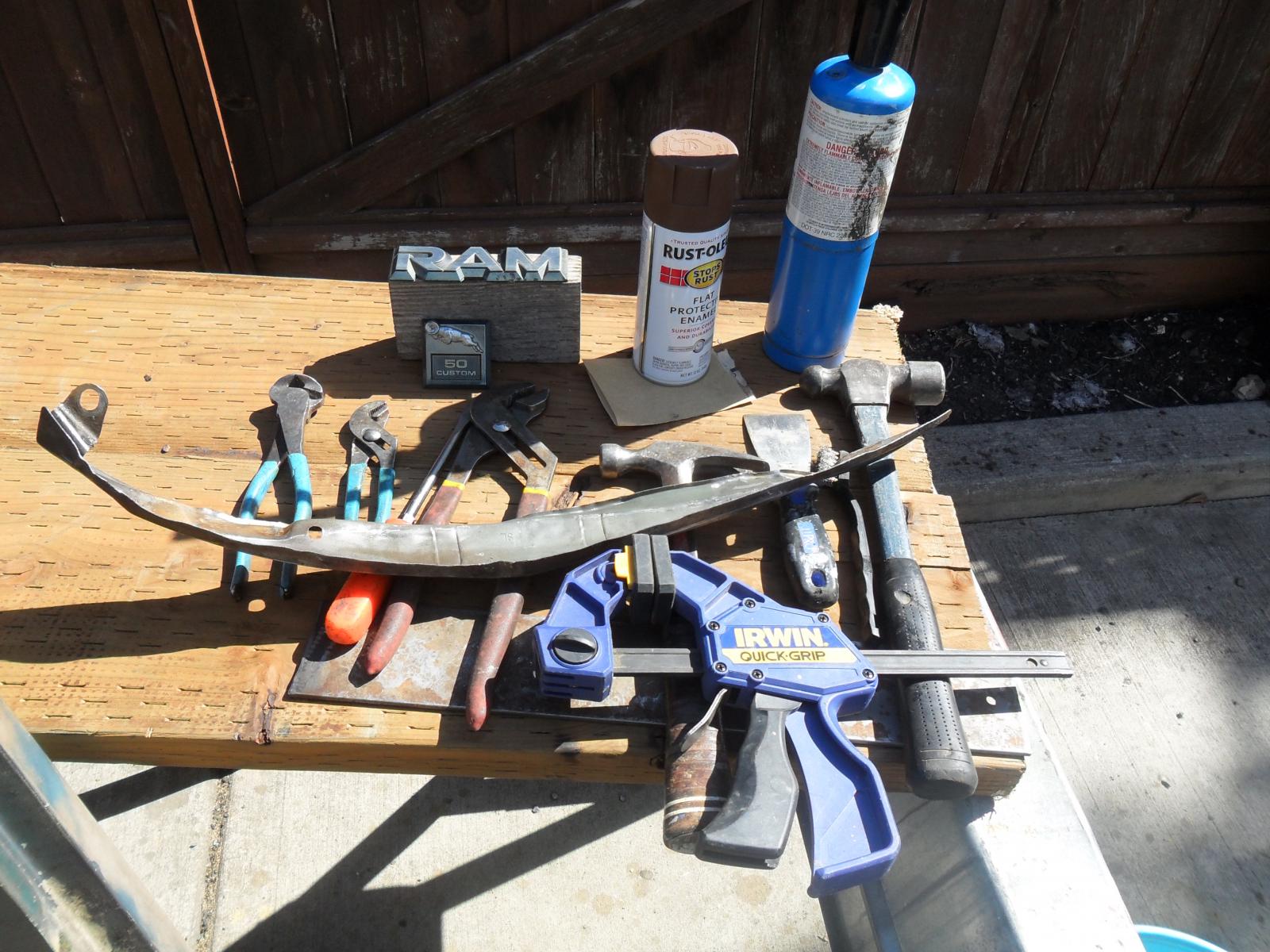

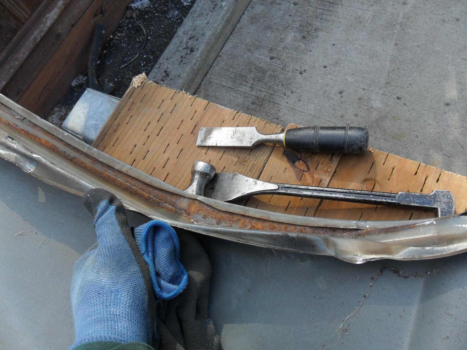

    While the primer dries before I put the stiffener back on.

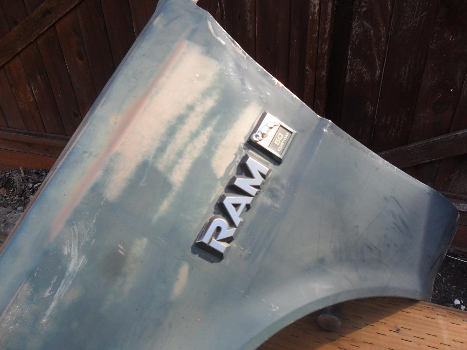

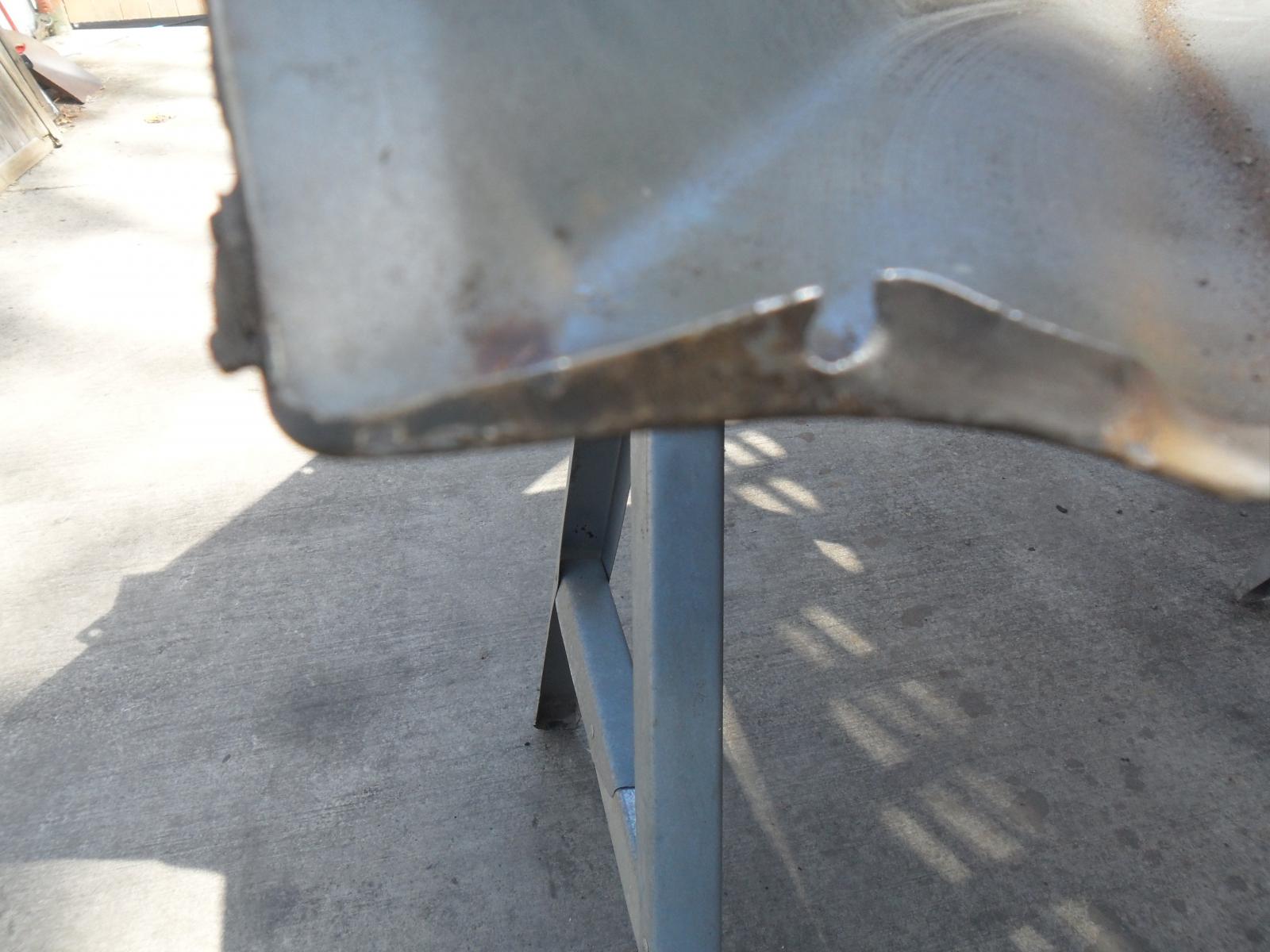

    The fender itself bent back pretty easily once I saw the stiffener would come off. I actually tried to break the spotweld that held that fastener spot to the stiffener but it broke where it did. I used the pile of tools I took a picture of and the little bit I know of body work to do this. I used the ballpeen flat face as the dolly block and the claw hammer to hit it. The rest bent by me stepping on it or hitting it with that 6” piece of 2x4.
    I’m at the point of trying to put the stiffener back on, it dry fit real close so I painted both parts with Rustoleum and will take a couple more pics when I get it back together, enough to see if it’s the hinges or the frame that are off. I might even pay a body gut to diagnose it once I have the fender back together. That way I'll know for sure.
    I will patch that rust hole with fiberglass cloth since it does not involve the attachment points there. Both holes are real solid.
    Some 2x4 and hammer work.jpg removing the stiffener.jpg spot weld.jpg rust holes.jpg better view rust.jpg tools used.jpg
    EDIT- I got the stiffener in by hand but it doesn't stay. Seems it had a spot weld at the bottom too. I need to get more acetylene and a 3/32 rod to be able to tack it. Probably tomorrow.

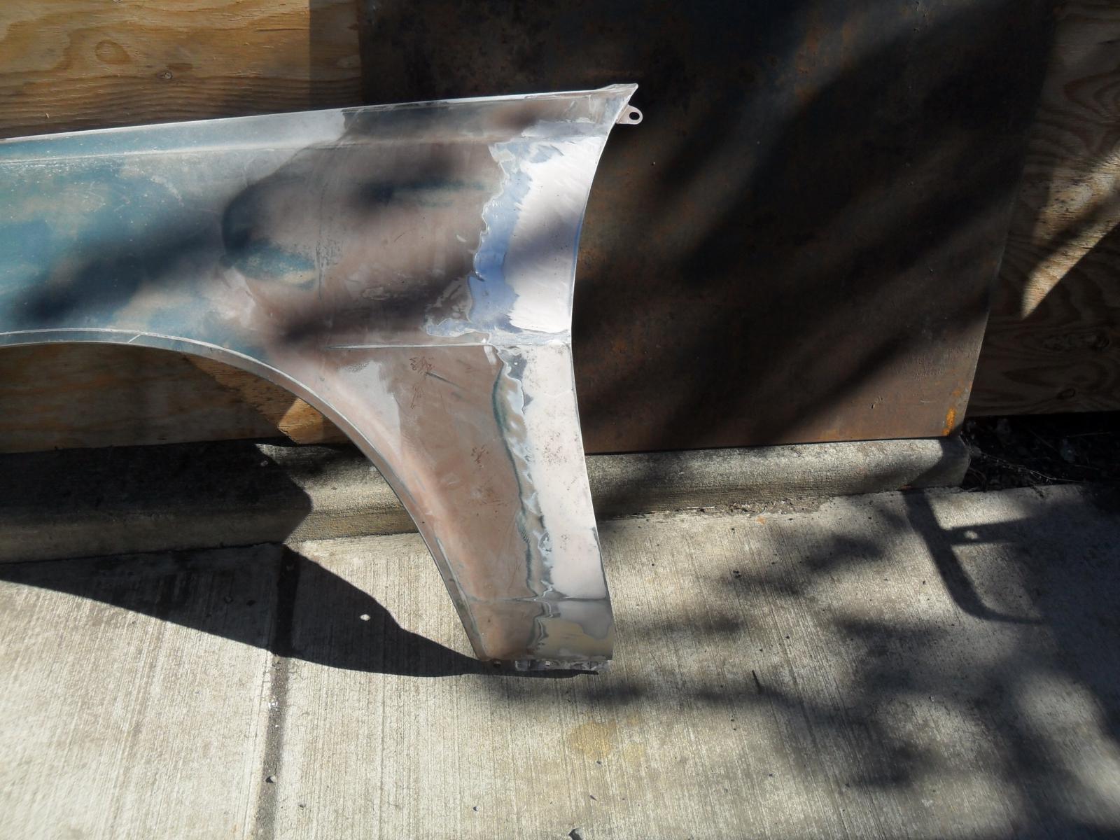

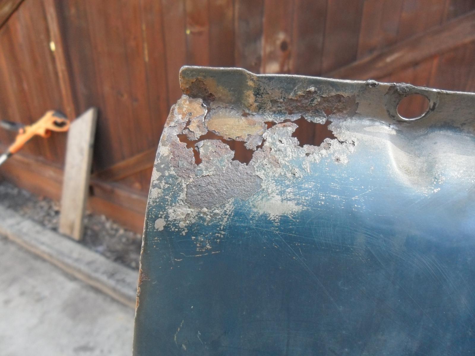

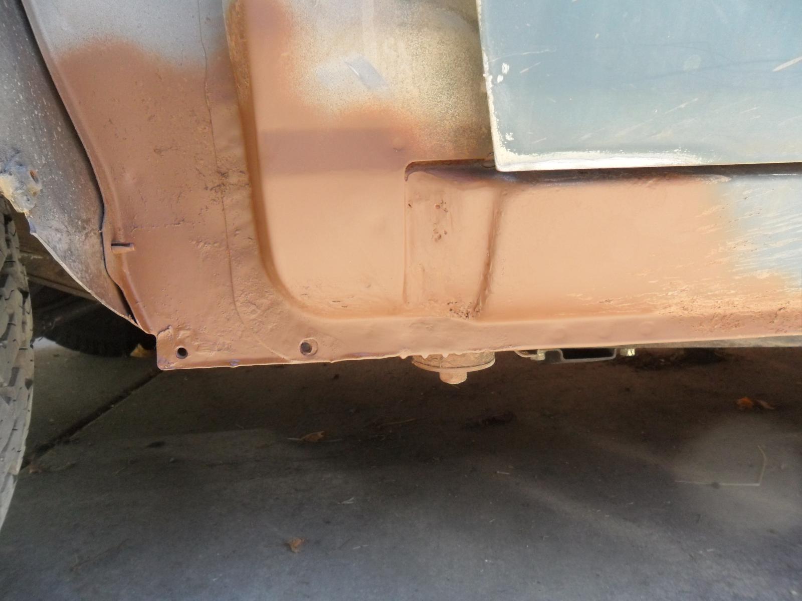

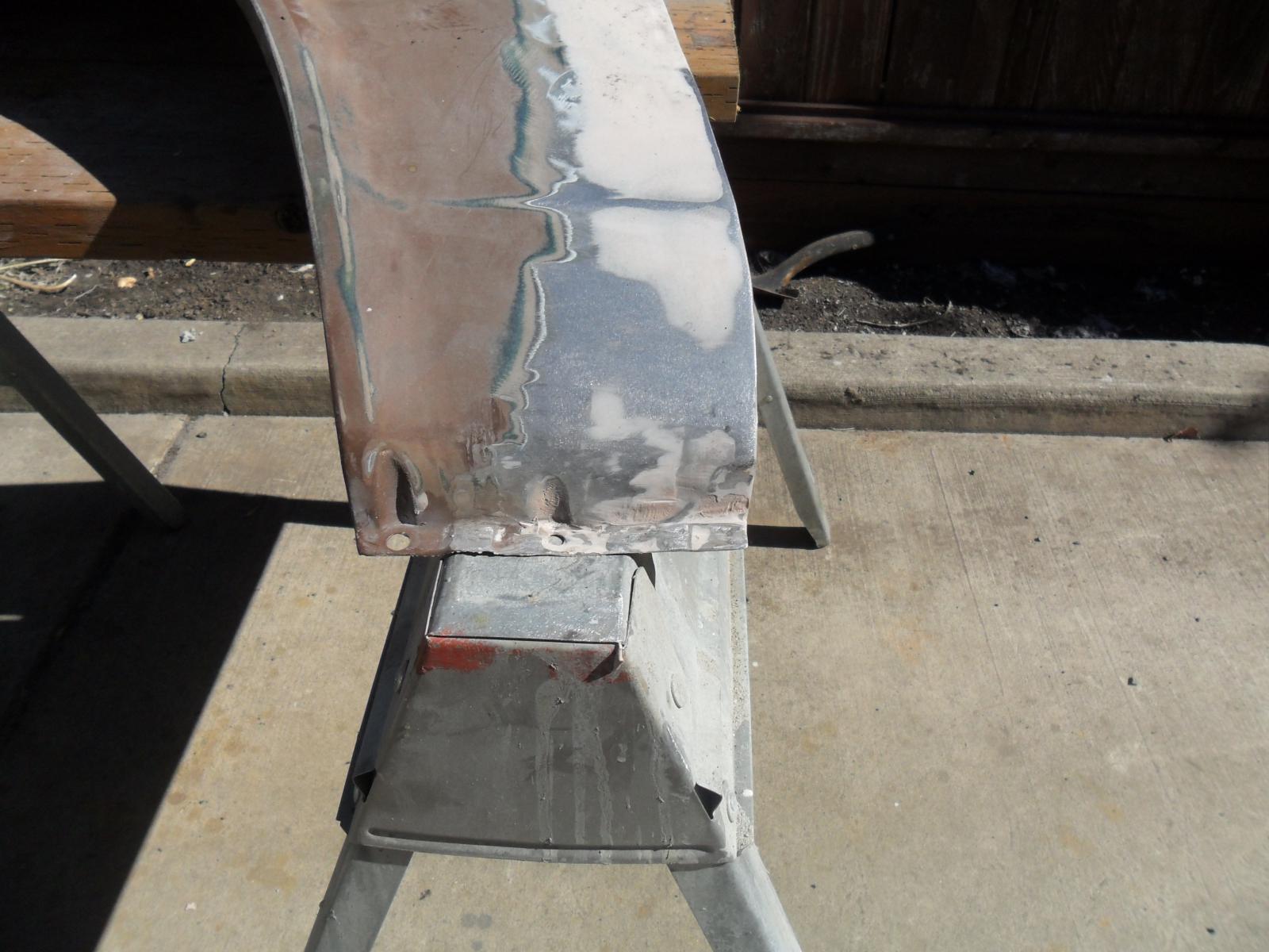

    I was hoping to get the fender finished today since I have the hinges on the way, but the random orbit sander pad gave up the ghost. Here are some pics. Looks like I need another coat of bondo where the rust was.
    I don't have duck bill clamps so I used the Vice Grip to pinch the seam which left marks so I had to bondo along the edge. The black stuff is from the sander pad breaking down before it broke.
    The spot where the rocker was rusted proved to be 2 holes once I used the wire wheel on it so I used the supplied expanded metal with adhesive backing and some bondo and did my best to smooth it with the 4 inch grinder I have and sprayed it with rustoleum. Those holes are in the bondo not the metal. I couldn't get it smooth with the tools I have. Maybe when the new pad arrives I'll try to get at it with the Random orbit sander.

    Looks like excellent work, getting good results!!
    Just fer kicks, (once the hinges get there) you might put the fender back up and see what the clearance is...better sure-footed safe than sorry.
